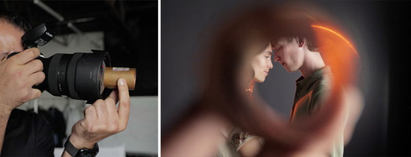

You’ve likely already heard of the “Ring of Fire” photography technique. This is a visual trick popularized by famous wedding and portrait photographer, Sam Hurd. The Ring of Fire is created by using a piece of copper tubing to reflect light coming into the camera.
It’s a simple trick that can completely transform your portraits and in this video, I’ll be walking through how you can create your own “Ring of Fire.” Let’s start with what you’ll need:
1. Bronze tube. You can get one at a local hardware store. I prefer 2″ long and 1-1.5″ in diameter.

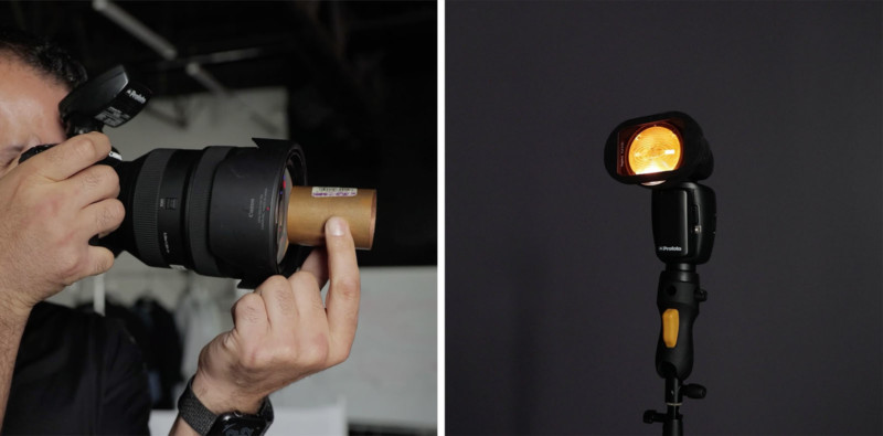

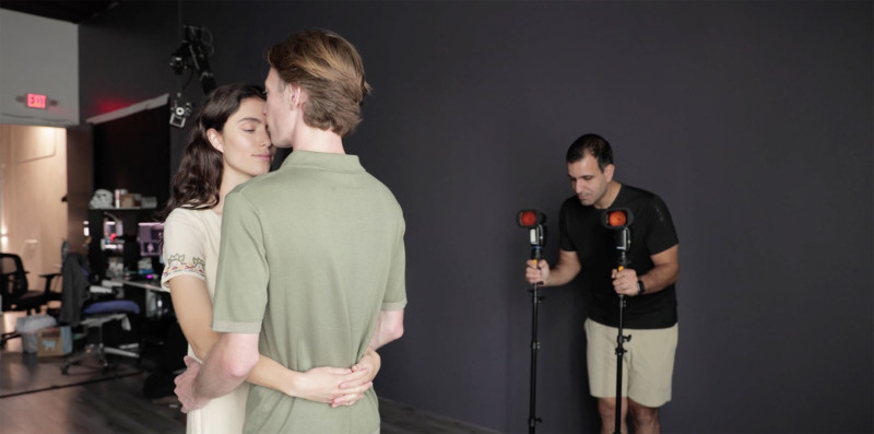

I used two Profoto A10 flashes and MagMod CTO Gels to add warmth to the lights. Keeping the height of the lights below shoulder-level, I placed each light behind each person. Then, I aimed each light inward to cross to the opposite person.

Hold the bronze tube right in front of your lens. Then, using your flash’s modeling light as a guide, move the tube around to get the right angle. What creates this effect is the light from the flash reflecting off of the inside of the tube. With an extremely shallow depth of field to blur out the tube and your hand, this creates the iconic flare effect.
