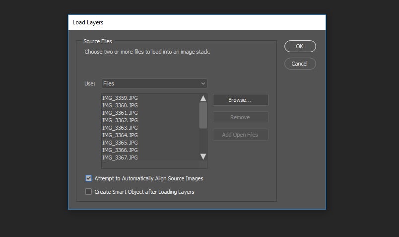

In the next step, we are going to load all the files of our stack as layers into a new document. To do so, go to Files > Scripts > Load Files into Stack.
Add all the images you need in the window that pops up, and tick the option to “Attempt to Automatically Align Layers”. By doing so, PS is going to try and align the layers and correct any shifts in perspective. Generally, this function works amazingly well, though PS might get confused if there is too much movement between frames with handheld stacks.

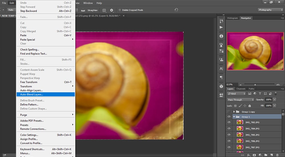

Step #3: Auto-Blend Layers
Deactivate the new group and select the original stack. Go into the “Edit”-menu and select “Auto-Blend Layers…”
In the dialogue box that pops up, select “Stack” and tick both “Seamless tones and Colors” and “Content Aware Fill Transparent Areas,” then press “OK.”

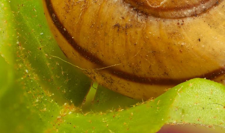

But in case something went wrong, such as in my case, we can fix it with our deactivated back-up group.
A hair in the foreground confused Photoshop and resulted in a blurry area.
