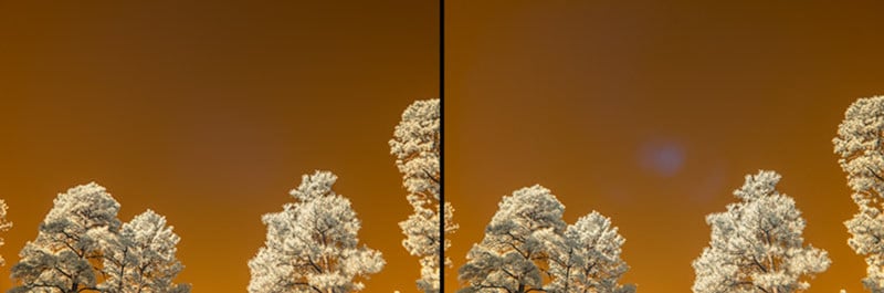

Hot spots are usually bright areas in the middle of the image and tend to get worse and more defined as you stop down. Some lenses don’t exhibit hot spots at all and thus are preferable for infrared. Or hot spots may not appear at wider apertures but show up as you stop down (example below.) With zoom lenses, you may get hot spots at some focal lengths and not others.
This is from my hot-spot test of the Sony FE 24-240mm f/3.5-6.3 lens at the 35mm focal length. The left frame was shot at f/4 and the right frame at f/16. Notice the distinctive bluish spot at f/16.

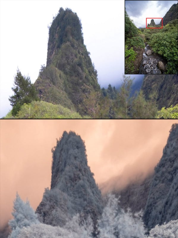

Something else I’ve noticed but isn’t widely reported is the loss of acutance with the same lens compared to its visible-light performance, especially as you go out from the center of the image. Because people use different terminology for resolution or acutance, for ease of explanation, let’s call it apparent sharpness.
It is not always strictly how well the lens resolves that leads to loss of apparent sharpness. It can also be lack of contrast, other optical factors, or a combination of these. For example, a subtle broad and gradual hot spot will cause a loss of apparent sharpness in the central area by reducing contrast there.
Many infrared shooters like the dreamy look of softer edges and don’t seek to have the same apparent sharpness they’d expect with visible light. With the infrared image that I used for my example below, I had good success getting sharpness comparable to visible light using Topaz Sharpen AI. I don’t show the sharpened results here because I want viewers to be able to see the infrared versus visible light difference. However, with such amazing tools available to us, it can now be an artistic choice.
Here is 100% crop (red outline full frame inset), shot with the same Laowa 9mm f/2.8 lens with visible light (upper) and infrared (lower). Notice the difference in detail between them. The drop-off in sharpness is greater as you move away from the center.
