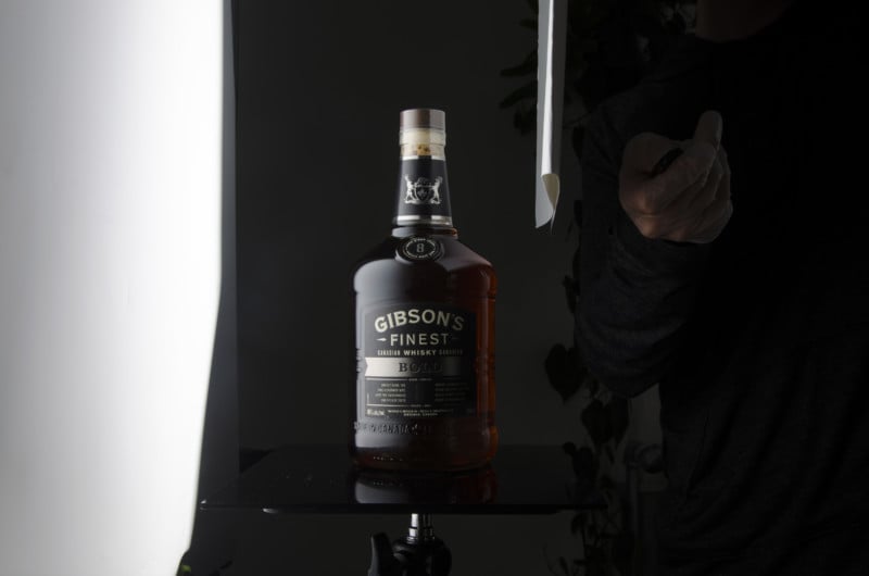

As usual, Dolby is using bare-bones gear. An old Nikon D5100 with the kit lens, a cheap Yongnuo flash trigger, and a single speedlight inside a strip box are all the “core” pieces of gear at his disposal. Other odds and ends include a light stand and piece of acrylic for his reflective surface, some diffusion material, and cheap piece of reflector.

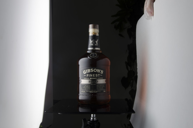

As usual, creating a finished product photo using just one light requires some compositing. There’s no way around it if you want to get that classic product look with various highlights on the bottle and glass.
To that end, Dolby created the hero shot by taking several images with and without reflectors positioned to the right and behind the bottle, and the combined all of the various reflections and highlights into a single bottle-and-glass shot that you see below. Here’s the full set of images, followed by the complete composite at the bottom:
