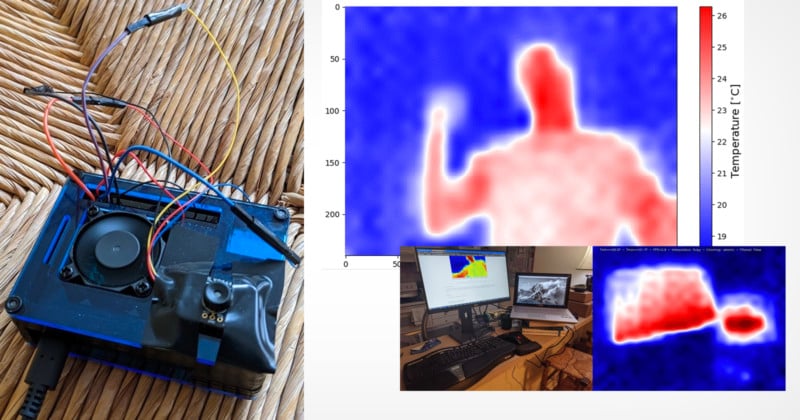

As DIY Photography reports, the build is very affordable. The MLX90640 Thermal Camera from Pimoroni costs just $50 and he attached it to a $35 Raspberry Pi 4, a $10 Raspberry Pi SD card with Raspbian installed, and a $12 power supply, bringing his total investment to just $107.
If you want to get fancier with it and have it function as you walk around, you’ll want to find some way to see the camera’s output live.
“You’ll probably need a portable battery for the device and, if you’re not going to stream the video over your Wifi, you’ll want a screen to attach to the Pi,” Schaffner writes. “I went with the Wifi option so I can’t speak to screens, but I’d imagine any of the many Pi-specific screens would be fine for this.”
