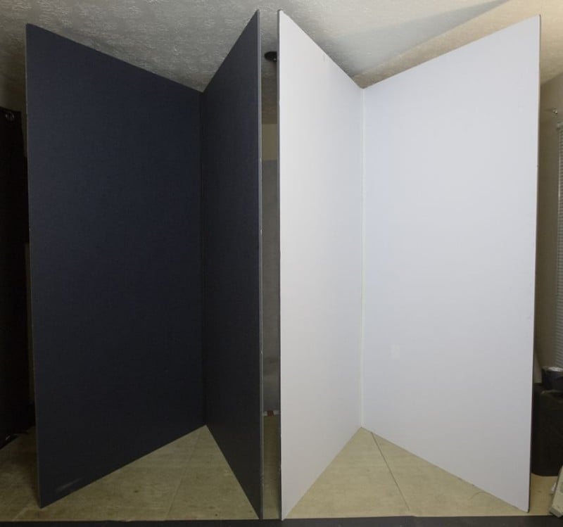

However, the research for theater flats brought something new to my attention: V-flats. I don’t think I had ever heard the term before, so I got intrigued. It turns out that a V-flat is a light modifying tool comprised typically of two large foam boards, either black or white, used to cut/flag light, or reflect it. They can also be used as a backdrop or even flooring.
As I researched how to make your own V-flats, I found several useful articles (see this and this) that all agreed that they are really simple to make and cheap. Well, isn’t that something! The most common material for them is foamboard, but many also use insulation boards that they then paint. I came across this video that describes a really simple way to build a V-flat or backdrop for photography:

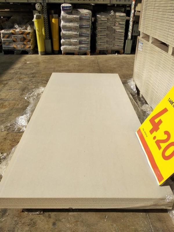

After considering thin MDF boards and drywall, I finally found a cheap, light and easy to use material: insulation boards made of polystyrene. The ones I found were 2.5m tall and 60cm wide. I needed to be able to fit at least five people in the room I was going to build, so I decided to make it 1.8mx1.2m. I only needed seven of those boards to build it that big. Their height was just right for my garage and I could easily cut them in case they wouldn’t fit.

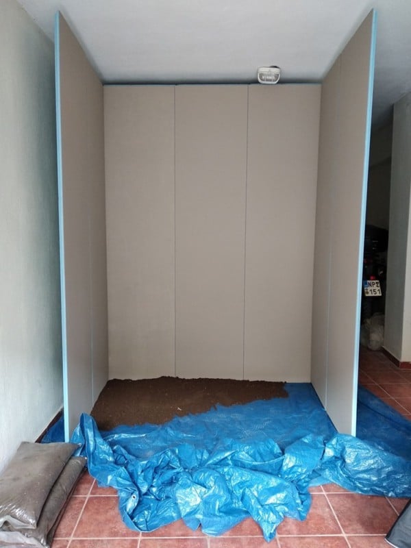

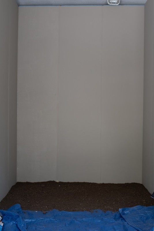

After I gathered my materials, it was showtime. I bought about a liter of paint and applied two coats on each one. I only needed to paint one side for my project, but if you’re building a V-flat, you can just as easily paint both sides. Painting on them was rather easy and once they dried, they looked really good! Their original color is light blue and I used a light brown paint on them which did a very good job in covering the original color.

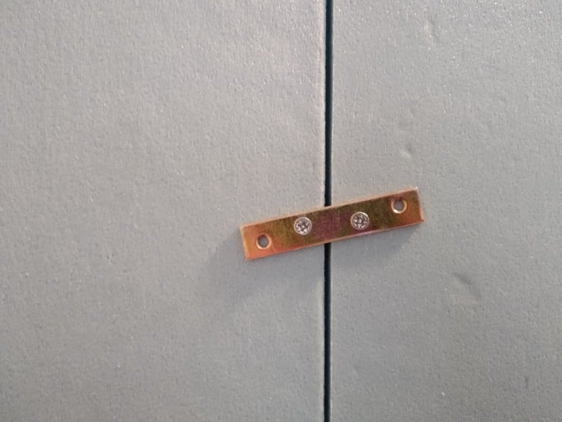

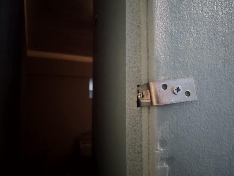

As I said the boards were made to fit into one another, but of course that wasn’t enough to hold them together. I bought some mending plates and I used them to fix the boards together with screws. In practice though, that did not work well because this type of material can’t really hold the screws and they came right off. So out came the glue gun.
I glued their sides and pressed them together for a bit. Then I put the mending plates again, this time also using glue. That seemed to work. The toughest part was holding the wall while simultaneously trying to put it in place. It would have been easier if someone else could hold the wall.
Very quickly the main structure of the room was ready. It was very light so I had no problem moving it around on my own. I was careful though because it is very easy to break. The next step was to conceal the points of contact between the boards as well as I could. What I did was tape over them and then paint over the tape. That seemed to work ok, although I still had to do some cloning later in Photoshop.
The final step for my construction was the floor. I could have used the same type of boards, or fabric or even real flooring. For my project, I decided to use dirt, which served as a symbol of the project’s general concept. I first laid a large piece of tarp on the floor to avoid making a mess and then I poured about five or six bags of pure organic dirt on it. The organic thing is not necessary of course — I just liked its color and texture.

The final room.
That was it! I had made the windowless room I was looking for! Its walls were not very sturdy but that was okay for my purposes. I was able to put pins on it very easily to get the look I wanted for the project’s first image. I suppose getting the same effect on a wooden wall would require much gluing. I was also able to stick mirror shards and an adhesive chalkboard on it for some of the other images.
All in all, this structure served my purposes very well. I was able to shoot all of the project’s nine images in it and they came out just as I had imagined. Most of all, it was a challenge that I had to overcome and I am very happy that I did not give up and made it work, learning a lot in the process. I highly recommend trying this if your budget is low and you are not that good with construction work.

The final room.
