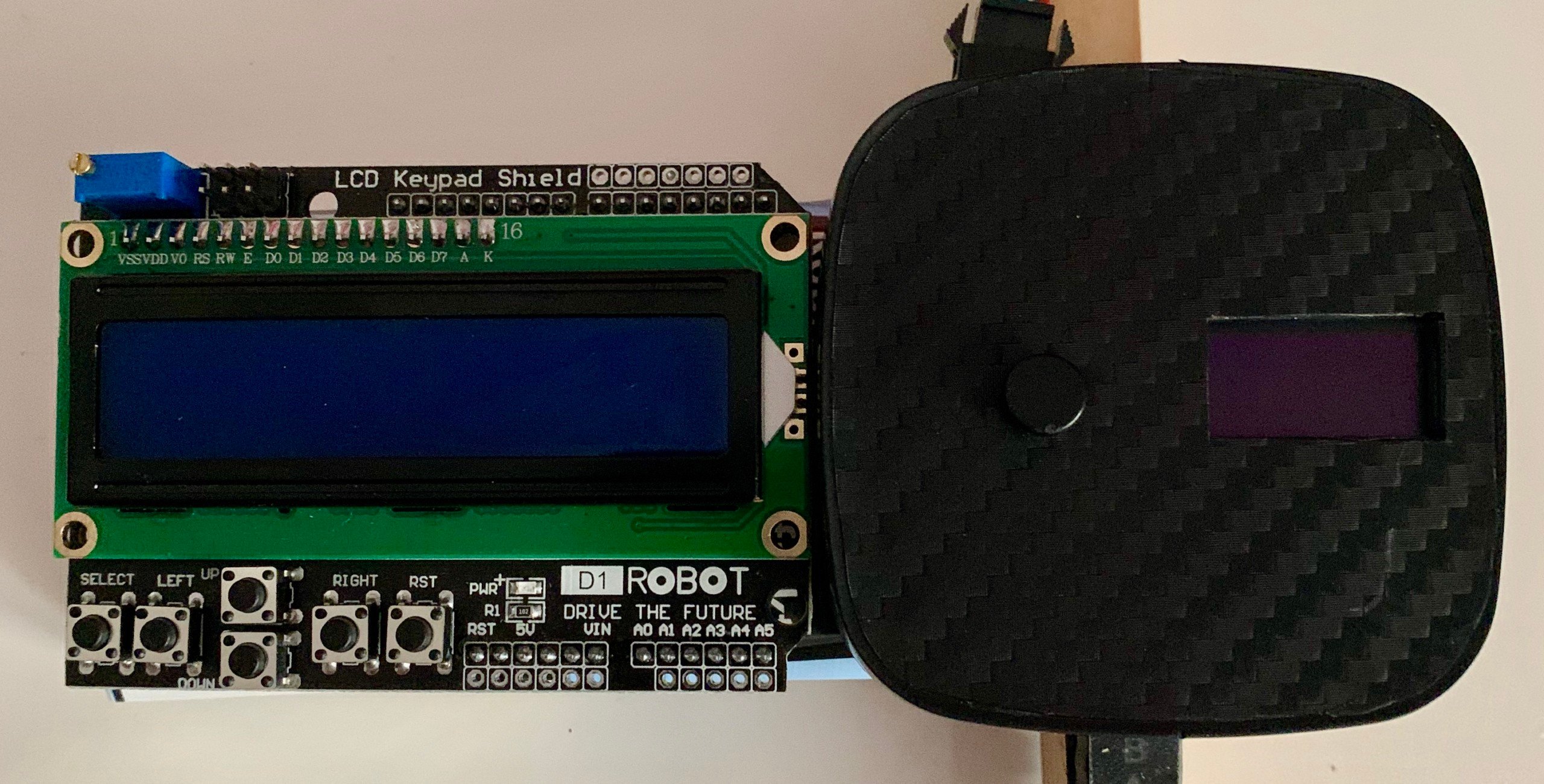

Luckily, Michael Ross already built something like this and it has some of the features, that I want. Software wise it runs an Arduino sketch. Hardware wise I think it is a bit dated and way too big. I’m not a fan of the large Arduino MEGA and the LCD Display shield as it makes the device unnecessarily large, so I decided to swap some parts.
The LCD display alone is already bigger than my complete controller
I chose an Arduino MEGA 2560 Pro, a small OLED Display, a Micro-SD reader, and a digital joystick since the display does not come with buttons.

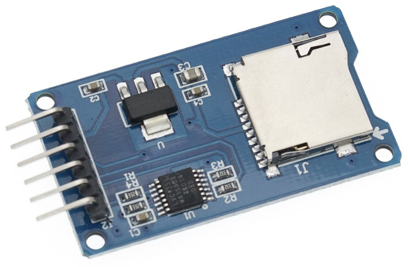

  • Micro SD card mini TF card reader module SPI interfaces

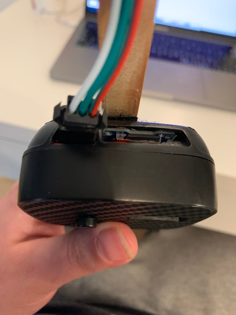

You also need a Micro USB cable, some wire, a soldering iron, solder, electrical tape and something on which to mount the LED strip. I chose a piece of wood. For the case I used an old bluetooth receiver that I have no use of anymore. To program your Arduino you need the Arduino IDE.

The SD card reader needs some more ports, but all are grouped together. 50, 51, 52, 53

Soldering and building the case only took a few hours, a Saturday well spent.

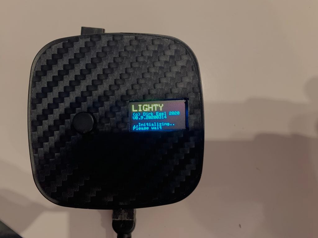

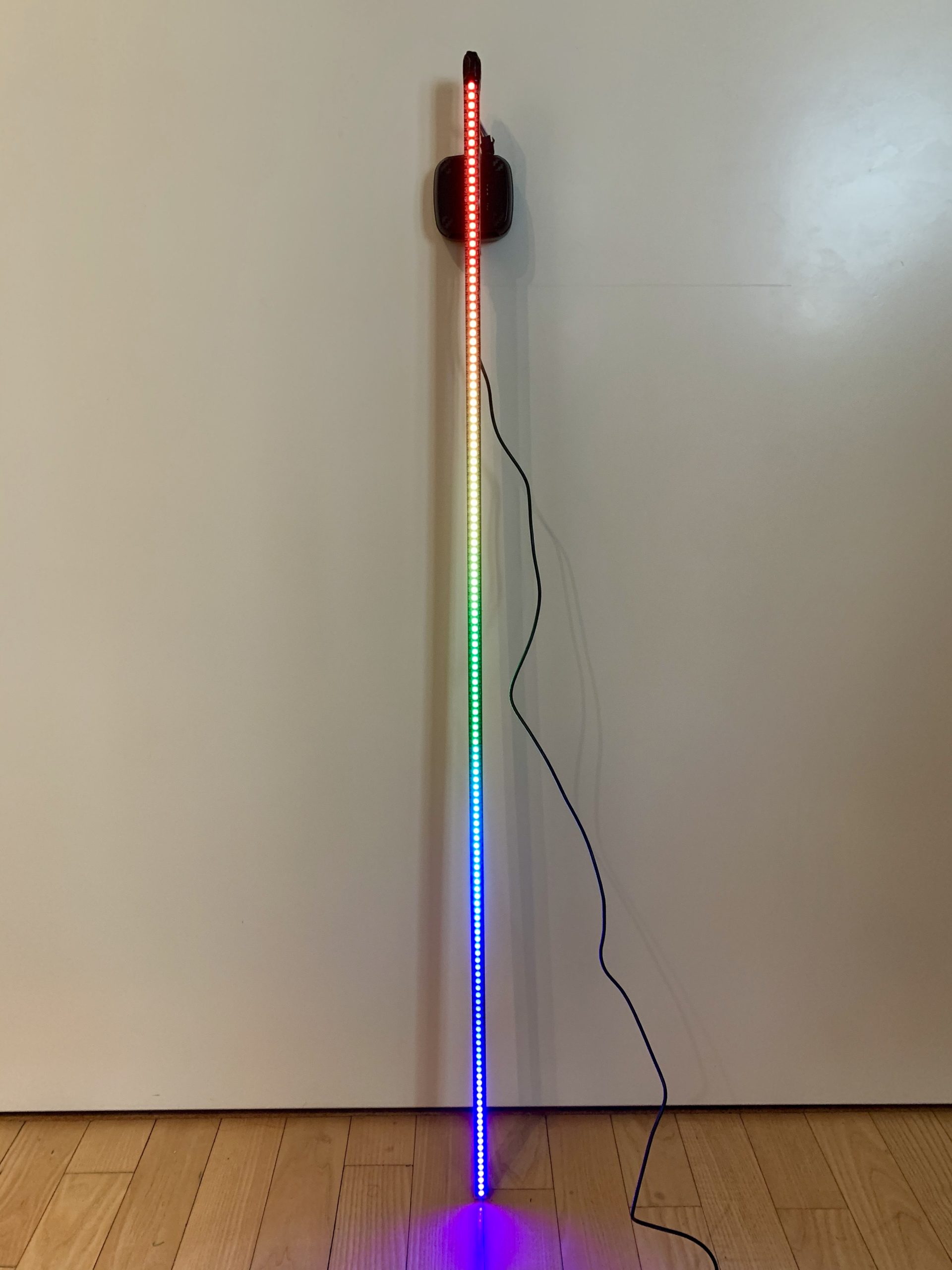

I took the sketch from Michael and removed the libraries for the LCD Shield, which also handles button presses, rewrote the function that watches for keys and rewrote the parts that would display text on the display. I also implemented EEPROM saving of the brightness setting, all the other values are fine from the start and seldom need tweaking.
Thanks to the great Arduino community, figuring out how to address the different modules was easy enough for me, even not being a very seasoned programmer. There is for sure room for improvement, but at the moment it does what I need and I can always come back to the code in case I need a new feature or find a bug.

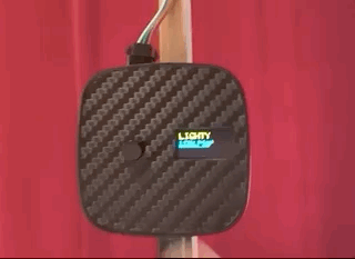

Here some more pictures of ‘lighty’ and, of course, some results. Oh by the way, ‘lighty’ weighs only 240 grams (without battery).
I am really happy with how this turned out. The only thing missing is a diffusion panel in front of the LEDs, but even the “8-bit” look is fine with me for now… especially at this price tag.
