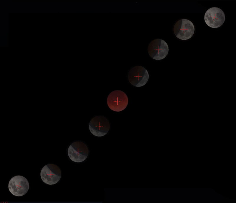

I didn’t have the luxury of deciding the composition in post, so I used Stellarium (free planetarium software) to plan out the shot. It allows you to input your sensor size (or film size in this case) as well as your focal length to preview what your field of view will look like. I decided to shoot this photo with a medium format camera since the size of the moon in the frame is relatively small and grain could limit the size of prints. Medium format slides are also just incredibly satisfying to look at on a light table.
I used screenshots to generate this composite plan in Photoshop based on a 600mm lens that I have.

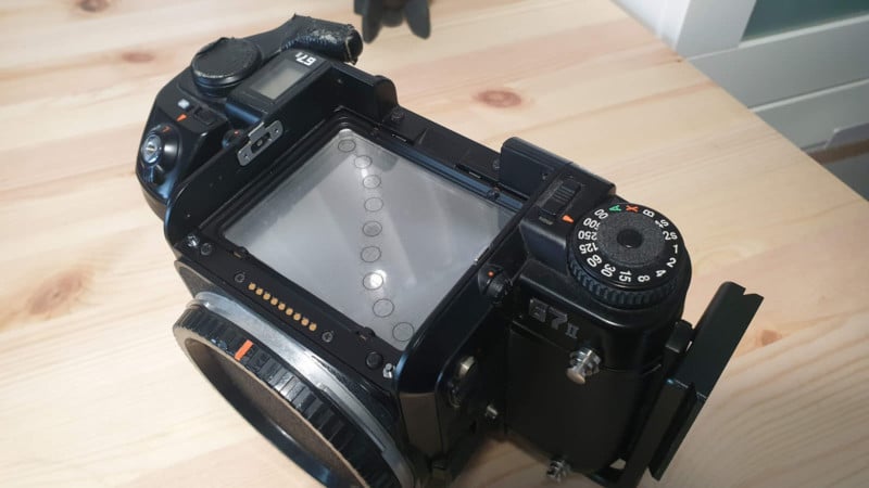

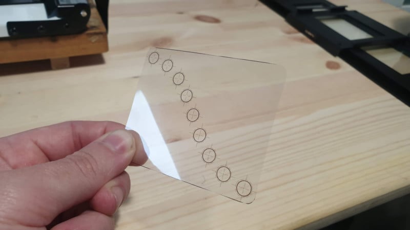

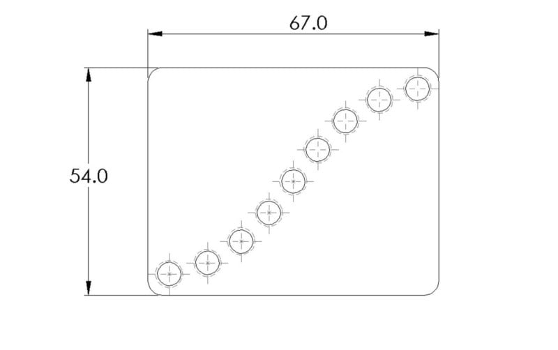

I used a Pentax 67II for this shot and if it had grid lines on the focus screen I could have possibly estimated each shot position. Instead, I came up with a simple way to make custom frame lines using inkjet transparency sheets. Using my Photoshop plan as reference, I sketched up a template using SolidWorks — it’s engineering CAD software, but I only used it because I work with it for my day job. Adobe Illustrator probably would make more sense to use instead! The end result was this template, scaled accurately to the size of the ground glass and predicted moon diameter in the field of view.
The next step was to print it out on paper to make sure it fit correctly on the focusing screen. Finally, after that, I printed out the template on inkjet transparency film with a regular home printer and cut it to size.

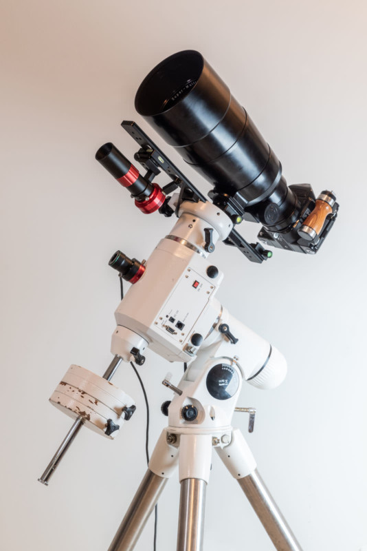

I had everything planned out, the times I would shoot each phase I wanted and the exposures I would need. I mounted my Pentax 67ii with the Takumar 600mm f/4 on a SkyWatcher NEQ6 equatorial mount. For short moon exposures at this focal length, you can get away without an equatorial mount especially with higher ISOs. However, totality can require exposures of a few seconds at the 100-speed film I was using so I wanted to make sure my shot was as sharp as possible.

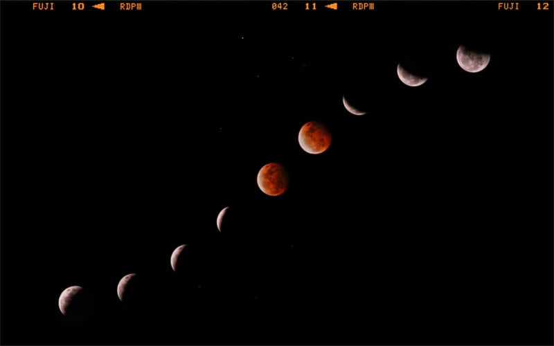

Instead of a sequence going from full moon to full moon, I decided to go for a sequence from partial eclipses before and after totality. This time all 9 multiple exposures worked successfully and I had my shot!
Result
As always with film, you’re forced to accept some delayed gratification — or mild stress about whether your shot worked or not. The next day I developed the film in E6 chemistry. I use a sous vide machine to regulate the temperature and it works a treat. I was thrilled that everything went perfectly to plan; well the new plan but I think I like it better than the initial one.
