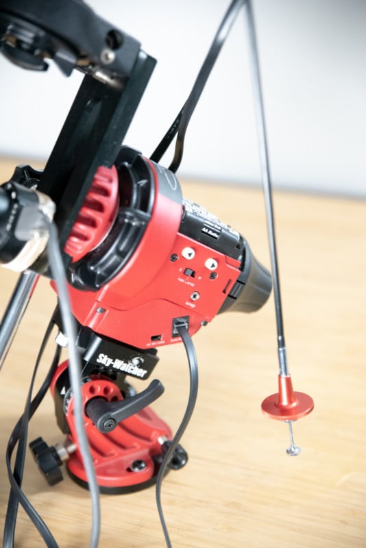

With a wide lens and a digital camera, all you need is a tripod to take these photos. With film and these very long exposures, the Earth’s rotation is a big problem — you’ll end up with star trails (which is a fun type of photo to take). The solution to this problem is a star tracker, a mount that precisely rotates your camera at the same rate as the Earth (known as sidereal rate). I use the Sky-Watcher Star Adventurer Pro.
The Sky-Watcher Star Adventurer Pro

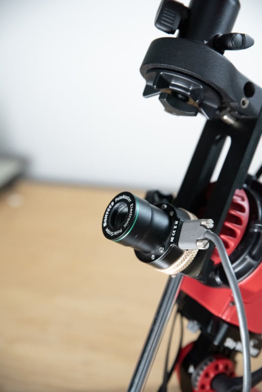

The first step to getting accurate tracking is polar alignment — the axis of the tracker needs be precisely aligned with the Earth’s axis of rotation by pointing it precisely at the North Celestial Pole or South Celestial Pole. The more accurately you can align the tracker, the longer you can expose before seeing star trails. I use a piece of equipment called a QHYCCD PoleMaster to help me get this very accurate. It’s a little camera with dedicated software to monitor stars near the pole and tell you how to adjust your mount to align it.
The QHYCCD PoleMaster

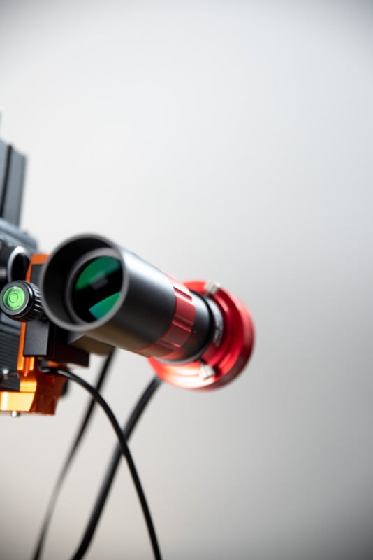

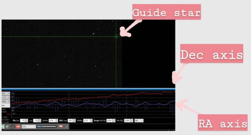

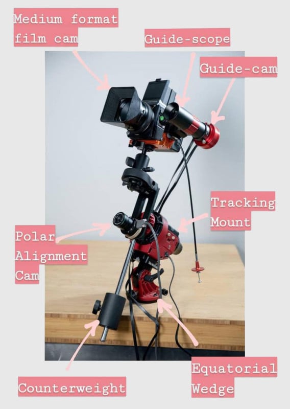

When shooting on medium format cameras, the fastest lenses are typically f/2.8 or f/3.5, so you’ll be tracking exposures of greater than an hour. This is beyond the normal scope of a tracker like the Star Adventurer but there’s a way to increase its performance even more. It’s a feature called guiding, which is yet another camera with a scope (this time aligned with your imaging camera). It looks at the stars near your imaging target and monitors the error in your tracking, it then sends pulses to the tracker to correct these errors. I use a ZWO 30mm/f4 guide scope with an ASI120MC-S camera and PHD2 guiding software.
The guide scope and camera.

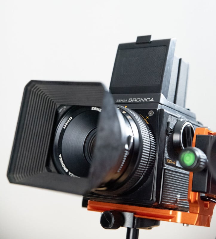

My camera is a Bronica SQ-A with a Zenzanon 80mm f/2.8 lens.

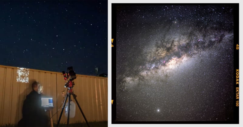

Here are two timelapse video of my rig in action (the first one is in my backyard):
