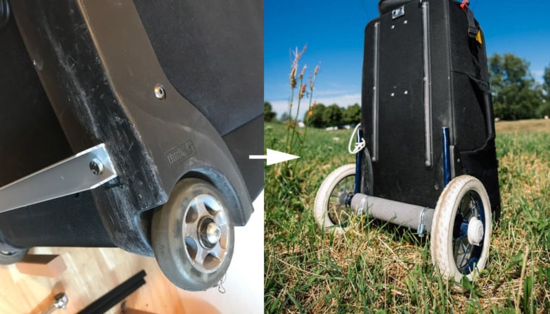

Step 5. Drill Holes in Your Case
I chose to put the holes near the edge of the bag, where it is reinforced by a large plastic part that contains the original wheels. The bag itself is a lot of corrugated plastic, so look for a location that’s the most sturdy place on the bag.
I’m going to reinforce this hole location in the future inside if I notice that it bears too much stress. It might be enough to include a larger aluminum plate.
Step 6. Screw On the U Channel
The choice of the size of the profile was based on the diameter of the wheel axle plus some air to easily insulate it with a plastic cover. One on each edge plus one on the actual wheel axis made everything fit quite perfectly.
originalhjul-thinktank-logistics-manager-30-fotoutrustning-aluminium-u-profil-800x600.jpg
Step 7. Hold the Wheel Shaft with Pipe Insulation
The wheels spin on the axle, so the axel itself can be stationary on the rolling bag. In order to easily tighten the axle and the rest of the parts, I bought pipe insulation that can easily be cut to the right size. Then I put it on top of the aluminum U channel and fixed everything with pipe clamps. The insulation provides shock absorption for the bag as it’s being wheeled around.

Step 8. Here’s the Finished Product!
DIY-Logistics-Manager-30-DIY-stora-hjul-rullvaska_2018-Stefan-Tell_avtagbara-barnvagnshjul-terrang-grus-gras-natur-fotoutrustning-800x534.jpg
DIY-Logistics-Manager-30-DIY-stora-hjul-rullvaska_2018-Stefan-Tell_utomhus-fotograf-rullar-enklare-grus-gras-ang-800x534.jpg
DIY-Logistics-Manager-30-DIY-stora-hjul-rullvaska_barnvagnshjul-byta-projekt_2018-Stefan-Tell_001-534x800.jpg
