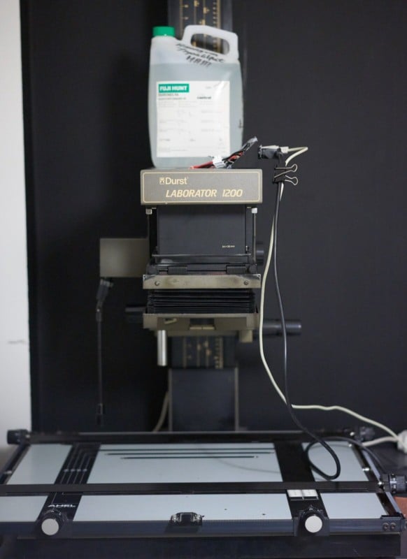

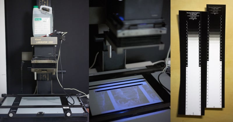

I’ll start by posting the where we ended up in the end:
Yes, that’s a filled 5L bottle on top of the enlarger. The color head that we’ve removed weighs even more than that and until the laser-cut-form-fitting-counter-weight arrives, that bottle will have to act as dead weight to prevent the head from breaking free of its locked position and launch into the orbit.

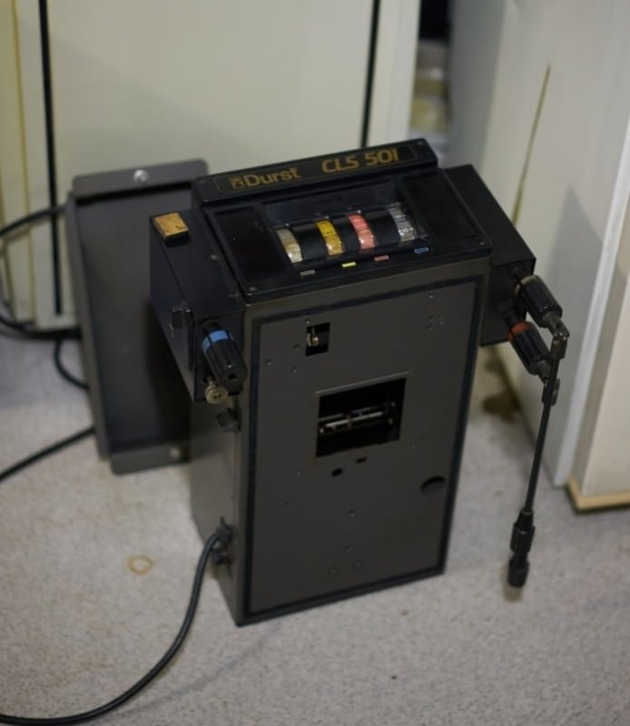

Here’s the old CLS 501 color head:

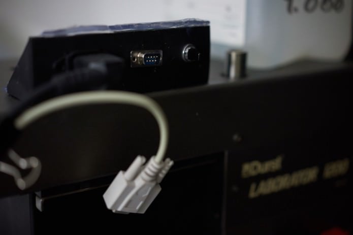

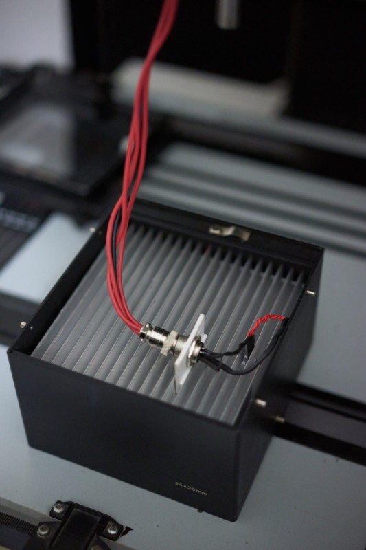

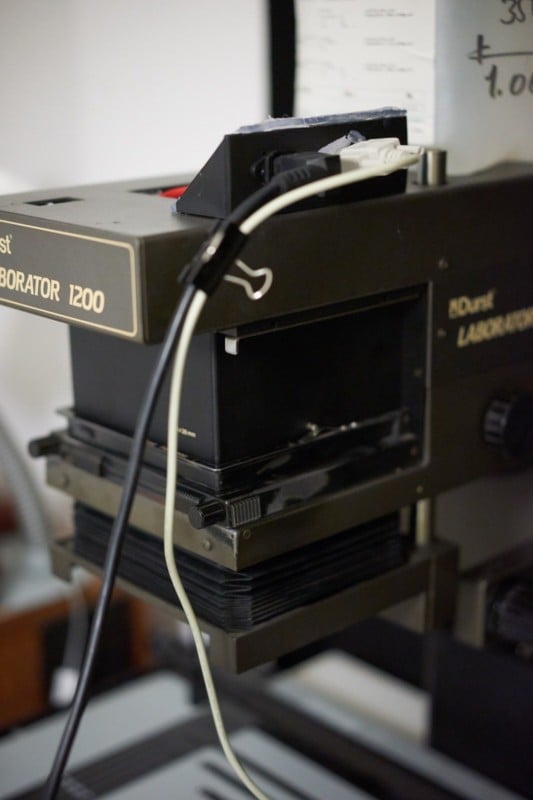

All the drivers for the LEDs, power supply for the control unit and relays are inside the remaining chassis, tucked away behind the faceplate. We 3D printed a bracket (in the wrong orientation so the power switch is away from us while the power cable is near, measure twice print once everyone) and placed it temporarily on top of the head.
Since then, we’ve reprinted the bracket and everything looks better now (with much less hot glue everywhere) but haven’t taken photos of that yet, so this will have to do. We went for the DSub 9 socket so we have enough pins for communication and other features.

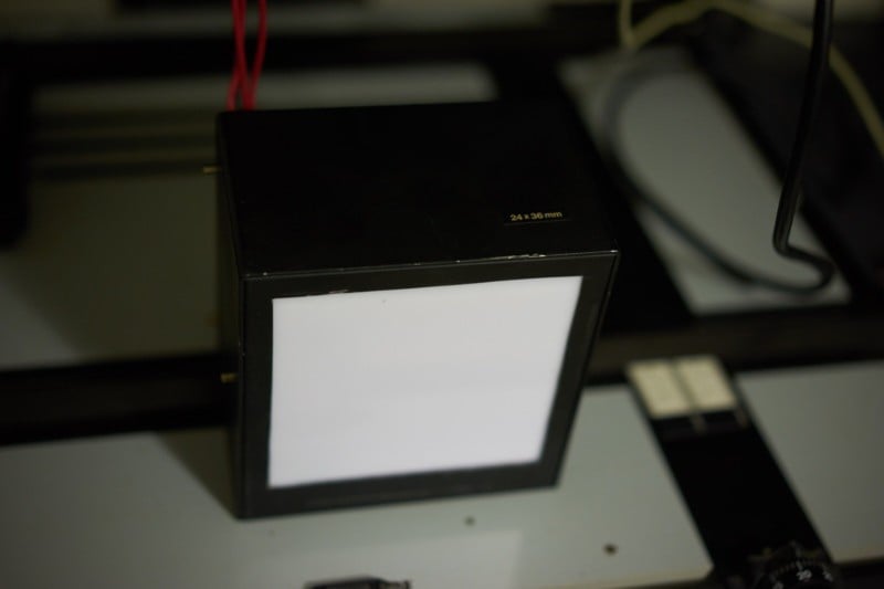

The black rectangular box underneath the faceplate is the diffuser box and some of you may have spotted that it says 24×36 mm on it. That’s because this enlarger (that my friend had rescued from being scrapped) came with a 35 mm diffuser only. All that bulk and weight for that?
Much better now. If you think that this diffuser is larger than 35 mm, that’s because we took a Dremel and cut out most of the bottom section. The newly inserted opaque white acrylic sheet is large enough to cover a 4×5 negative in either direction now.

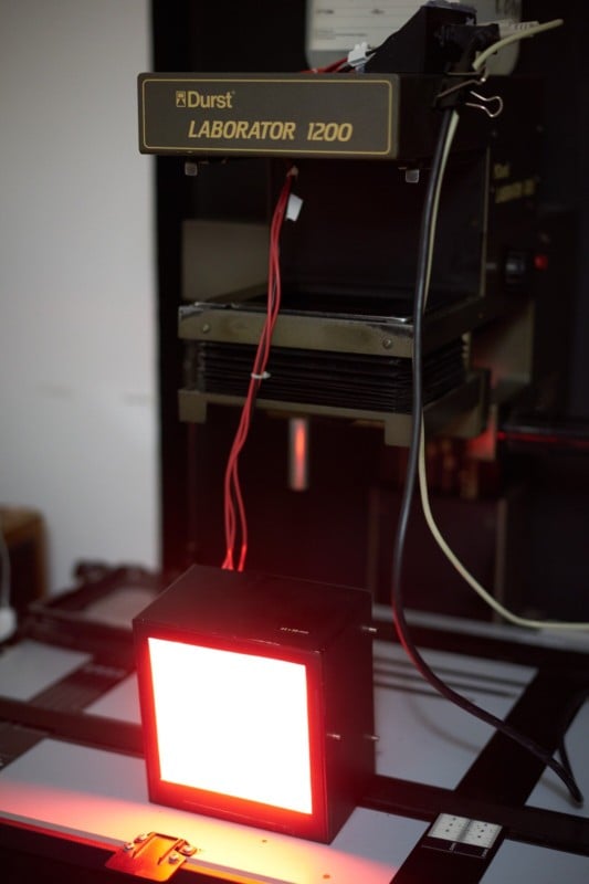

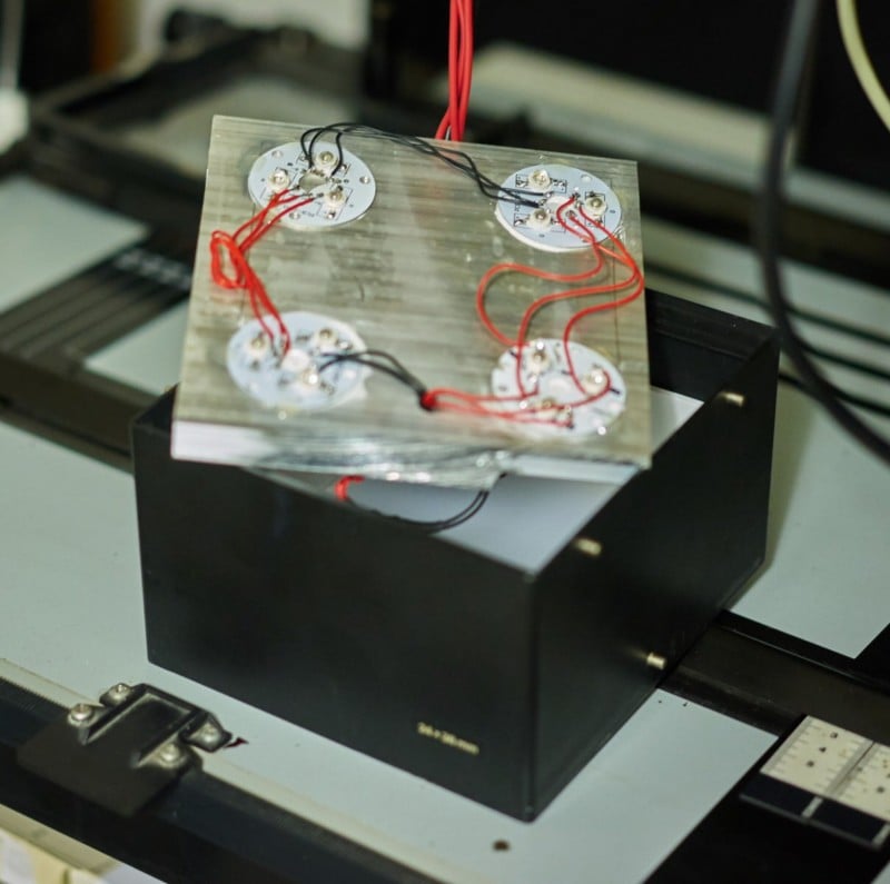

Four clusters of LEDs. Following the suggestion of our dear friend Alexander Kharlamov (who has already built 6 of these conversions so far), we went for Red, Green and Purple LEDs, placed in the corners. According to some computer simulations, this layout gave us the best and most even illumination. The ones closest to the center are the red LEDs since even illumination is not a major concern with them. They are there just to act as a safelight, essential when placing some paper underneath the enlarger. That’s right, we won’t have to use a red safety filter under the lens anymore (we did test them with some paper and they turned out quite safe to use).

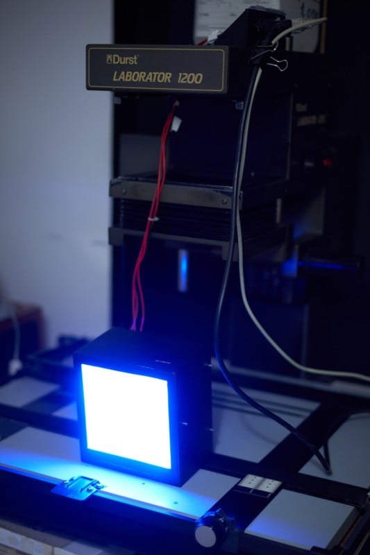

Here’s how the diffuser looks like with the red LEDs on. We also covered the inside of the box with some white reflective material and used two layers of opaque white acrylic at the bottom with a 1cm spacer between them. In the end, the lighting seems quite even, even for the red.

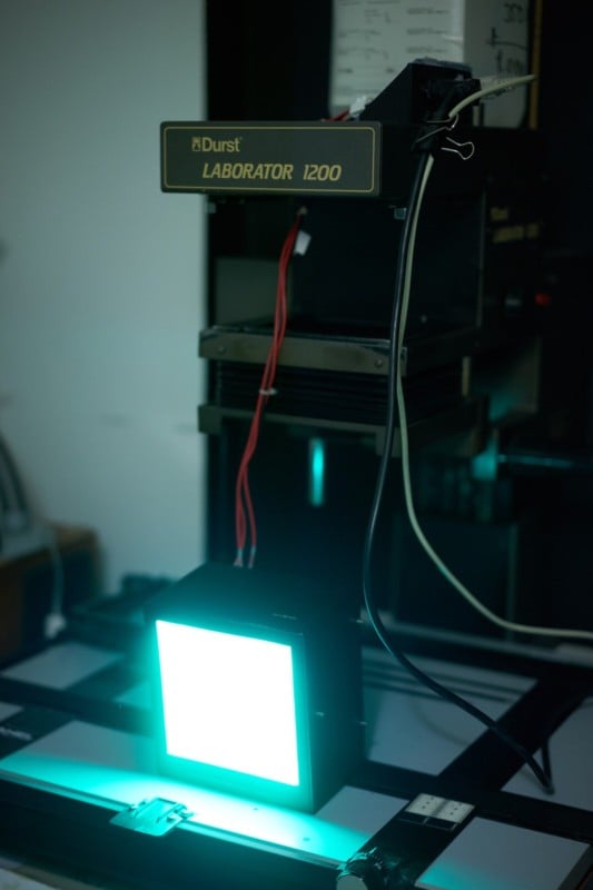

The green LEDs are closer to the corners (one in each) and are used for low contrast printing. They are more or less equal to an Ilford #00 filter and only activate the low contrast emulsion of the paper.

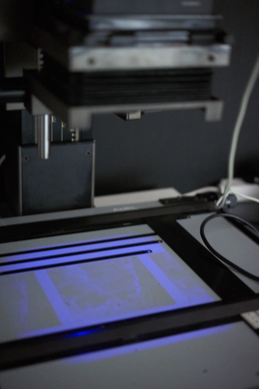

Here are the purple LEDs in action. These are also placed close to the corners (each cluster you saw above has RG and P LEDs, one of each). Some guides on the web suggest that Royal Blue LEDs would’ve been enough to activate the high contrast emulsion only but after digging through some datasheets (and also once again according to Alexander), the peak wavelength needs to be under 420nm to activate the high contrast emulsions of most papers and Royal Blue peaks at 440nm. These are 410nm near-UV LEDs. We also used a 1W driver for four of these while the two colors have 3W drivers of their own. This is because you don’t need as much light to activate the much more sensitive high contrast emulsions.

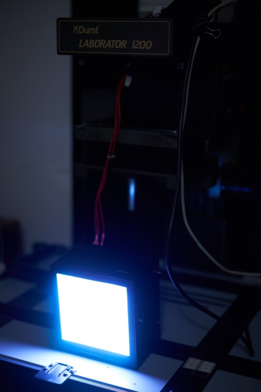

Here’s all of them on at the same time. Looks a bit bluish due to the white balance but it’s much closer to white in real life.
There’s a huge heatsink directly behind the LEDs. We used thermal paste and a drop of epoxy to attach the RGP clusters that are built into circular and aluminium PCBs. If we’re not happy with the light distribution, we’ll look more carefully into the arrangement and the number of the LEDs but this should be a good starting point.

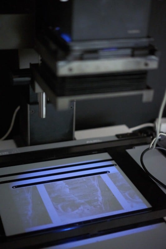

We did not have a 4×5 negative at the point so this is a 6×6 negative. It is bright enough to be seen even with the room lights on.
The purple LEDs can be a bit hard on the eyes so while I took this shot with them, we actually turn the red LEDs on at the same time, resulting in a much more pleasing magenta illumination.

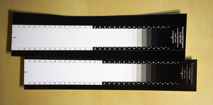

One of these is made with an Ilford #5 filter while the other is made with the LEDs. Can you tell which is which?
One of the first prints we’ve done.
