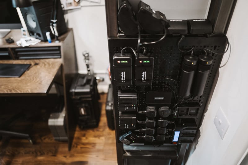

The base of it needed to be big and robust, and since weight wasn’t an issue I bought a Vonhaus Steel Pegboard on Amazon. It came as a set of three, so I shipped the other two off to friends rather than chuck them away—sharing is caring, after all.

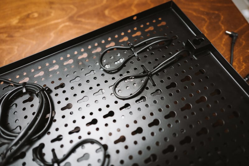

I knew I would have to use longer cable ties, and after some measuring I bought 300mm ties to make sure they’d go around the wider chargers. I also ordered an 8-gang extension with USB ports and an on/off switch (this enables you to turn the whole thing off at the board rather than the mains, which is way more convenient).
To make the best use of the space on the board, I ordered a mix of short IEC C7 cables (0.5m)—some with straight ends and some with right angles. This allowed me to get the chargers closer to the power block.

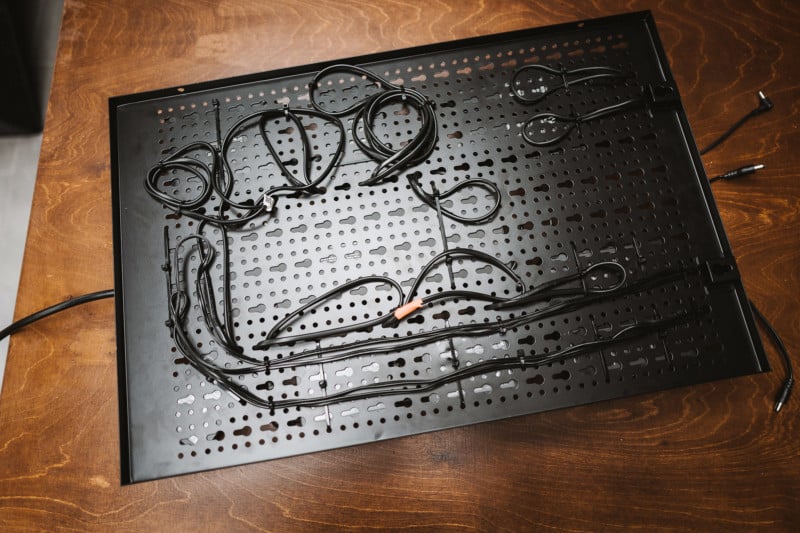

After those had arrived, it was a simple case of laying everything flat and figuring out the best way of organizing the board. I knew I wanted to hang this up on the end of a shelving unit to take up the smallest area possible (and an area that wasn’t being used). Hanging it like this also meant I could use the shelves to hold the larger Profoto batteries when they were charging.
After laying it all out I started threading through the ties and securing the chargers. When you do them tight enough most blocks only need one tie—the larger Profoto chargers did need two to stop them from twisting.
To tidy up the board, I pushed the excess power cable through the holes on the board and zipped them using smaller ties to tighten up the extra.

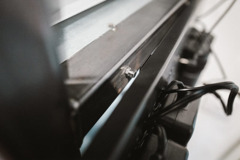

And voila: a couple of hanging screws and there it was, a charger board that could be switched on and off, taking up space that I never used and getting this nest of snakes under control finally!

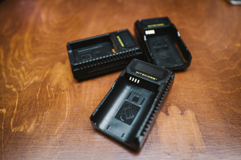

To the people who are asking how I travel with this, I don’t. It’s too big and too much of a faff, so I use a bunch of USB chargers from Nitecore for all my cameras and have separate travel chargers for my Profoto kit.
Travelling this way means I can take the Profoto chargers, the Nitecore bits and an Anker USB C hub rather than all the IEC cables and a massive extension. It does end up being a bit more expensive this way but the weight I save not dragging loads of cables about more than makes up for it. Here are my travelling camera chargers, as you can see they aren’t much bigger than the battery and they are super light.
I’ve used this method for travelling for years as lightweight is the name of the game!
