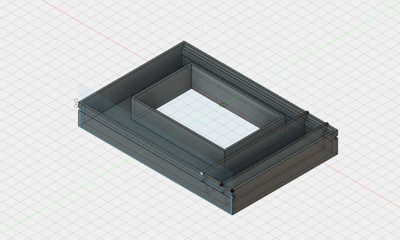

The 3D design in Fusion 360
The 3D design is done in Fusion 360, nothing too complicated as the shape is quite regular. It is a matter of measuring the original spacer and transferring the measurements into the design. One of the things that I nearly missed including is the two raised bars on the right side of the frame. These are used to align the entire frame on the camera back to prevent it from being inserted too much or too little.

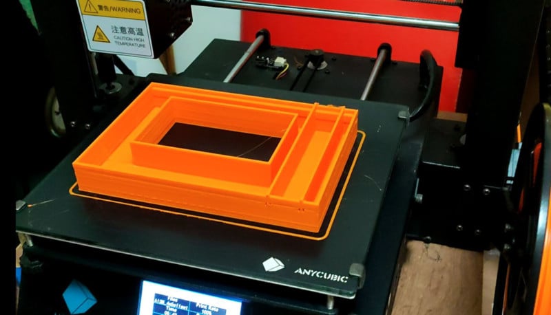

I 3D printed it using my Anycubic Mega S printer with the following specs (for reference):
Printing on my AnyCubic Mega S 3D printer

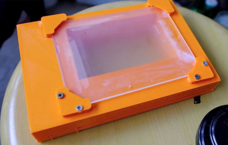

Acrylic ground glass
Instead of making my own ground glass, I opted for a piece of 3mm acrylic that is frosted on one side. I have a piece lying around from my Afghan Box camera builds so I decided to use it. There are also four corners that I used to hold the ground glass in place. The two bottom pieces are glued to the main body using superglue while the other two are secured with screws. This will make it easier to swap ground glass in the future by unscrewing the top two pieces.
- Layer: 0.3mm
- Infill density: 20%
- Extruder temp: 230C
- Support: Everywhere
- Time taken: 5 hours
