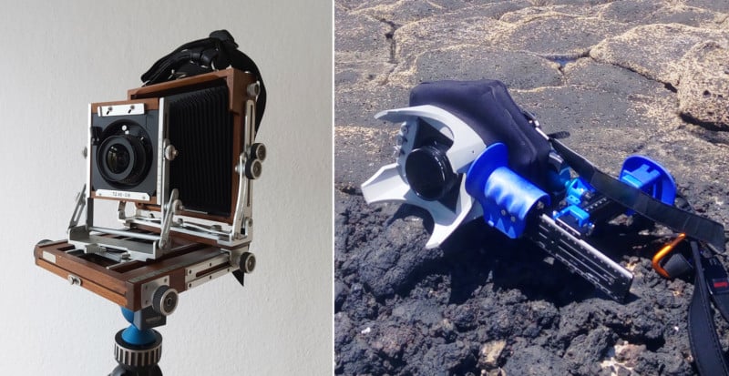

First digital view camera iteration (Mk.I, on Lanzarote rocks) next to modern wooden field camera
The spec was deceptively simple: the camera should be portable, have full movements, use large format lenses for their extremely large image circles and thus sensor coverage, and do so without endlessly fiddly buttons.
Imagine the strange love child of a free lensing setup – a Lensbaby and an LF monorail (but handheld) – and you will understand how the prototype works. The first iteration of the camera is shown in the above image, next to the wooden Shenhao field camera that inspired it. They have radically different appearances but identical possibilities of tilt/shift/swing – if you ignore the difference in film size (LF or roll film vs. full-frame digital) and the “grip it, unlock it, and just tilt it” operation of the first prototype model.
Also, front standard movements were only possible by tilting the entire rig and adjusting the back standard, which in practice is not a limitation. The “Susokukan” and “Wavefront” series, some images of which appear later in this article, were created with this basic first version of the camera.

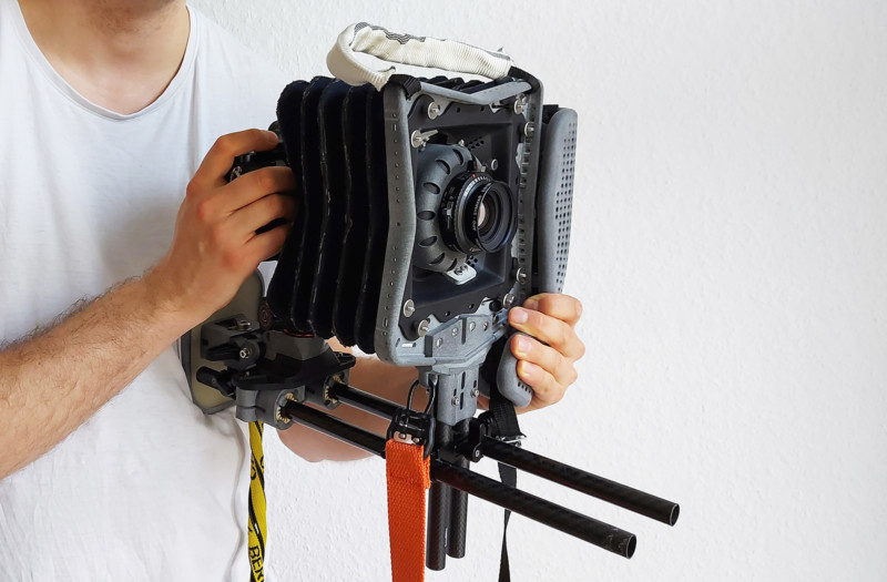

Current digital view camera iteration (Mk. II)
Exploded digital prototype assembly view (Mk.II)
Pictured above is the current camera variant and its digital source data, hand-held as it is supposed to be used and with a Sony A7r mounted. In marked contrast to the first iteration, it’s now a “duo-rail” camera made of (stock) carbon rails, plastic bearings, sintered Nylon, hand-cut glued Neoprene (for the bellows), and some stock aluminum rig parts with a magnet rack focus latch lock mechanism for easier operation. The entire camera now consists of modular assemblies, which gives much greater flexibility in adapting to new experimental setups – and without having to reprint large parts of the camera when some subassembly changes (e.g. when adding new lens mounts).
As LF lenses have no internal helical, it’s rack focusing only, just like LF cameras. The eagle-eyed will notice that there is a different lens mounted in this shot than in the introductory one – that is a Schneider Apo-Symmar 120mm f/5.6, as opposed to the previous Rodenstock Grandagon 75mm f/4.5. These lenses are attached to custom bayonet mount cones, doing away with the standard LF lens boards as still used in Mk. I and allowing space for some custom operable ‘stray light ports’ (the oval openings next to the Copal shutter). Basically, you can mount (and thus perspective control) any lens, with LF lenses from 75mm to 120mm most commonly used by me, but the occasional full-frame (e.g. vintage wide angle shift-only Nikkors) and medium format lenses (e.g. a Zodiak-8 fisheye) thrown in for good measure – as LF superwides are not usable with current digital sensors (rays too oblique!) and flange focal distance limitations (you’ll hit the mount at infinity!).
