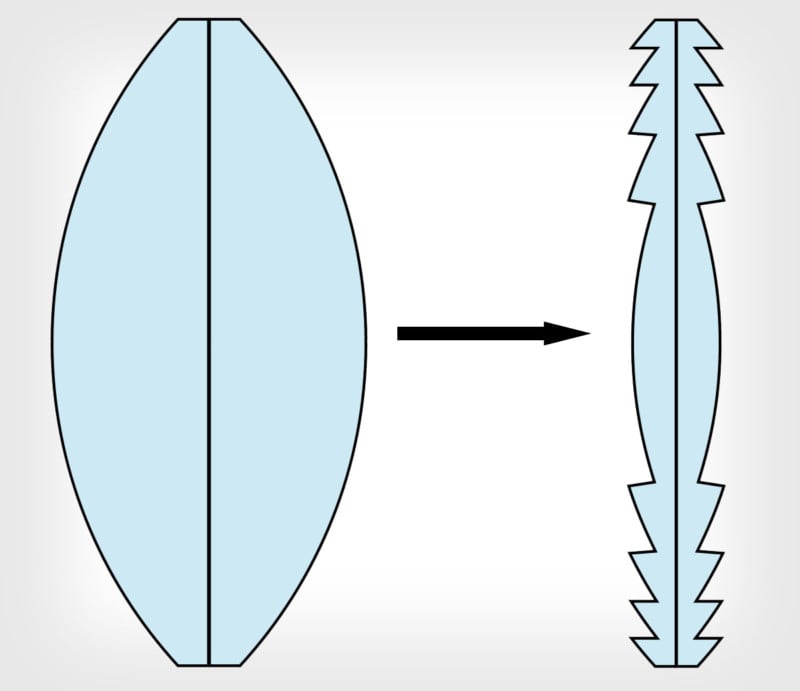

The basic idea is that if you cut a parallel gap into the middle of an optical lens, light still enters and exits both sides at the same angle.
“Fresnel realized that if I have a really big thick lens, it’ll still be the same lens even if I take out a parallel-sided strip,” Willey says. “And if I can take out one parallel-sided strip, why not take out many parallel-sided strips?”
So if you hollow out a lens with parallel strips, it’ll continue to be the same lens despite having an air gap inside. But this new hollow lens will be quite weak compared to a solid lens. The solution? Collapse the two sides together for a jagged, ultra-thin, lens that’s optically equivalent to the original large, thick, solid lens.
By hollowing out a solid optical lens with parallel slices and then collapsing pieces from the two sides together, you can achieve a much thinner and light lens that’s equivalent.
“It is much thinner, much lighter than the lens before but it acts exactly the same way,” Willey says.

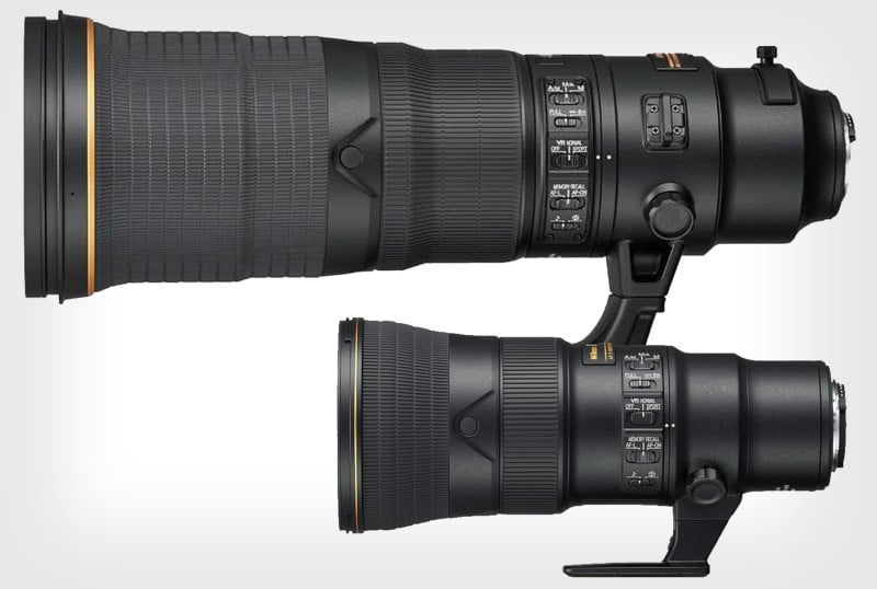

Canon and Nikon are also two camera companies that use Fresnel lenses to reduce the size of telephoto lenses, which are traditionally large and bulky. Canon’s green-ringed Diffractive Optic (DO) lenses and Nikon’s new Phase Fresnel (PF) lenses both offer significant size and weight savings compared to their traditional counterparts.
Here’s the striking size difference between the traditional Nikon 500mm f/4E AF-S NIKKOR FL ED VR lens and the Nikon AF-S NIKKOR 500mm f/5.6E PF ED VR:
Comparing the sizes of the Nikon 500mm f/4E AF-S NIKKOR FL ED VR (top) and the Nikon AF-S NIKKOR 500mm f/5.6E PF ED VR (bottom).
While you do give up a stop of light with the new 500mm PF lens, it weighs 3.2 pounds (1.45kg) compared to the 6.8 pounds (3.09kg) of its big sibling.
