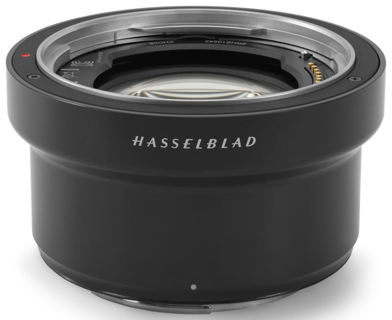

Hasselblad has announced the XH Converter 0.8 which adapts H system lenses to the newer mirrorless X system while also reducing the focal length by 0.8x and improves the maximum aperture of the adapted lens by two-thirds of a stop.

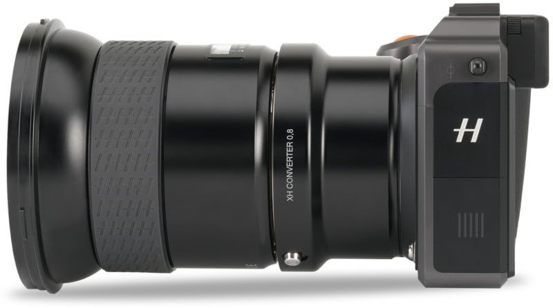

The XH converter works similarly to the technology behind products like MetaBones Speedboosters by taking a standard converter and adding a glass element between the body and the adapted lens. Adding that element became possible because of the extra flange distance that Hasselblad has to work with when comparing an H system lens (designed for cameras with a mirror) to the X system (mirrorless).
If you were to take the Hasselblad 100mm f/2.2 HC lens and adapt it using the XH Converter, it would turn into an 80mm f/1.8 on an X system camera. The resulting combination would be even faster than the 80mm f/1.9 XCD lens, which is the fastest native lens for the X and 907X systems. Similarly, if you were to take the 24mm f/4.8 HCD lens and adapt it, the result would be a 19mm f/3.8, even wider than the widest available X lens.

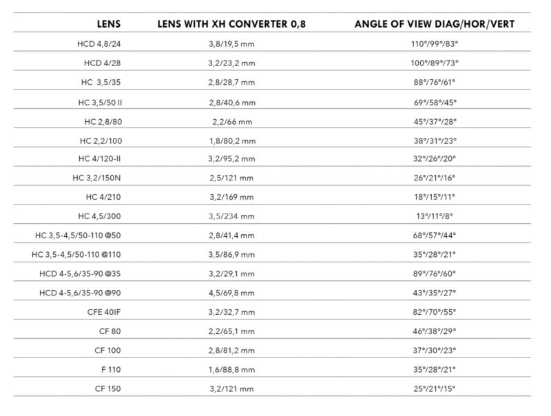

This is a full list of the compatible lenses, and how the XH Converter 0.8 would change them:
