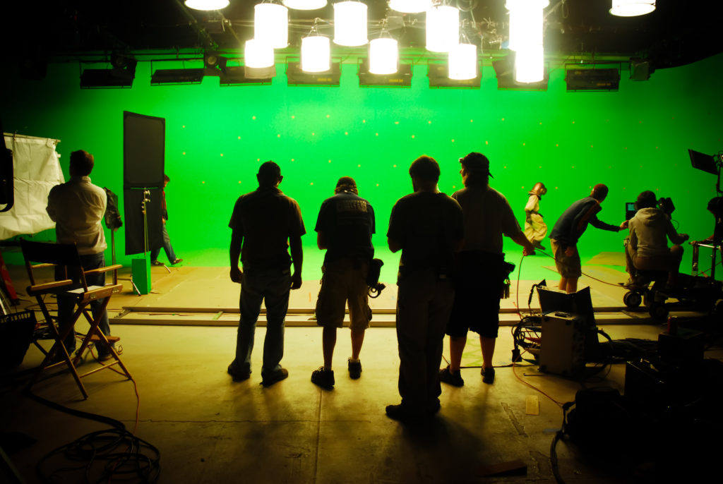

How To Achieve The Perfect Chroma Key For Green Screen Videos
Perfect chroma can be accomplished with a few simple steps.

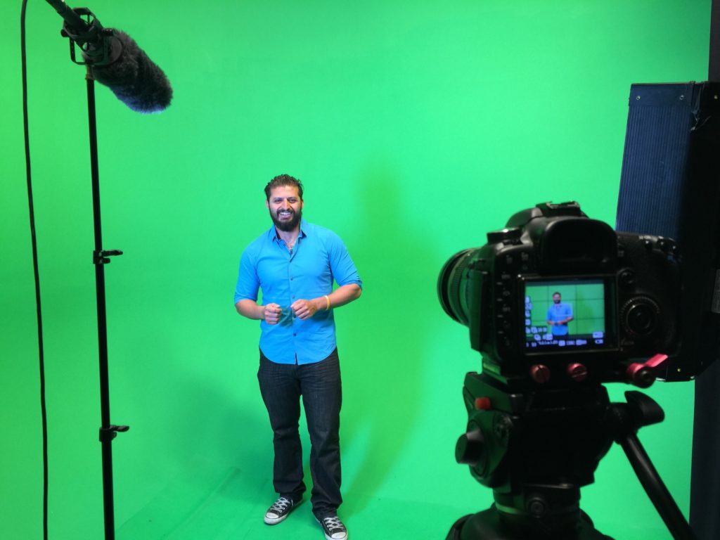

The Planning Process You Should Use
When planning green screen videos, choose the correct color to use based on the colors associated with the subject. A green screen is used as there’s often blue in the foreground or eyes. Alternatively, if there is green in the foreground, use a blue screen.
Gauge the size of the studio, set, or room for green screen setup. The size impacts factors such as lighting and placement.
Green screens are available as seamless paper backdrops, collapsible green backdrops, and cotton muslin. Make sure the green screen is clean and wrinkle-free to prevent shadows from appearing in the final cut.
Choose the correct lighting setup to suit the size of the space and the size of the green screen. Ensure that light is evenly placed to keep the screen evenly lit.

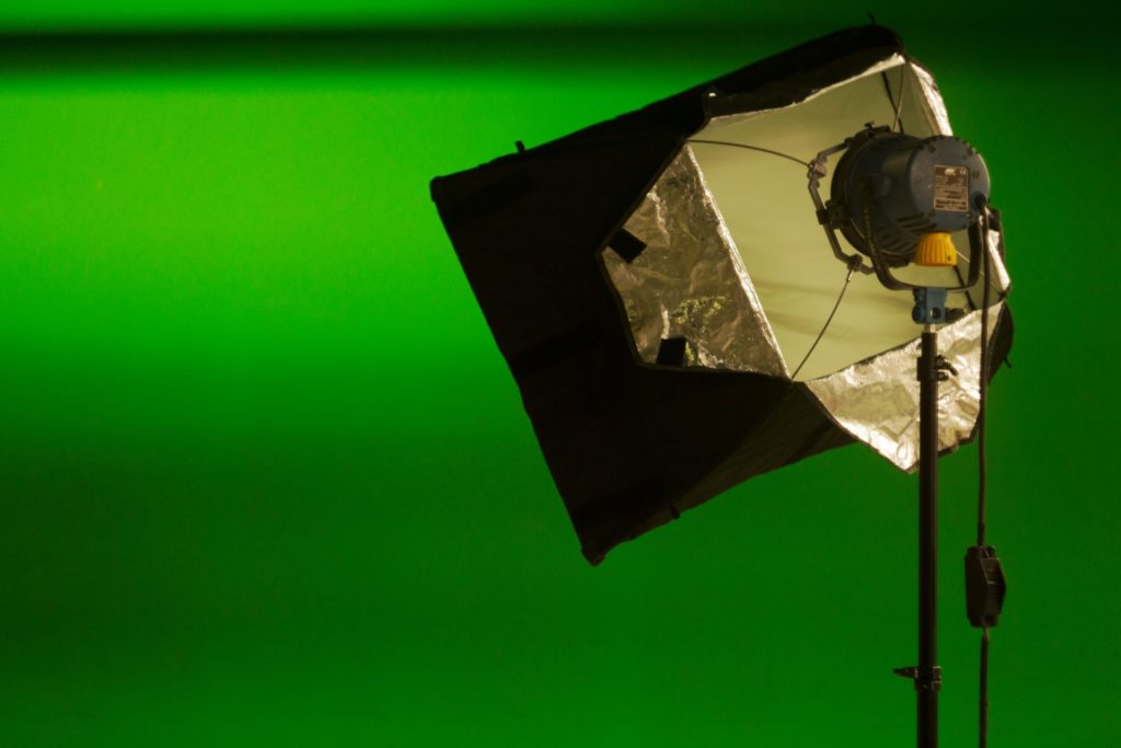

Best Lighting for Green Screens
Lighting the subject and background are equally important with green screen videos. Light both independently for the best outcome. Some videos require a half body crop, a full-length shot, or a massive studio-sized green screen for cinematography.
Even lighting is essential as a darker chroma area won’t be picked up during the keying process. One of the best lighting solutions for green screen videos is continuous LED lights. They are compact, portable, and don’t generate heat.

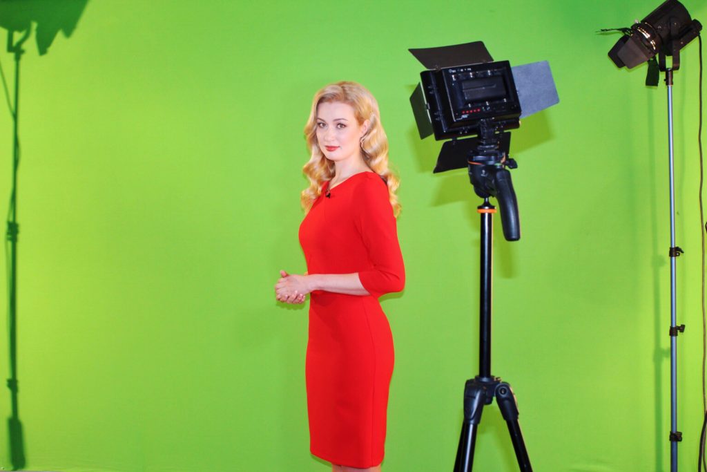

How to Prevent Spill
Green screen videos include both the process of capturing the subject against the green background, as well as using an editing software to do all the keying magic. Most vision mixer software offers the keying functionality you will need for this process. Once more, remember to choose the right chroma color, light the screen correctly, and avoid spill. As a result, you’ll be able to make the post-production portion easy by obtaining a completely transparent background, a successful keying, and a convincing final result.
- Choose the right screen color to use.
- Light the green screen correctly and evenly.
- Separate your subject from the background with distance or light to avoid spill.
- Use the editing suite or vision mixer’s software to its fullest potential.
- Avoid reflective screens by selecting a matte finish green screen. Lower cost and collapsible options often use more reflective material.
- Keep the subject far enough from the green screen to avoid spill and to avoid casting the subject’s shadow onto the background.
- If in a close-set, subject backlighting counteracts spill and background reflection.
- Makeup helps to prevent spill from appearing on a subject’s skin.
