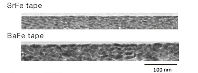

SrFe has been found to have higher magnetic characteristics and 60% less particle volume than BaFe. And like BaFe, SrFe is a chemically stable oxide, meaning it should perform well for long-term data preservation.
Electron microscope images of the cross-section of magnetic tapes.

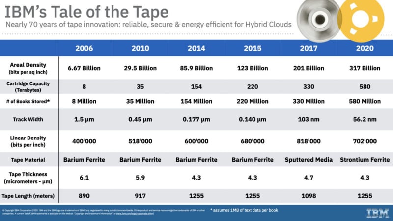

The progression of record-breaking magnetic tape storage capacities.
