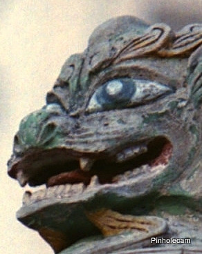

I made a make shift holder for a strip of negative, placed a white sheet of paper behind it and shone 2 table lamps on the paper to provide a even white light source. Placed the DSLR on tripod in front of the negative with a 100mm macro set at f8 and took a shot.
Original full image
100% crop from Scanner (9000F)
100% crop from DSLR
Colors aren't anything to shout about and my lousy rig attracted a lot of dust on the negative.
But to me the difference in detail between flatbed and DSLR 'scan' is shocking
Am I missing something here? (Eg. Scanner not setup properly)

Indeed it's DSLR with your Macro win hands down. But how much did you pay for your DSLR + Macro + Tripod versus Canon 9000F ? :)
I'm sure a drum scanner will do better, just how much better. Those motors moving in the flatbed scanner has too much vibration to give you such a detail result.
Curious though, I notice that you have a lot of fine colour noises in the DSLR, are you using a high ISO ?

Ha..ha... indeed. That ran through my mind too. Its a ~$2300 'scanner' in this case.
But I think if one already has a DSLR, then its a way to do the 'scan' w/o spending another $200 for the flatbed, not to mention the size of the scanner, speed to scan and quality. (my main problem with the flatbed I have is size (no space in house), time, o/p quality)
I did try a GF1 w/o macro lens on 6x6 film. It did not cover the full frame of the m4/3 sensor this way, but it got pretty good details vs scanner as well. So in theory, a 2nd hand camera (eg. G1 at $250 or $350-400 APS-C DSLR in bns) an extension tube and cheap manual 50/2 may well do a decent job. Not that cheap at $400-600, but maybe better results.
Noticed the 'noises' as well, but after processing (ie. auto balance; invert color; 1pt sharpen), so not too sure yet if this is grain on the film that has been accentuated by the sharpening and processing or something else. Too bad I saved over the file in this case. Certainly something to look into in future trials.

i'm guessing in camera sharpening might be a reason hmm.
I really don't think so. I tried the same sharpening method for both and even tried out doing more for the scanned copy, but results were different.
Of course I can be wrong.
What makes you think its the in-camera sharpening.
Just take the 100% crop example from the top (ie. post #1)
I don't think the scanned version can be made to look like the DSLR copied one. (at least on Paint.net and Elements 8.0 that I am using)
