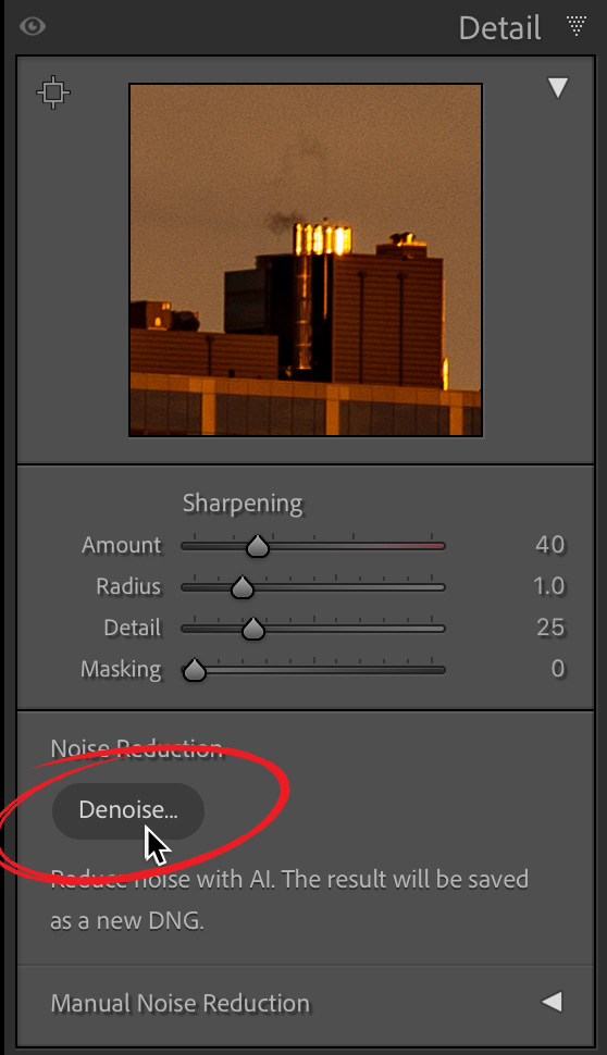

STEP TWO: Scroll down to the Detail panel, and at the bottom of the panel, under Noise Reduction, click on ‘Denoise’ (as shown circled here in red).

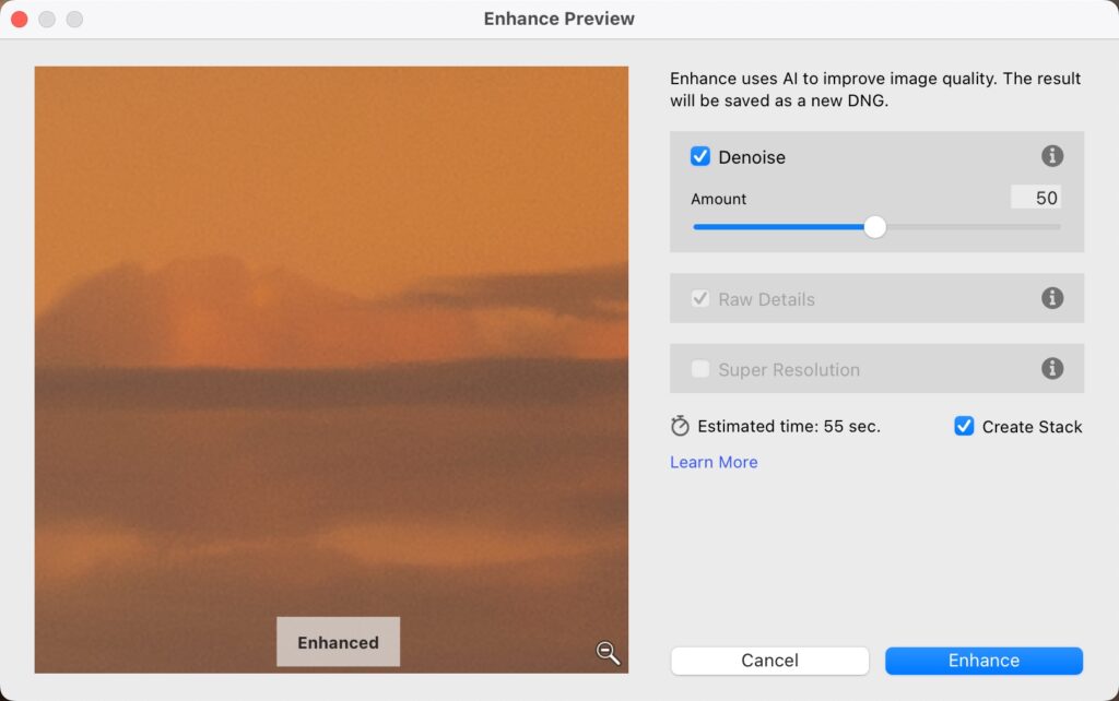

STEP THREE: The Enhance Preview window appears (seen above), and Denoise will be selected by default (as seen here). There’s an amount slider so you can increase or decrease the amount of noise reduction you’d like to apply, and it also shows the estimated time it will take to apply this fix (in this case, it estimates 55 seconds).

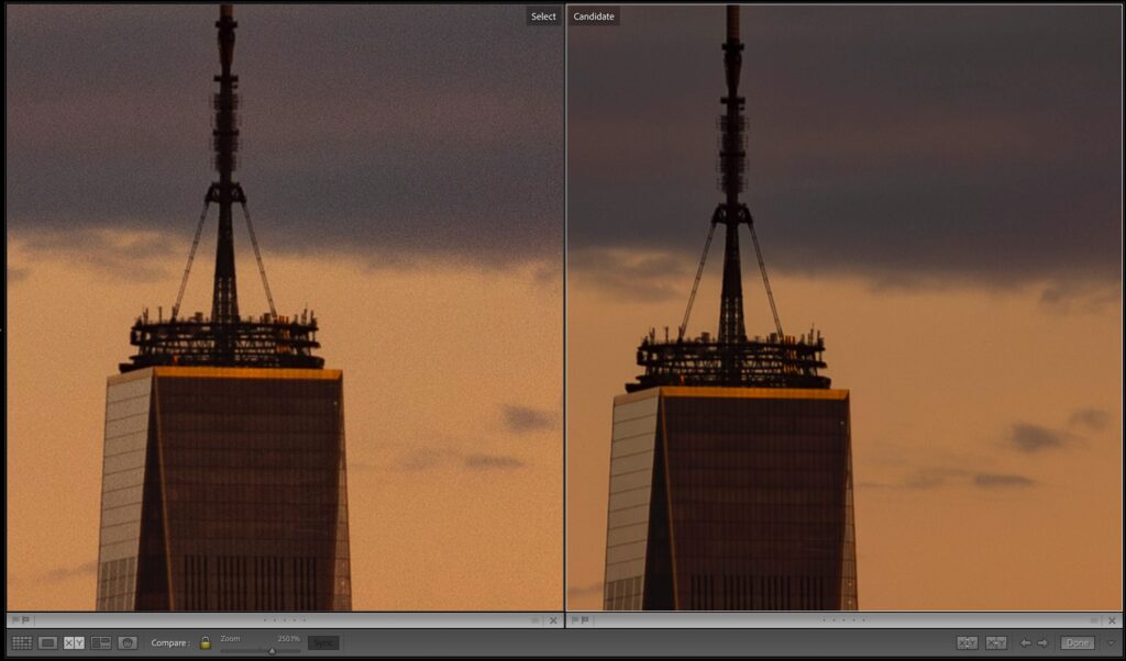

STEP FOUR: Here’s a zoomed-in before and after so you can see the results. I used Compare mode to show this because when it does its thing, it creates a new separate Raw DNG image, so you have your original and a new file). This is those two side-by-side). You can see it did a pretty nice job removing the noise (better than anything we had built in within Lightroom or Photoshop before.

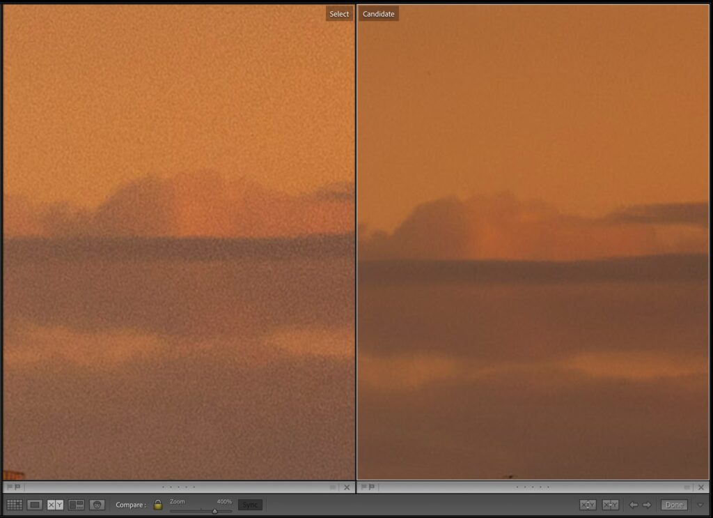

Above: here’s a zoomed-in look where you can see it did a really nice job of holding the detail.
