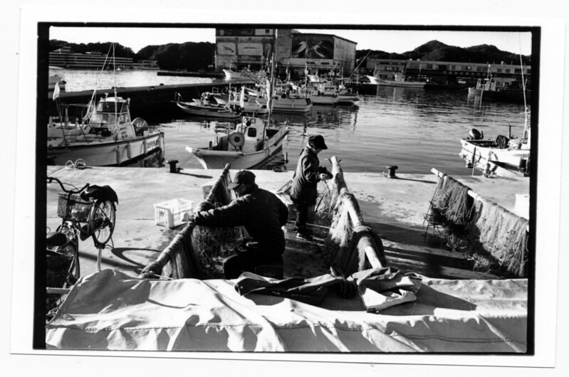

Just a quick scan of a print I did. Paiseh paper not straight, i dont have an easel lol. Using black tape at the moment. Wish I bought some 8x10 size, I only both the postcard sized papers to practice. Just wondering, what's the best way to control contrast? I've read about buying different grade filters, where can I get these in Singapore? Also if say I wanted a black border around the photo, what's the best way to do this?
great job for the first print! some enlargers has the variable contrast built in so u might want to just check does yr enlarger has this function. else u have to use those multigrade filters and to use that there should be away to mount them.
to have a black border, you need to prepare a heavy stock mounting board slightly smaller then your paper size. After exposing for your image, place the card over the image carefully ensuring you have equal sized border. then remove your negative and expose for a minute or so. The part of the paper not blocked by the card will become black.

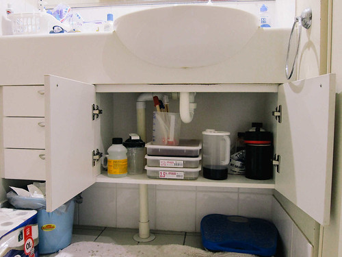

Can you post a picture of your makeshift darkroom set-up? I am interested, and want to know how much space it takes.
I use my bathroom. I have a cloth snake like thing used to block out sound/cold air for the door, that keeps the light out. I used two large pieces of black construction paper and black taped it over the window in the corner, very light tight.
My enlarger fits over the wash basin sink. I put the trays on the floor, used to bring a small bench in but can't be bothered now. Trays are actually just flat tupperwares, I put the lid on so I don't even have to pour the chemicals away (except developer sometimes) after printing. Fill the sink with water, chuck my finished prints in there and hang them up on clothes line or stick on to mirror. I use red bicycle light bounced off the wall, usually a bit further away from the paper.
When I'm done, all the trays and tools go under the sink.

Thanks for sharing your cool setup! I'll be moving to Punggol soon, it's only 92sqft. I will need a lot of creativity to fit my bicycles and darkroom in
Haha as you can see from my setup, don't need much space at all! Make sure everyone has used the bathroom and happy lol, otherwise they will come a kacheow you halfway through your printing process!
I've read that some people dismantle their enlarger into the original packing styrofoam and put under the bed or in a suitcase to save space. Very troublesome if you print regularly though. I'm really happy I bought the tupperwares instead of proper darkroom tray, only cost $2 each from budget store and can set up very quick, able to unpack and print a single photo and pack it all up again in about 10-15 mins I do everything right.
