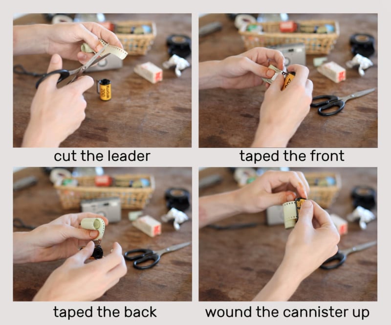

Most of you probably don’t know how lucky you are having your film pre-loaded into canisters. Back in the USSR, photographers DIYed it by loading it into reloadable shells with a bulk loader. We didn’t have reloadable shells or a bulk loader, so we had to recycle some spent canisters that we picked up from a local lab and reattach the film to them in the dark. We also didn’t have a dark bag, so I used a backpack and sweater turned inside out. Works just as well, but just to be safe it’s good to do it in under a blanket and in a darkish room.

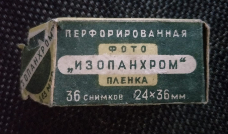

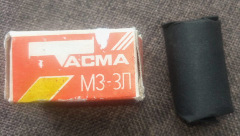

So the film comes in these little cardboard boxes, wrapped in black paper:
This may not seem like the most secure method of storage, but so long as they had been kept at a fairly low temperature and kept dry, they should still be usable. The paper has been wound tight, and the best thing about this method of storage is that because they are not stored in metal canisters they have not built up annoying static electricity, which makes them so curly that it can be almost impossible to wind onto a Paterson tank.
So here’s the procedure I used to transfer them into the blanks (of course, you do this in the dark):

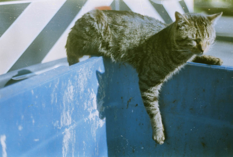

This was my first roll and I was unsure whether it would work at all. The grain as you can see is bad, especially for such a low ISO film, and I didn’t go to any length to keep the dust off it. Also note: don’t even bother using squeegee tongs on film this old — you will just scratch the hell out of the base (see pictures 1 and 2)

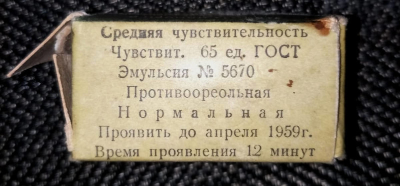

But it worked, so I decided to give another roll a go. This time I shot the oldest stuff in the box:
The translation reads “Medium Sensitivity – GOST 64 (ISO 65); Emulsion No. 5670; Anti-Vignette; Normal; Develop by April 1959; Developing Time 12 Minutes.”
It states that it has “‘medium sensitivity” but I metered it at 12 ISO to compensate for age, powered up my flash to full and used the fastest lens I had (f/1.1 7Artisans) to see what I can pull out of this antique roll:
