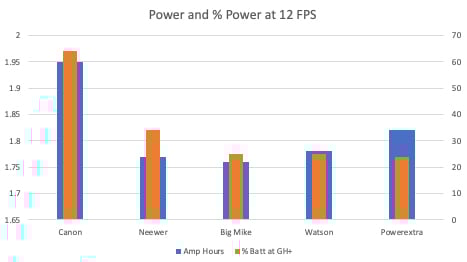

“All NH batteries overstate their actual performance – even Canon’s,” Camnostic found. “The third-party versions all claim to have more juice than the Canon, and every one of them actually has less power. Here is perhaps the most important chart on the topic: the real-world amp-hour measurements for each brand using a special Dolgin Engineering device that charges the batteries fully, and then measures the draw to 0. The Y-axis on the left in chart below (amp hours) is compressed to better show the differences.”
The blue columns represent the gross usable power in the battery, which Canon won by about 10-15%. The orange columns represent the percentage of the battery’s power that is applicable to the higher-wattage mode allowing for 12 frames per second before the waning wattage fails over to a lesser framerate mode.
It’s obvious that the Canon first-party batteries are wildly better in performance than the four third-party options tested. That said, some users might not notice.
“Users who shoot only in electronic shutter may never notice a functional difference between battery brands, but those who use mechanical shutter and require 12 FPS certainly will,” Camnostic notes. “A third-party battery causing the GH+ 12 FPS mode to go away isn’t as terrible as it might seem when one can always just switch to electronic shutter and get a consistent 20 FPS. Few applications (rapid panning, for one) do call for mechanical shutter necessarily.”
