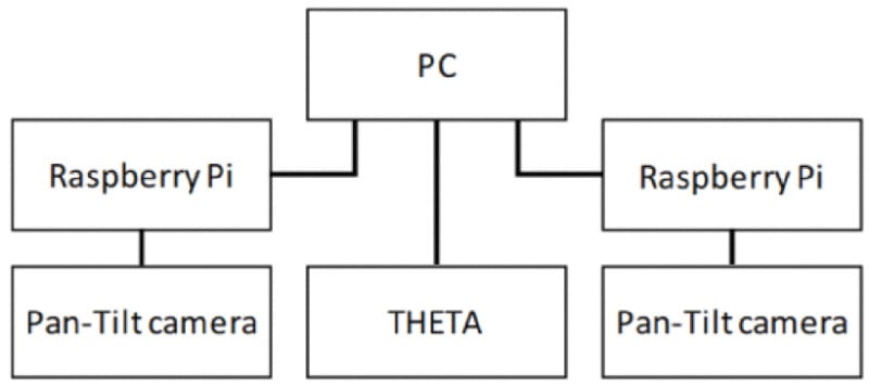

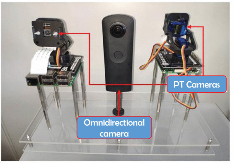

In the study, the duo created a prototype hybrid camera platform that consists of one omnidirectional camera and two pan-tilt (PT) cameras with a 180-degree field-of-view on either side. When an indistinct target region is detected using the 360-degree camera, the PT camera is then used to capture a high-resolution image of the target.
Connections between each camera and the computer. Image by Chinthaka Premachandra and Masaya Tamaki, Creative Commons.
The two used Raspberry Pi Cameras on which a pan-tilt module was mounted and then connected to the system through a Raspberry Pi 3 Model B. Then, all of the parts of the setup were connected to a personal computer to allow overall control.
The camera platform used in the study. Image by Chinthaka Premachandra and Masaya Tamaki, Creative Commons.
