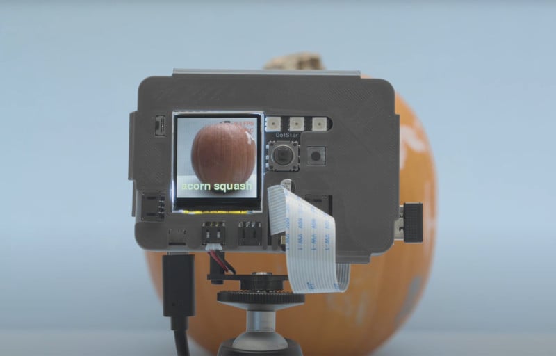

Adafruit Industries has created a machine learning camera built with the Raspberry Pi that can identify objects extremely quickly and audibly tell you what it sees. The group has listed all the necessary parts you need to build the device at home.

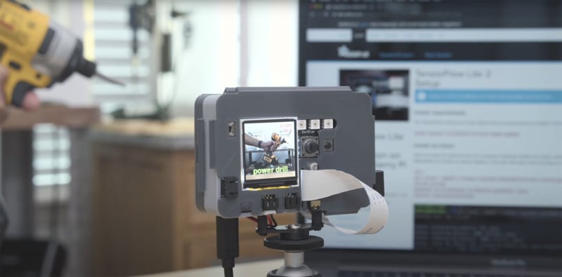

The camera is based on Adafruit’s BrainCraft HAT add-on for the Raspberry Pi 4, and uses TensorFlow Lite object recognition software to be able to recognize what it is seeing. According to Adafruit’s website, it’s compatible with both the 8-megapixel Pi camera and the 12.3-megapixel interchangeable lens version of module.

You could connect a DSLR or mirrorless camera from its trigger port into the Pi’s GPIO pins, or even use a USB connection with something like gPhoto, to have it shoot a photo or start recording video when it detects a specific thing enter the frame.
