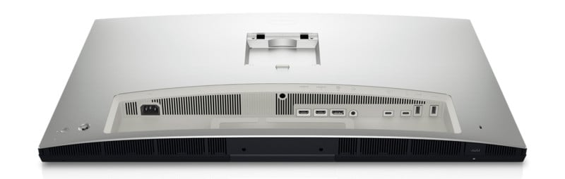

The monitor measures about 1.5-inches thick at the edges, with exhaust vents all along the sides and a somewhat chunky bottom bezel where the built-in colorimeter folds away. The remaining bezels are satisfyingly thin, making for a minimalist “all screen” look, and the back of the display is covered in a thick plastic with a platinum silver finish. The plastic casing saves some weight, but it’s not going to be as solid (or impressive looking) as the aluminum that Apple uses in the Pro Display XDR. Whether or not that really matters is for you to decide.
In terms of ports, you’ve got a full-fledged Thunderbolt 3 connection with 90W power delivery, two HDMI 2.0 ports, a Display Port 1.4, two USB Type-A 3.1 ports, an audio out that does not support headphones, and an additional Thunderbolt 3 port that is limited to 15W of power delivery. Conspicuously missing from a “creator” monitor of this caliber are a true audio pass-through and an SD card slot. That’s pretty disappointing when you consider that my $600 BenQ monitor has both.

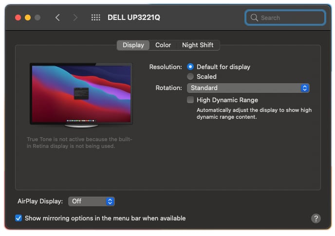

The real revelation when using this monitor, though, came when I turned on HDR on both the monitor and my computer—the Dell supports both HDR10 (ST 2084) and Hybrid Log Gamma (HLG).
The problem is that there is no way for me to show you this performance. Screen recordings, external videos, screenshots… none of them will properly communicate the difference unless you’re actually viewing it on an HDR monitor. Suffice it to say that I spent 45 minutes just switching back and forth, blown away by the color and dynamic range that the display could produce when showing HDR content.

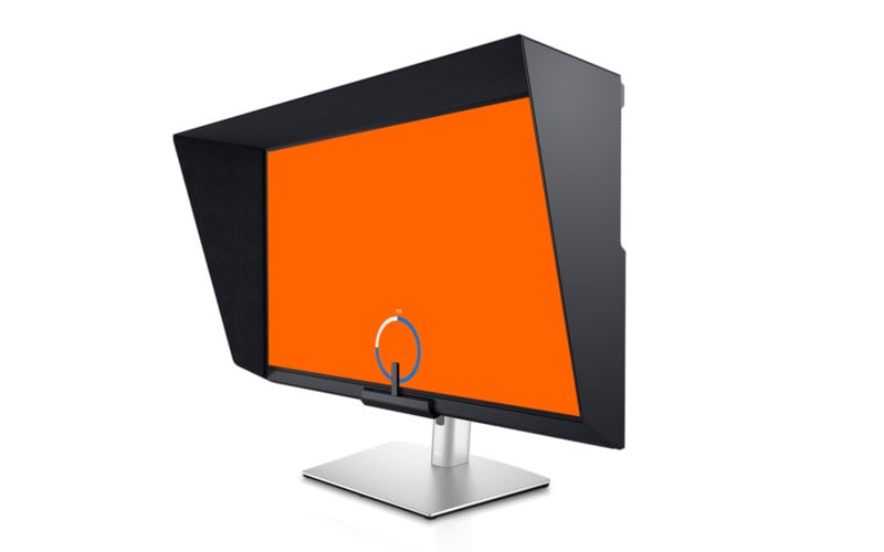

The last of the big features included in the Dell UP3221Q is the Calman-powered calibration—a first for a monitor of this size. It’s not Calman validated, it’s Calman powered, promising professional-grade calibration and validation without needing to plug in an external computer or colorimeter.
Normally, I’d criticize a built-in colorimeter as a gimmick for one simple reason: depending on the backlight, many LCDs have issues with brightness uniformity that make built-in colorimeters suspect. Since all built-in colorimeters are embedded into the edge of the display, this means that they calibrate the monitor at the edge, not the center, of the screen. For an edge-lit or un-evenly backlit LCD monitor, this is the kiss of death because it’s really hard to produce uniform brightness, which could throw off your calibration on the part of the screen you actually use.
Of course, the Dell doesn’t have this problem. Since it uses the latest and greatest backlight with more mini-LEDs than anyone else, every 64×64 pixel chunk of screen is individually lit and controlled to an exacting level of precision.
I’m comfortable recommending that you leave your personal colorimeter in its box and rely on the built-in option. However, if you do want to use your own, Dell includes a separate USB port that is used for this exact purpose. If you own a Calman-powered colorimeter, you don’t need an external PC. Just connect the calibration sensor to the dedicated USB port on the bottom of the monitor and use the monitor’s built-in menus to validate or calibrate. Easy peasy.
