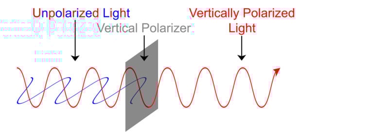

Polarized light waves are all oscillating parallel to each other, meaning they all share one plane. To polarize unpolarized light, we can use a circular or linear polarizer, which only lets the light of one certain plane pass while light waves that are oscillating in a different direction we’ll be reflected.

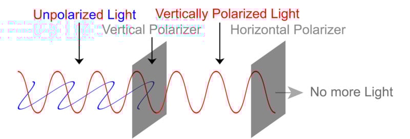

Two polarizers that are aligned perpendicular to each other don’t let any light pass.

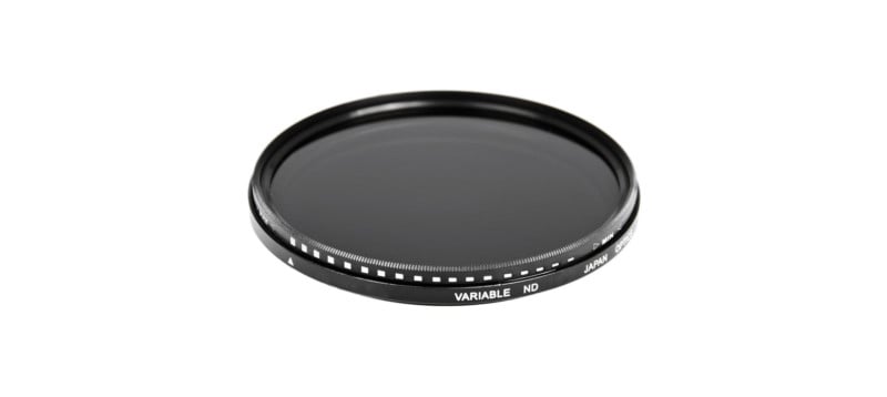

This is the same principle that variable ND (neutral density) filters use to block out varying amounts of light. Such filters consist of polarizing filters, one of which is stationary, while the other one can be rotated against it, which gradually blocks out more and more light until the two filters are aligned perpendicular to each other and effectively block out all light.

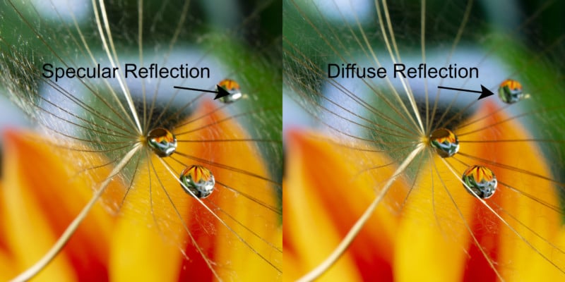

This gets really interesting when we are directing our polarized light source onto our subject. As the polarized light hits the surface of that subject it becomes reflected and most of it turns into diffused, unpolarized light again except for the specular component of the reflection, which is still polarized and can therefore be canceled out by employing a second polarizer (CPL) filter in front of our lens.
The result leaves us with a very clean looking image.

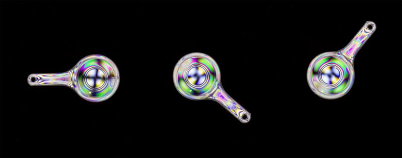

It can also be employed to create images like this:
In part two, we’ll discuss more about birefringence and how to create colorful images utilizing it.
