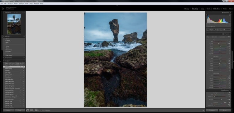

My post-processing workflow almost always consists of initial ‘global’ edits to images in Adobe Lightroom, before bringing the images into Photoshop for ‘local’ adjustments and fine-tuning before reaching a final product.
When I am working on a ‘time-blended’ image, my first steps are to synchronize exposures and white balances in the images that are to be combined. While in the field, I made the mistake of having my camera’s bracketing setting on, meaning that the two images here had slightly different shutter speeds and exposures. Because of that, I had to alter the exposures so that they matched.
I also cooled the white balance significantly, added contrast, and made some HSL slider adjustments in both images to enhance the bleak, stormy, and angry mood that I wanted:

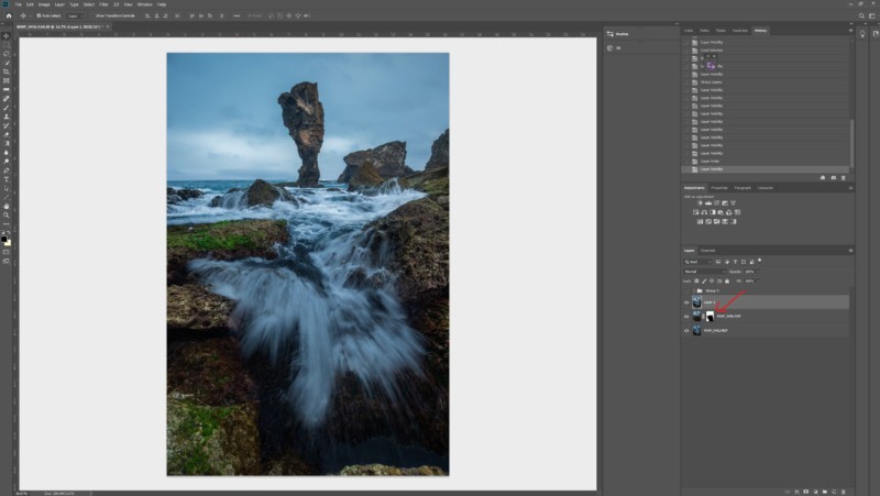

At this point, I was ready to import the images into Photoshop by selecting both, right-clicking, and selecting ‘Open as Layers in Photoshop.’
This provides the opportunity to combine the two images using layer masks. But before I can do that, I need to make sure that the images are aligned perfectly. Even while using a tripod, two exposures can alter slightly if the tripod was moved the tiniest amount whether because it was knocked into, moved in the wind, or shifted by the ocean current.
To do this, I use the ‘Edit’ Dropdown in the toolbar and select ‘Auto-align layers’ and I let Photoshop render this function using its auto settings. Sometimes, if the two images have more than negligible differences, the auto-align function may not work as well. So, I always check the differences by changing the blending mode of the top layer to ‘Difference’ which will show the areas where the two images differ in white.
If necessary, I will manually align them by moving one’s position, or slightly warping it (usually necessary when focus stacking as widely differing focal points can slightly alter the focal length of your lens; but that is a different subject for a different time).

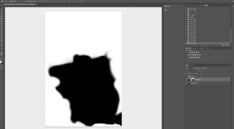

Now, the fun part. Once properly aligned, I add a layer mask to the top exposure (my baseline image). On this occasion, this was the first exposure taken as that will be what I will use for the majority of my image. The second exposure will be used in the foreground wave action.
With the layer mask selected, I use a 0% hardness, black brush and paint over the areas where the foreground water motion is in the second image, revealing that portion of the lower layer, creating a combination of the two exposures in one final ‘time-blended’ exposure:

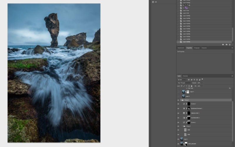

Once I am satisfied with the layer mask, I merge all layers (Ctrl/Cmd + Shift + Alt +E) for final adjustments.
After some local and selective contrast, color, and dodging and burning adjustments, we have our final image!
