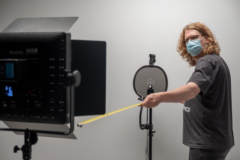

If some of the exposure results I recorded seem underwhelming, please note that my test target with my light meter was 6 feet away from the source (measured from the front of the light surface or the front diffuser). If you want your light to punch above its weight class, the best thing you can do is to move it closer! If you reduce the distance from 6 feet to 3 feet, your light becomes an effective two stops (4x) brighter.
It is exactly because of this behavior (the inverse square law of light) that I chose to position my lights a little further back than I might in a typical portrait session. From 6 feet away, I would gain a few inches’ margin for error with my measuring tape.
Setup and Method

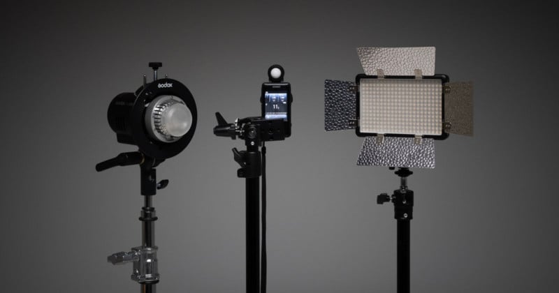

I used a Sekonic L478-D light meter positioned (as mentioned) 6 feet from the front surface of the light. A target grey was also used so that I could cross-reference image data to the data I collected from my meter. All lights were compared at their maximum power. In the case of bi-color LEDs, the color temperature that produced the brightest result was used.
Once the data was collected, I rounded each result to the nearest third of a stop and charted it on the scale below.

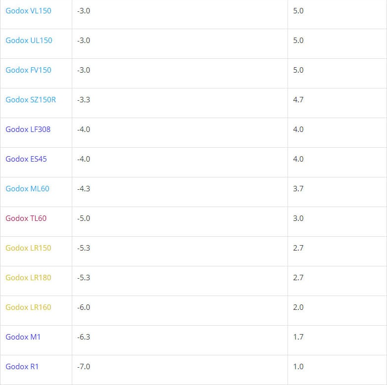

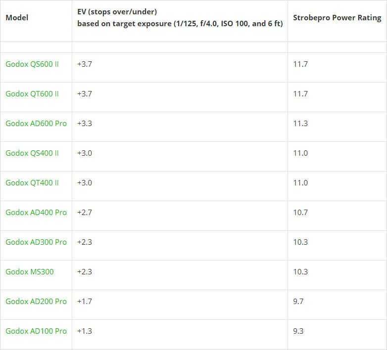

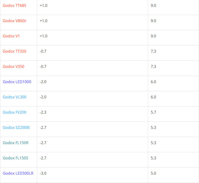

Each whole number in either column represents a stop of light.
For example, the Godox TL60 (power rating 3.0) is two stops (4x) brighter than the Godox R1 (power rating 1.0).
The 2nd column shows the data I collected based on the target exposure. For the target exposure, I used 1/125 of a second, f/4, and ISO 100 at a 6-foot distance from my light meter (measured from the front of the light surface or the front diffuser). A positive number indicates overexposure at the target settings, and a negative number indicates underexposure. For example, the full power flash from our QS600II was a whole 3.7 stops overexposed at those settings.
The 3rd column simply provides distilled data using our weakest light (the R1) as the baseline.
To determine how much brighter one light is than another, take the Strobepro Power Rating of the stronger light and subtract the rating of the weaker light. The result is the brightness difference in stops.

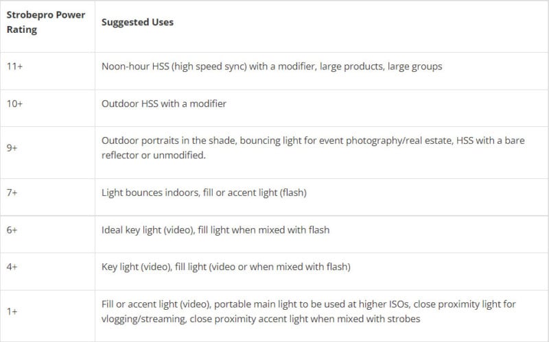

Suggested Uses by Power Rating
Beyond comparing one light to another, there are other useful things we can do with this data. We’ve prepared some general recommendations in the chart below to help you decide which lights might meet your minimum power requirements.
