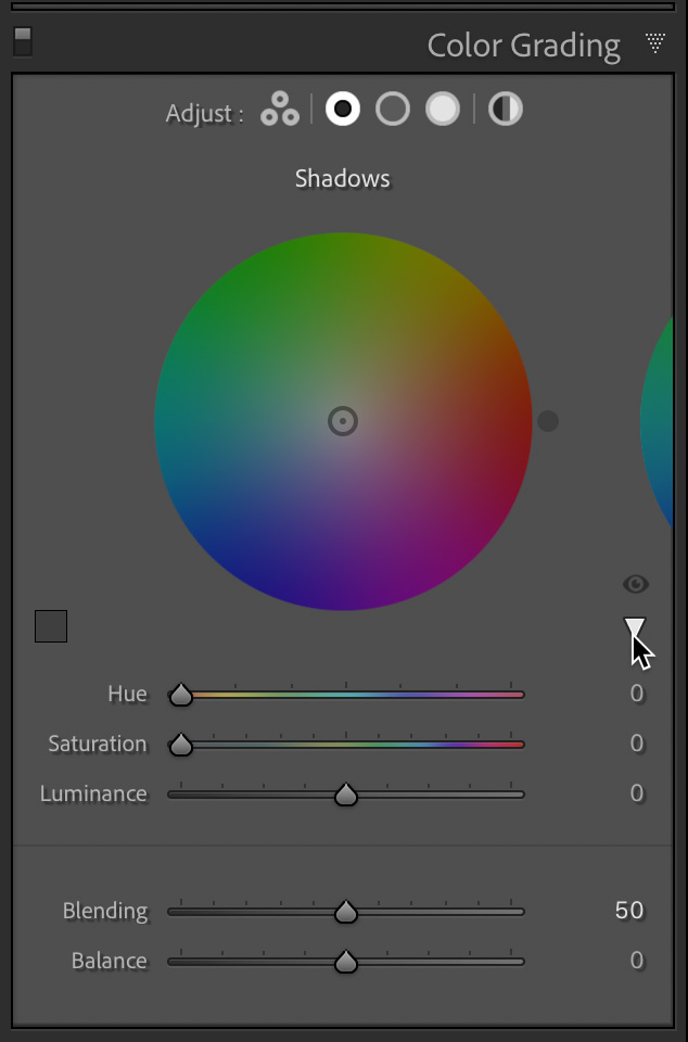

After clicking the button for Shadows to enlarge its color wheel, I can also more easily see the Hue and Saturation values when they are applied. If you click the associated disclosure triangle, those fields expand into sliders. On the left side of the panel you’ll see a Color Swatch, which we’ll put to use shortly (note, only Lightroom Classic has this cool feature).

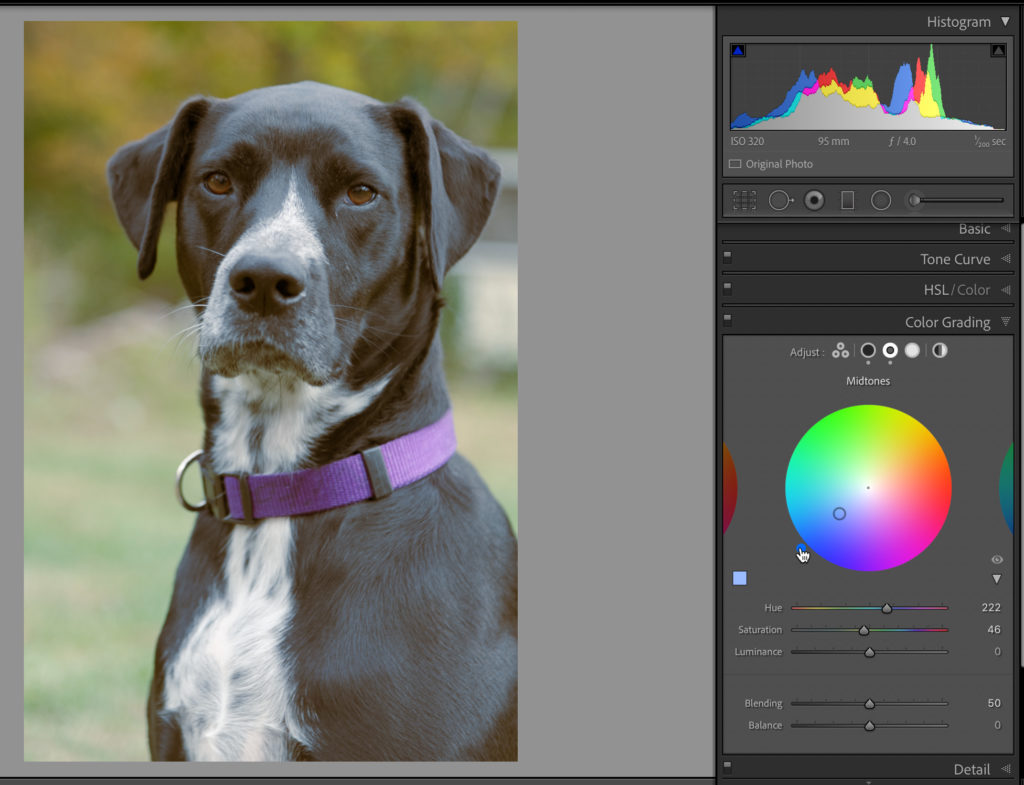

Moving on to the Midtones, I decided to pick a complimentary color to the hue I added to the shadows. With these color wheels, the complimentary color is just 180 degrees around the wheel from the selected color. So, if I applied an orange-yellow to the Shadows, then opposite that on the color wheel would be a nice blue. A visual way to achieve this is to right-click the first color wheel with the tint applied (the Shadows in this case) and choose Copy Settings from the contextual menu. Then right-click on the color wheel you want to change (Midtones in this case) and choose Paste Settings from the contextual menu. Now you have the same settings on both, but to choose the complementary color, just move your cursor to the opposite side of the color wheel and click. The Saturation value will remain the same, but the Hue will change to the color where you clicked.

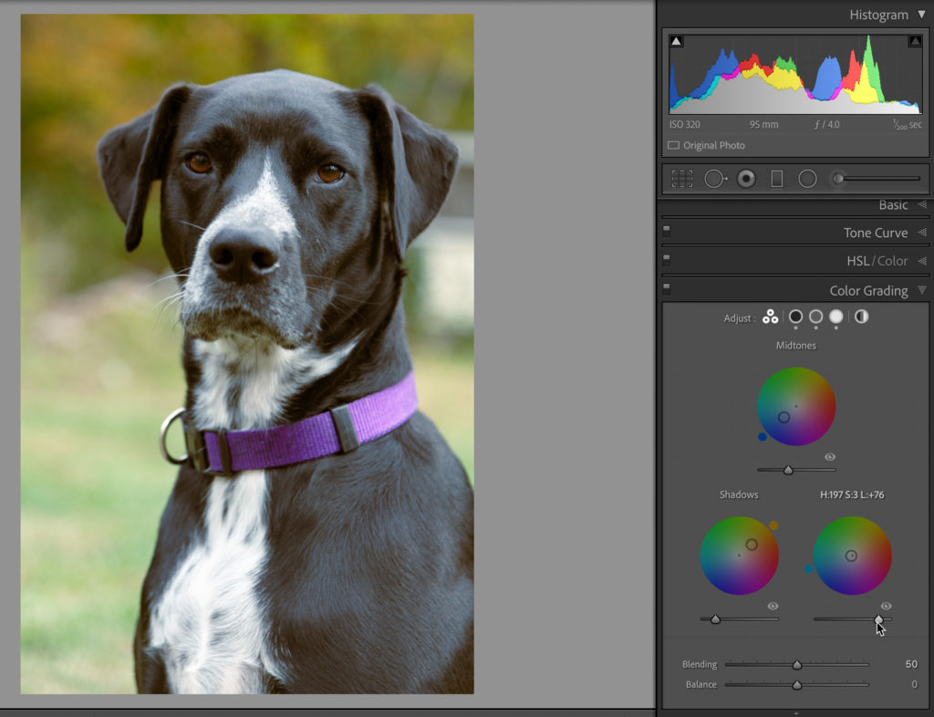

For the Highlights, I used the Color Picker to select a hue from the white fur on her chest, with a really low Saturation value. With a tint for all three tonal ranges selected, I clicked the button with three circles to see all color wheels at once. Now, I can use the eye icon to briefly disable the tint on each color wheel to see how it looks, and fine tune saturation as needed. Clicking the dot that represents the Saturation level within the color wheel locks in the Hue, and allows you to tweak Saturation easily. To lock in Saturation and adjust Hue, hold the CMD key (PC: CTRL), and click and drag to tweak Hue. Once I’m happy with those values I’ll move on to adjusting the Luminance slider for each tonal range to dial in the desired look. In this case, I reduced the Luminance of Shadows and Midtones, and brightened up the Highlights.

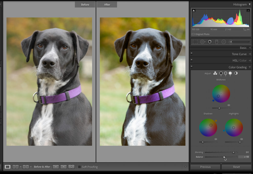

As a final tweak, explore how the Blending and Balance sliders provide fine tuning control over the blending of tint between tonal ranges and how much influence you want to give to one tonal range over the others. Here’s a Before and After view showing the results of the adjustments I made to Blending and Balance.
