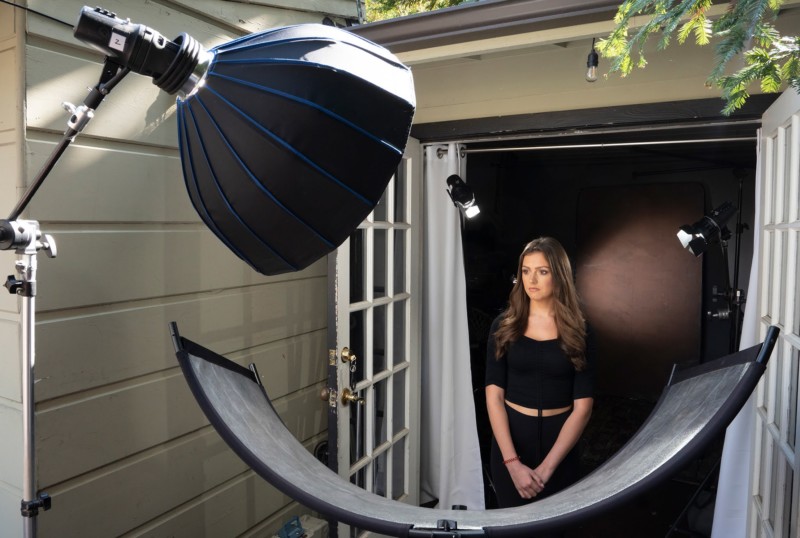

The change that excites me the most is the evolution of the tools that we use for lighting. Traditionally, every new photographer was taught to purchase a speedlight. Then many photographers would graduate to studio strobes or monolights. Cinematographers used big, heavy, and expensive tungsten and halogen lights.
But in the last 15 years, as cameras have become much better at shooting at higher ISOs and photographers have started shooting video with the same cameras, the evolution of LED lighting has brought us lighting gear that is smaller and lighter and now even more reasonably priced. LED lights come in all shapes and sizes and are opening the door to a hybrid approach to lighting that opens so many creative possibilities.

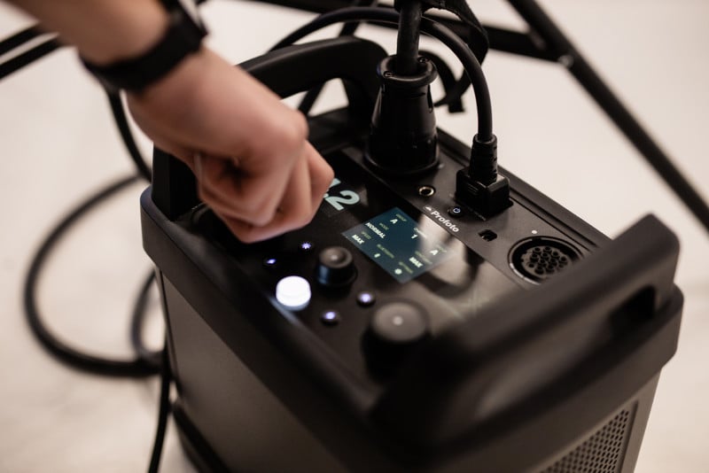

Strobes and Monolights: What is a Watt Second?
Studio Strobe and Monolight manufacturers traditionally use “watt x second” or “watt-seconds” as part of their overall product specifications. This number is even more unreliable because watt or watt x second is not a measure of light, it is a measure of energy. It is simply how much energy is stored and made available for the capacitor to power the flash tube.
In the 1930s, Dr. Harold (“Doc”) Edgerton invented the strobe. To fire a strobe, you need a very high voltage charge which in turn ignites the gas to create a lot of heat and light, including levels of light that the human eye cannot see. This is why strobes are known to quickly overheat. They generate a lot of heat as a by-product of the gas ignition with no effective way to quickly cool them.
A capacitor, which can be described as two metal plates separated by an insulator, is able to store up a big charge and release it all at once. That “charge” is measured in watt-seconds — or put another way, the amount of power (watts) you can deliver in one second. At the time Dr. Edgerton invented the strobe, a watt-second was a measurable way to describe the energy dumped into the system from the capacitor, which in turn ignited the gas in the glass tube.
So, understand that when you look at a 200ws monolight compared to a 300ws or 600ws monolight for example, indeed, each one is more powerful than the other. But from one brand to the next, that doesn’t mean they will give you the same light output. Watt seconds is an unreliable number because different flash tubes have different energy efficiencies as do different reflectors.
What I can tell you is that the bigger speedlights on the market today have approximately 50 to 60 watt-seconds of power. Most monolights are available with power from 130 watt-seconds up to well over a thousand watt-seconds. So, monolights are considerably more powerful than speedlights.

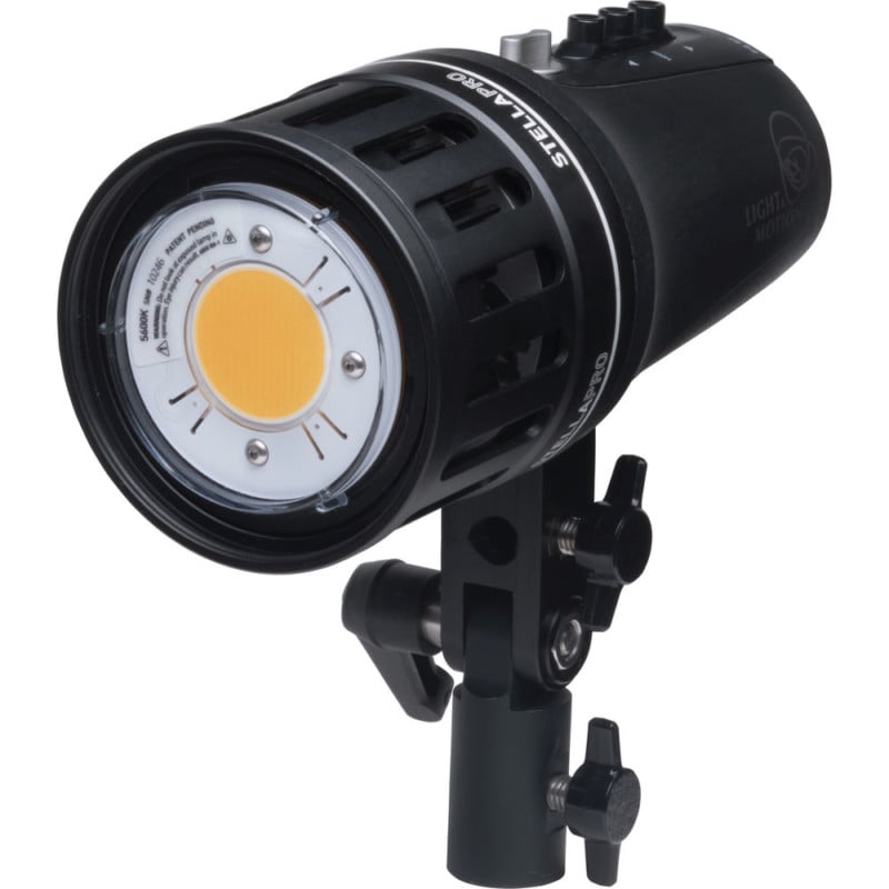

Constant Lighting: What is a Lumen?
Now that we know a “watt” is actually a measure of power or energy use, and not light, we can talk about digital light-based LEDs, which actually use fewer watts to produce a lot more light.
We measure LED bulbs based on lumens because lumens equal brightness.
A “Lumen” is a unit created to measure the light that the human eye can see. Light energy that the human eye cannot see, such as ultraviolet and infrared, is excluded from the lumen measurement. LEDs, unlike flash tubes, have been optimized to only deliver light visible to the human eye and to not spend unnecessary energy delivering light that is not visible.

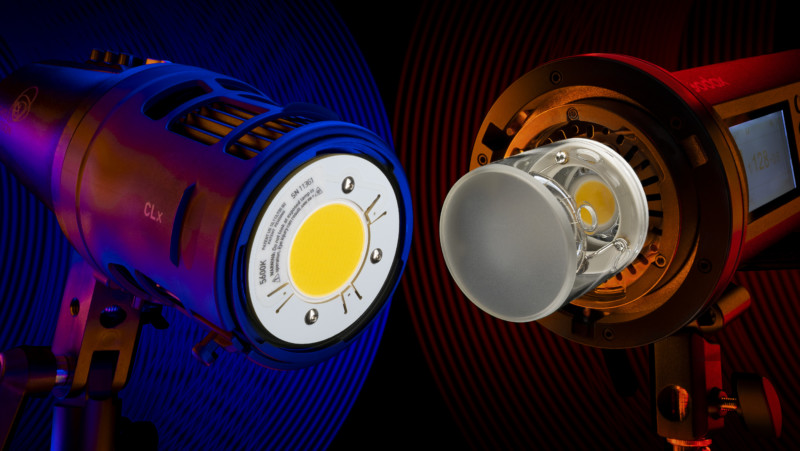

Header image: On the left a StellaPro CLx10, a 10,000 Lumen LED. On the right a Godox AD400, a 400ws Strobe
