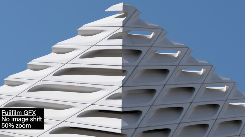

The side-by-side test involved capturing photos of The Broad art museum, since its architectural style and location was ideally suited for highlighting issues like aliasing and any problems with dynamic range.

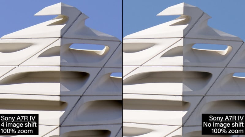

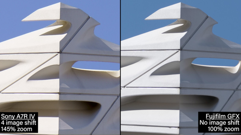

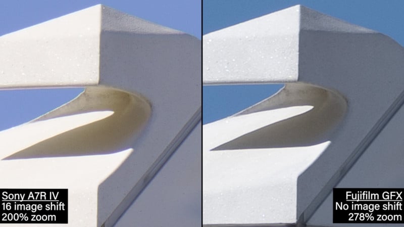

First, they compared the full-frame Sony to the medium format GFX. When using the pixel shift mode with the Sony, you have two options: a 4-image stack that spits out a sharper version at the same 61MP resolution as a single shot; or a 16-image stack that produces a whopping 240MP file.
You can see side-by-side comparisons of the output from the Fuji and the Sony (in both modes) below:

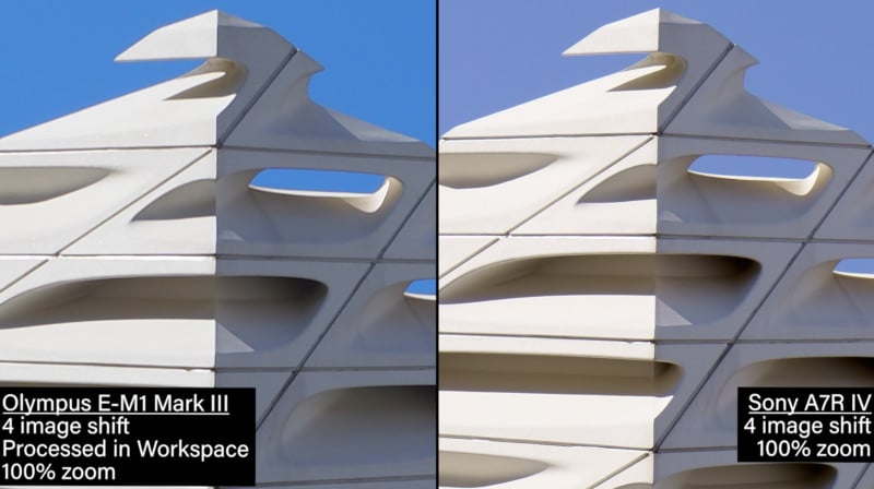

Next, they compared the Olympus output to both the Sony and the Fuji GFX.

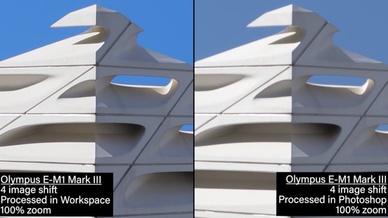

Interestingly, the quality of the Olympus file came out much sharper if you process the files in Olympus’ own Workspace software, as compared to using Photoshop. You can see a side-by-side below and there’s really no comparison: if you’re using the pixel shift mode on your Olympus camera, definitely use Workspace to stack the images.
The rest of the comparisons were done using the Workspace version (obviously) in order to keep quality as high as possible.

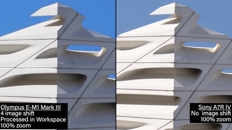

Here’s the Olympus 4-image stack against the Sony with no image shift, and then the against the Sony’s 4-image stack mode:

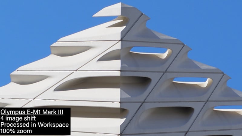

Finally, you can see the Olympus pixel shift image followed by the GFX all by itself below. For some reason, they didn’t show these side-by-side in the video:
