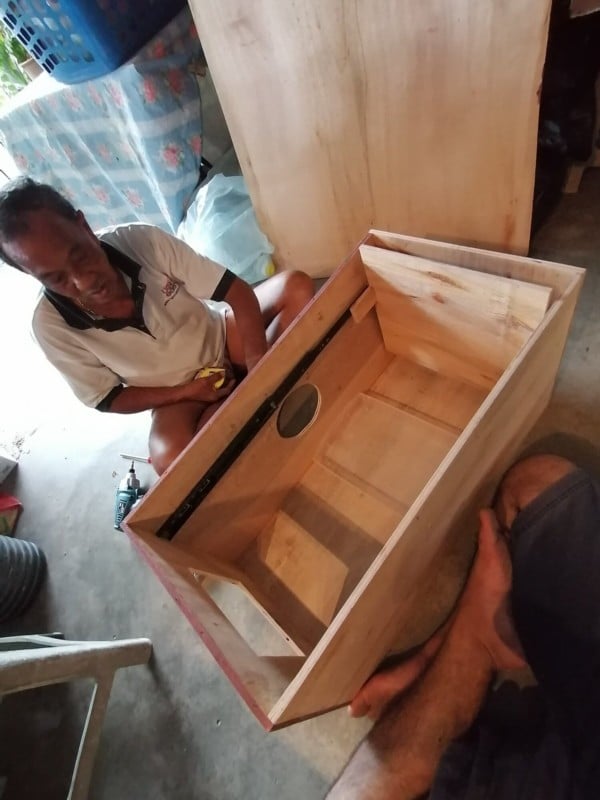

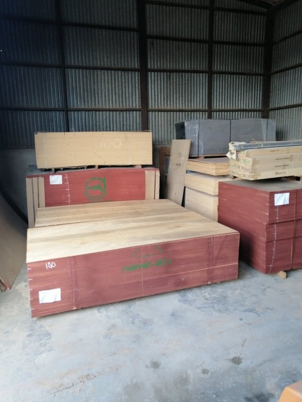

On the first day, we went out to buy the wood along with some additional materials. We bought a large piece of plywood from a construction company nearby and had it delivered an hour later. This day was mainly cutting the wood down to size and getting the necessary holes cut out.

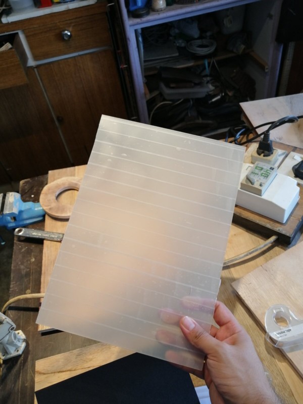

The second day of the build was a pretty big one. In the days leading up to day 2, I had tried to sand down two pieces of glass for the ground glass but ended up breaking one and just mildly scratching the other. I found a post on a forum where a guy used frosted tape on a sheet of clear glass as a replacement for a screen he had broken. I tested the idea and made myself a scotch tape viewing screen using the glass from a picture frame.
Scotch tape “ground glass”

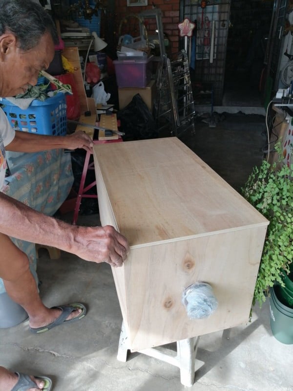

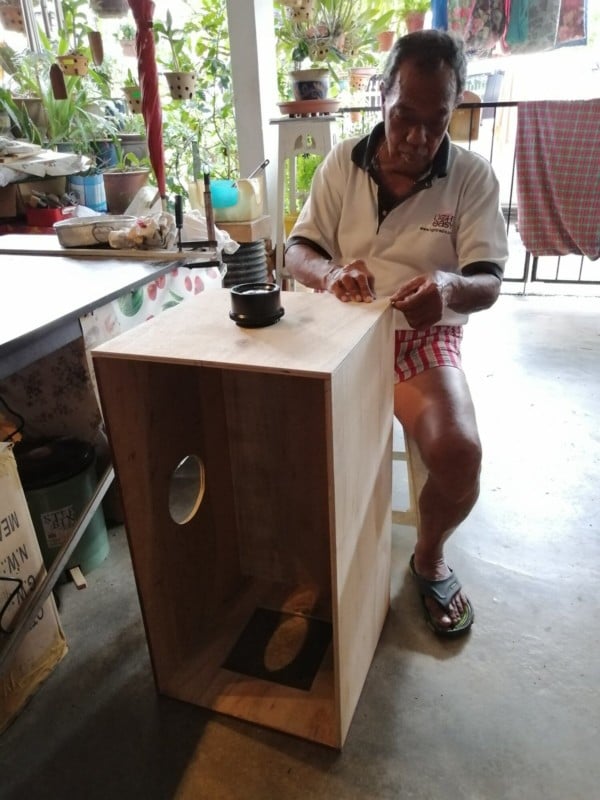

The rest of the day was spent mounting the lens, nailing panels of the box together and testing out the internal focusing mechanism. We opted to use drawer sliders for the focusing plate, rather than the traditional wood/metal rods. This was mainly because they were already in my grandfather’s spares box and the fact that it was a much simpler install. Later, I found that this also helped accessibility when moving the developing trays in and out of the camera.

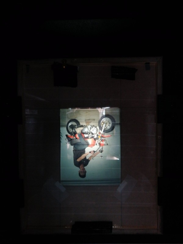

Once we finished setting up the rails, we were pleasantly greeted with the first image the box camera would produce, visible on the wood of the focus plate. It was a great thing to see.

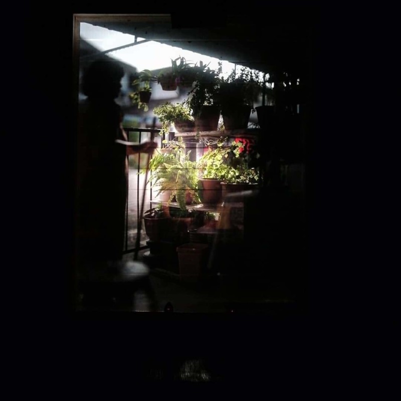

Once the “ground glass” was in, we could clearly see the lens’ resolving power at full scale. I had used ground glass before with my 4×5 but at this size it was stunning. Even though it was though a piece of glass and scotch tape!
The first signs of an image on the ground glass

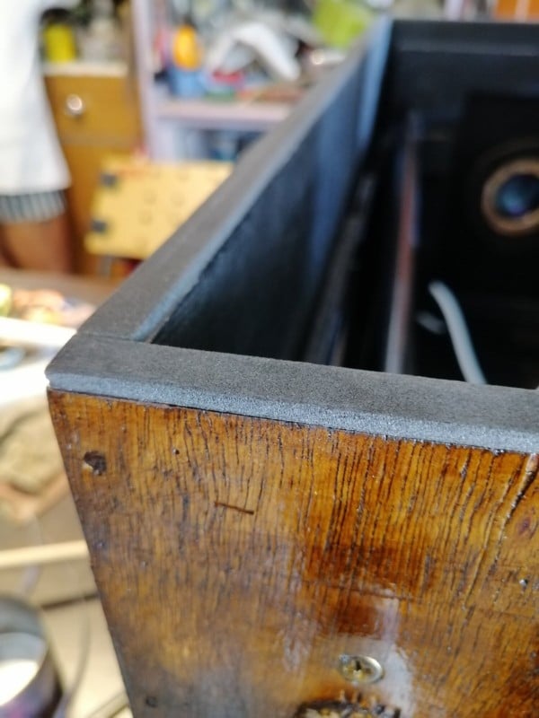

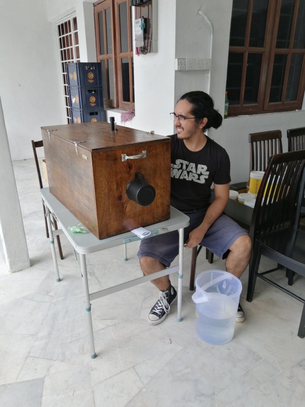

Day 4 was mainly just the finishing touches. My grandfather had attached the focus pole while I was away. After a coat of stain and varnish, we applied the foam seals that run around the lip of the lid as well as the rear door, making it a more light-tight.
Day 4½

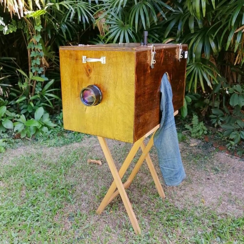

This was to add on a little peephole to visually check the development of the photograph. With a red filter on the back of the camera, I’m able to see into the box, without fogging the paper. I also cut out a matte for the 4×5 holder and installed a sleeve for my arm, which I made from an old pair of jeans.
The camera was now complete!

I didn’t have anyone around to photograph so, like many artists I decided to try my hand at still life first. I set up the camera outside, loaded the film and nervously took my first 4-second exposure. I opened the lid after a long couple of minutes and was relieved to find a nicely exposed piece of paper. The camera worked!
Human Trials
After the first success, I couldn’t wait to take a self-portrait. The only problem is the lens does not have a shutter, and I employ what I’ve heard being referred to as the “top-hat” method to make an image. So instead, I focused on a place holder (in my case a broom), loaded the film, and told my girlfriend to remove the cap for the metered 5-second exposure. She was bang on the money and it resulted in one of my favorite images of myself. Another success.
