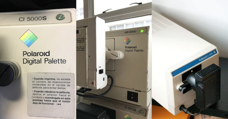

The Palette is a machine that combines a monochrome CRT screen, an RGB filter wheel, and a 35mm camera into a single package. The idea is to print a digital image onto a regular 24x36mm frame of 35mm film. The filter wheel is there to enable colour images (with three CRT passes).
There were other models, even one with a 4×5-inch back instead of a 35mm camera, but I never found one of those. All three that I had were fitted with a SCSI interface, and two also had a parallel port exclusively for PCs.

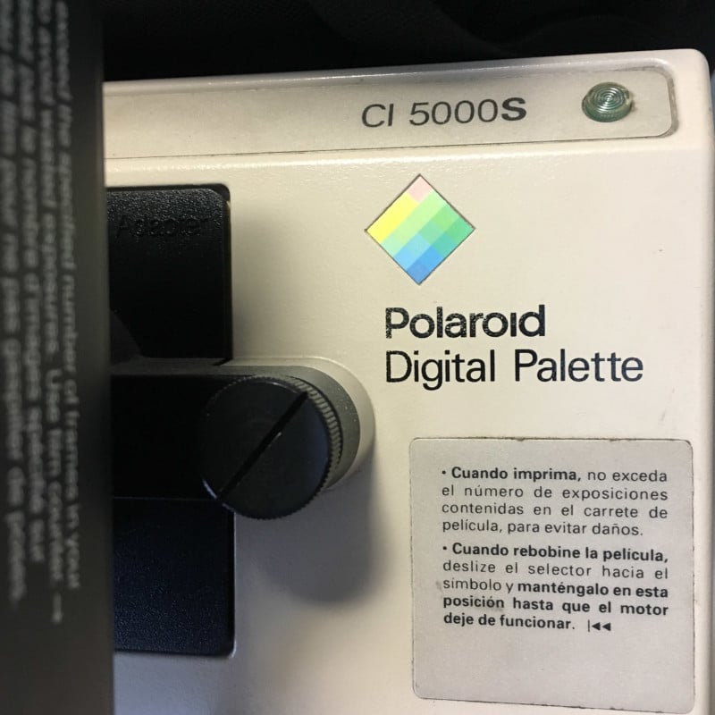

Palette #1
I found my first Palette in 2007, a CI5000. In this case, I got lucky: I had a bunch of SCSI cables that I’d also collected over the years of gleaning old computer equipment.
Its software wasn’t that hard to find either. I found a German website called Triber Update that still had the Mac OS9 files for most Polaroid products, so I installed the Palette Export driver on a Powermac G3 I had sitting around. The install consisted of simply adding the file to the Export folder inside Photoshop’s extensions folders.
The ReadMe file was very interesting: being a CRT projection, the Palette had to be away from other CRT monitors or anything that had a magnetic field in order to guarantee no distortion in the printed image. Anyway, I didn’t have a manual, that ReadMe was all the info I had on the machine.
When I opened the 35mm camera of the CI5000 it had sticker inside that read: CAUTION Do Not Touch the Shutter, but its focal plane shutter was already messed up because someone probably did touch it. Fortunately, I was able to put it back in place with a dentist tool. I connected it to power and green light came up and held steady. I loaded some colour film I had. I opened an image in Photoshop 5, got to the interface, and hit print.
A progress bar moved along steadily, but the Palette remained silent. For a couple days I tried a lots of ideas, but nothing I did could change this behaviour. One down, two to go.

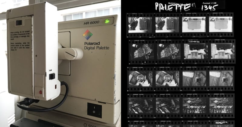

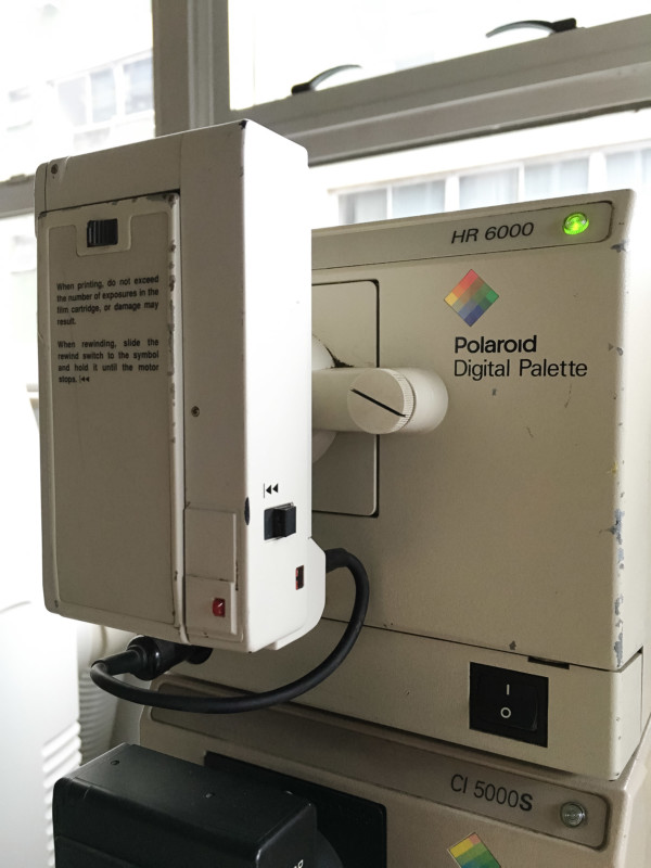

It was about one year later when I found myself another Palette. This time it was an HR6000.
This one was really covered in dust and took a lot of work to get it clean, but once I got it plugged up it turned on and connected to the same software right away, so I loaded some TMax 100 into its camera.
My first attempt resulted on a warning message: CRT intensity too low. It is very easy to remove the camera from the Palette without releasing any cables, just a couple screws, so I checked and found that the CRT was on. Who would have guessed that a 15-year-old CRT could still produce a faint image.
I looked around a bit and eventually found a checkbox that let the thing ignore low intensity warnings. My guess is that the software engineers at Polaroid figured out this trap of frustration that the hardware engineers had setup for users in the future. Bless them.
So I got to print my first frame with a Polaroid Palette… and it… took forever. For the second one, I removed the camera to look inside and see exactly how it worked. It turns out that it takes such a long time because the image is projected on the CRT line by line, not filling the entire CRT area at once.
After I had it all tested, I forced film rewind and developed the roll to check the images.

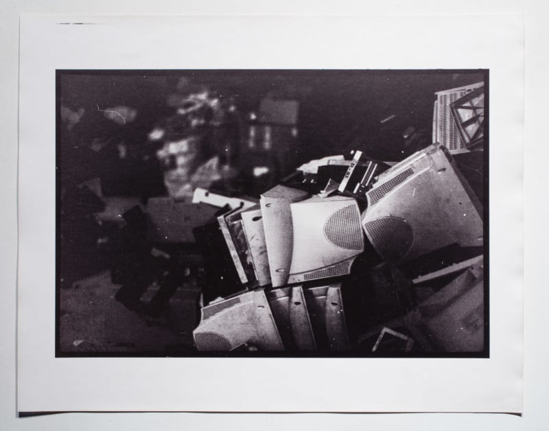

Resolution is low for a negative and (looking back) maybe TMax 100 was not the best choice, since it out resolves the image showing every detail of the CRT lines. Shadow detail suffered a bit in the final image, but highlight detail was very good, so I decided that the next images I used would be more compressed, with less black—not a very scientific solution, but a solution all the same.
So, with another roll of TMax 100 ready, I printed images I had of the electronic garbage, and some other images of computer parts left on the streets of São Paulo. For each one, I would open the Curves command and moved the bottom of the curve to 30, make one frame, then move it to 60 and make another. This made pairs of negatives, at least one of which I considered usable at the time.
I made some trial prints onto Kodabromide F-3 single weight fiber based paper I had, which was maybe too contrasty for those compressed negatives.
Ultimately, I didn’t like the texture the CRT image gave to the prints, so I left the print file containing these negatives in a box labeled PRINT inside my darkroom, along with other things I couldn’t find the final look for yet, and let some years go by.

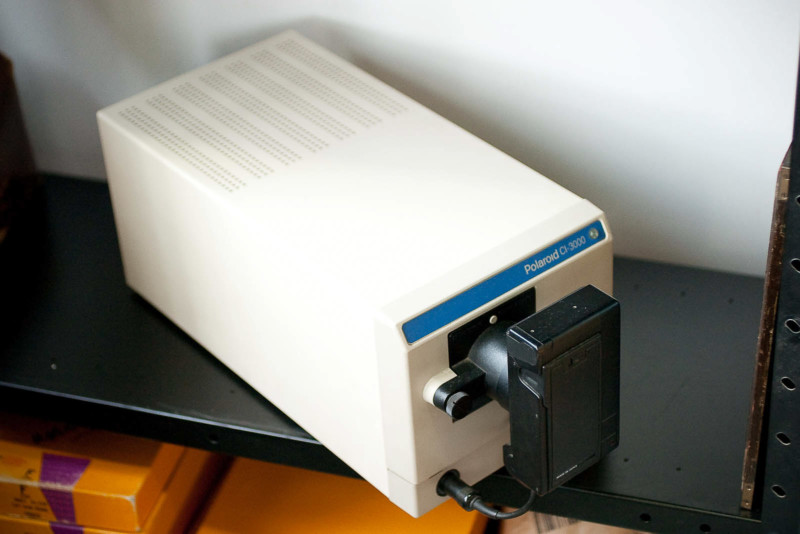

Fast forward to 2016. I finally decided to try again after I found another Palette that didn’t work: this one a CI3000.
I had just edited some images shot on my first iPhone, and I figured it was interesting material with which to make some B&W wet prints. So I made all these images B&W in Lightroom, and did all the toning and retouching I felt necessary.

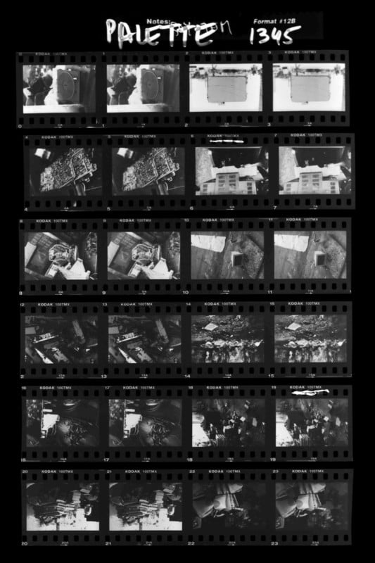

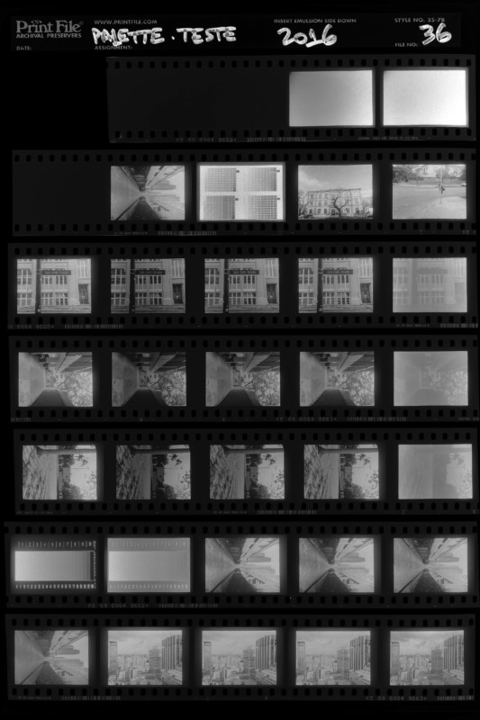

This time I chose Kodak Double-X movie film—I had already realized that grain would save the day. I planed a large test to figure out how to expose my images.
My first two images were just gradients from black to white to get a feeling of the curve. Then I tried some B&W images in RGB mode with different film presets contained in the Palette software.
I was worried the RGB filters and the overlapping of three images on film would deteriorate the resolution, so I deleted some channels in some images and tried that approach. Then I decided to print some step wedges just to see what would happen, and one of the step wedges I had was a grayscale file… this turned out to be a saving grace: this time the software offered me some presets for B&W films, and printed without the filter in a single pass.
Success, totally by accident, without a manual.
So I converted two more images to B&W and printed each photo using all four of the B&W film presets available in the software.

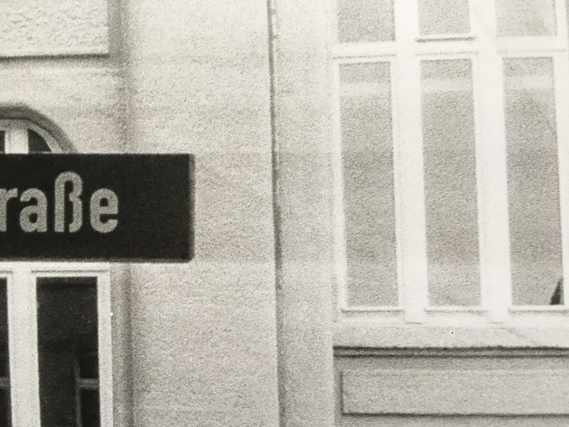

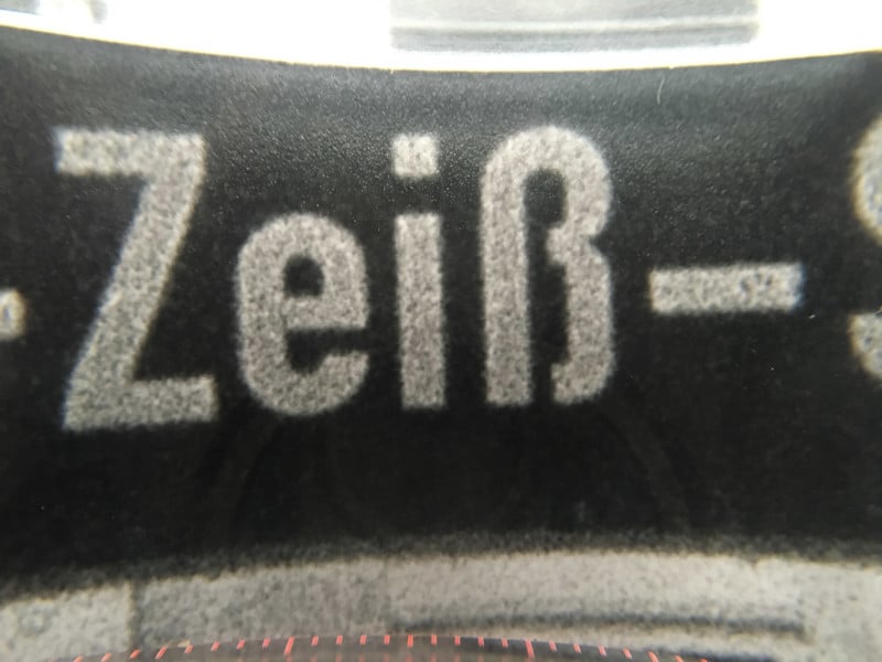

The negatives looked very good right out of the fixer, but on close inspection there were some artifacts: some shadows extending sideways on the image. I really liked the Kodak Double-X solution. The edges are soft, but the grain gives the image a kick and solves the texture problem—in the enlarger, getting the grain in focus gives the image the necessary texture. If it wasn’t for the artifacts, you could barely recognize the source of the image… it might be just a really bad lens.

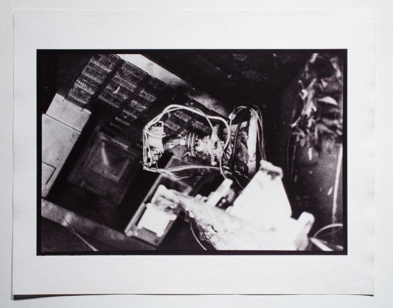

My Carl Zeiss Strasse image, from the green channel negative, looked really good on 12×16-inch paper, the tone transition in particular was very good given the source. From a distance, you could sense the image texture and how the street sign was in focus and the background slight of. It has depth.
The sideways shadow was interesting, something I could explore in another set of images, but maybe not these ones. It made me cherish the early Kodabromide F3 prints more, and helped me accept them as they are.
