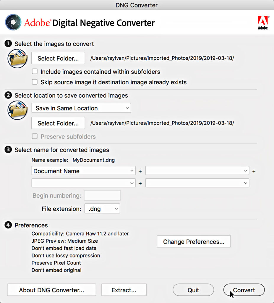

There’s a Read Me (PDF) file linked from the download page for the DNG converter that goes through the steps for installing and using the software, but there really isn’t much to it. In fact, the interface itself literally steps you through the process of selecting the folder containing the photos you want to convert through clicking the Convert button when you are ready to go.
Once the DNG files are created, you can bring them through the normal import process into Lightroom.

It’s also worth noting that if you should ever choose the option for embedding a copy of the original raw photo in a DNG when converting that you can use this same DNG converter for extracting the original raw photo out of the DNG file. Just click the Extract button at the bottom of the dialog to open the Extract options. I don’t know anyone who chooses that option, but now you know.
