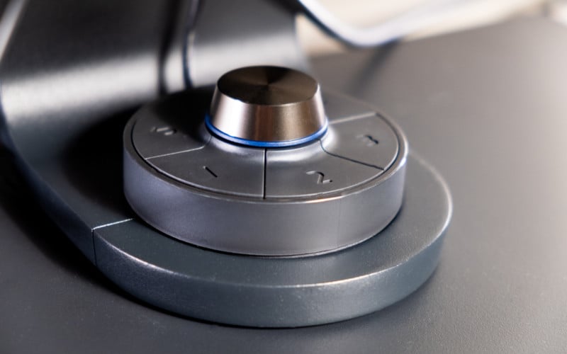

The one change in design is the addition of the second generation “Hotkey Puck G2,” which is a big improvement on the G1. It keeps the same three programmable buttons on the outside—set by default to AdobeRGB, sRGB, and Black & White mode—an input button, and a “back” button, but adds a mechanical dial with its own click mechanism to the center. That dial’s rotation can be set to control the display’s brightness, contrast, or your computer’s volume, while the center button can be set to toggle color spaces, inputs, or mute.
I’ve owned a BenQ SW2700PT for over 2 years, and rarely use the included Hotkey Puck G1, but since receiving the SW271C for review, I’ve been using the G2 consistently to switch color spaces, adjust brightness, and toggle between inputs when I have both my Mac mini and a laptop connected to the display at the same time.

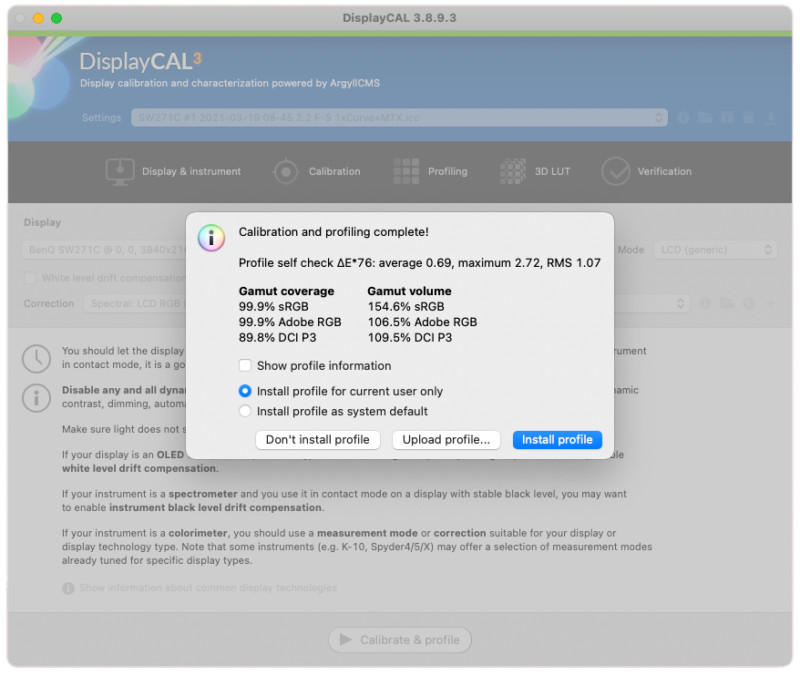

Testing the BenQ SW271C with an X-Rite i1Display Pro Plus in both i1Profiler and DisplayCAL, we were able to confirm 99% coverage of AdobeRGB, 90% coverage of DCI-P3, and 100% coverage of sRGB for this panel. Notably, that’s actually a lower spec for DCI-P3 coverage than the old SW271, but BenQ tells us that it made this trade-off on purpose, saying that “though this panel has slightly lower DCI-P3, it has greater color and uniformity performance.”
We were also able to confirm BenQ’s claims that this monitor boasts a Delta E of less than two in pretty much every color patch we could test. Using the new Delta E 2000 standard, the monitor records a maximum Delta E of just 1.51; using the older (but often referenced) Delta E 1976 standard, two patches peak over 2.5, but nothing ever got close to 3.
Less than one is the dream, but anything less than two is considered outstanding, as it’s nearly impossible to detect with the human eye.
The monitor’s brightness uniformity was also impressive. We measured a Delta E of four or less across the board on i1Profiler’s uniformity test and got very similar results from DisplayCAL. We can’t comment on whether this is an improvement from the 2nd Generation Uniformity Tech in the original SW271, but it does seem that the SW271C scores high marks despite using edge-lighting instead of the more expensive direct backlight you’ll find in some higher-end monitors.
