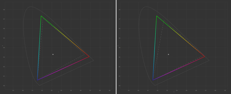

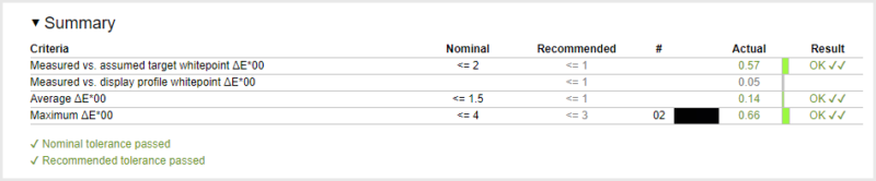

In our testing, the ASUS ProArt PA32UCG covers 99.9% of AdobeRGB (left) and 94.4% of DCI-P3 (right).
The ASUS ProArt PA32UCG takes a slightly different approach to color than other high-end HDR monitors. Most other DisplayHDR 1000+ monitors know that their primary target market is video editors, and so they prioritize the DCI-P3 color gamut. Coverage of AdobeRGB drops off as a result, leaving you with a good monitor for video editing that’s may not be suited to photography/printing workflows.
The ProArt PA32UCG flips the script. In our testing, the monitor was able to cover 99.9% of AdobeRGB and 94.4% DCI-P3 with a maximum Delta E 2000 of just 0.61. That’s a tiny bit worse than the advertised DCI-P3 coverage of 98%, but it’s an exceptional result that puts it far ahead of both the Apple Pro Display XDR (100% DCI-P3 and 89% Adobe RGB) and the Dell UP3221Q (100% DCI-P3 and 94% AdobeRGB) if you’re editing photos instead of video.
It’s also just plain rare that we see a monitor with a Delta E that’s this low.

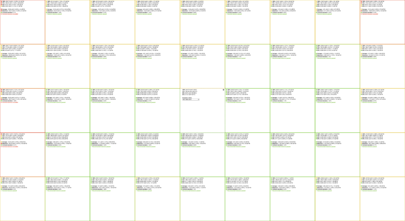

Unsurprisingly, uniformity was also solid. Although it can’t compete with the most intense photo editing monitors out there from companies like NEC and EIZO, every patch in our 9×5 uniformity test passed “nominal” tolerance once Uniformity Compensation was turned ON in the menus. With Uniformity Compensation turned to OFF, a few more of the center patches were able to pass the more stringent “recommended” tolerance, but four of the patches around the edge dropped below “nominal” tolerance, so we would recommend leaving this setting turned on.
You can see the results of this test, both with and without Uniformity Compensation, below (click to enlarge):
Uniformity test results with Uniformity Compensation set to OFF.
Uniformity test results with Uniformity Compensation set to ON.
