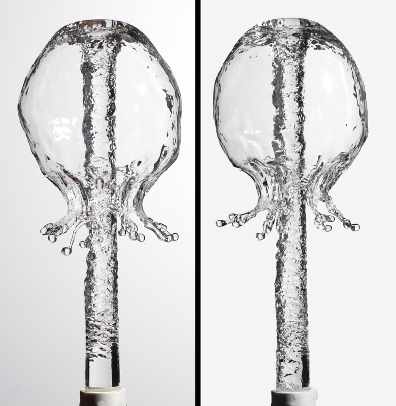

Each year I update experiments in the collection of the High-Speed photography lab at Rochester Institute of Technology (RIT). One of this year’s additions is an air-powered water bell.
In this experiment, air pressure is used to push a column of water vertically. The top of this column of water falls back on itself as the bottom of the column is still rising. This creates two masses of water that collide in the air. The resulting bell is created by the falling column of water being forced into a bell shape by the opposing column of water.
Recently, this type of system has come to my attention by its use in several advertisements. The build for this device is very simple and inexpensive assuming that you have access to a small shop air compressor.
The air compressor has a built-in regulator that is set to 35 psi and I use a 12V DC Normally Closed air valve. Since the air valve has to be precisely controlled, I use an Arduino to make a voltage pulse to open the valve. In the image above, the air valve was open for 65 milliseconds.

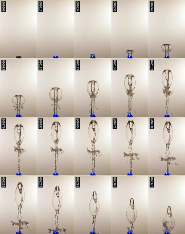

Above is a typical sequence of shapes from the water bell system. Imaged with a Chronos camera running at 1057 frames per second (www.krontech.ca). The blue LED light at the bottom of each frame is an indicator that turns on when the air valve is opened. The start of the blue light is a reference for timing with the microprocessor. Between each of the images above is 16 ms. This full sequence covers .305 seconds. The largest the water bell forms in this sequence is about 12 cm in diameter. In this sequence, the air valve was open for 75 ms. and the compressor was set to 35 PSI.

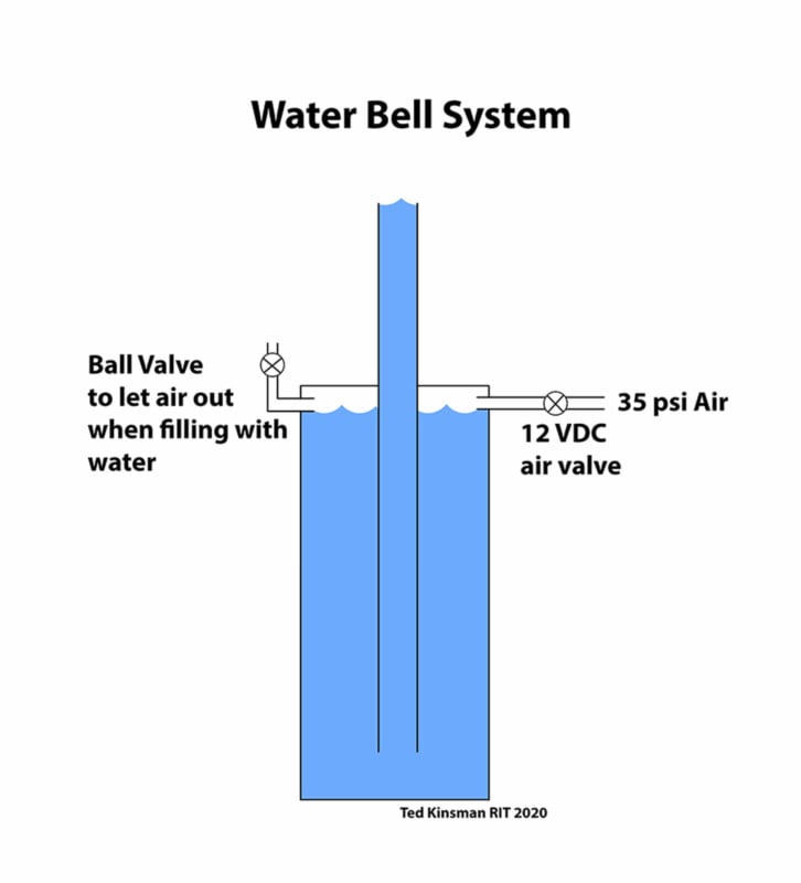

Here the PVC piping is shown in cross-section. The air valve on the left is an air solenoid valve controlled by 12 VDC. The voltage for the switch is controlled by a simple reed switch controlled by an Arduino microprocessor. The reed switch supplies electrical isolation between the 12VDC supply and the Arduino. The reed switch also actuates in 60 microseconds so it does not affect the characteristics of the system. The ball valve on the left allows the air to leave the large cylinder when water is topped off in the central smaller cylinder.
Various water bell tubes. The center tube was used for the images in this paper and measures 29 inches high. The large pipe is 4 inches in diameter and is 17 inches high. The center tube is 1-inch diameter PVC and starts 1.5 inches above the bottom and extends to 29 inches above the table. The center system has an extra cap glued to the top for stability. There are numerous ways of combining PVC fittings to making these systems.
Standard Air Solenoid valve (air valve) works on 12 VDC

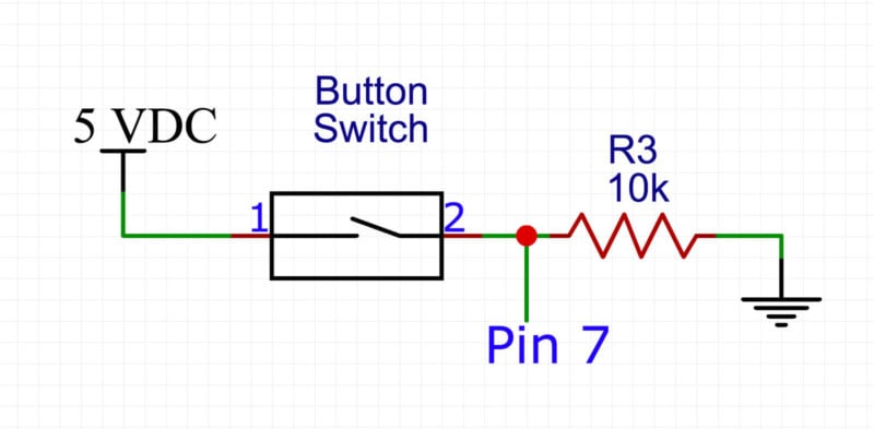

Here is the schematic used to trigger the system when the push button is pressed.
