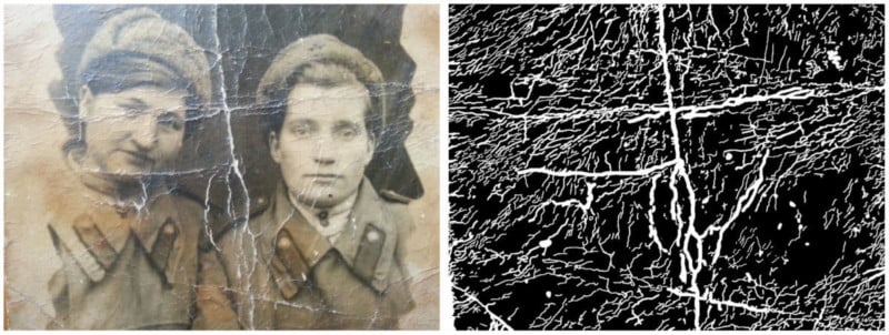

Then we had to collect a training set. The training set for a segmentation task is an image and a mask where all the defects are marked. The easiest way to do it is to let the assessors create the segmentation masks. Of course, people know very well how to find defects, but that would take too long.
It can take one hour or the whole workday to mark the defect pixels in one photo. Therefore, it’s not easy to collect a training set of more than 100 images in a few weeks. That’s why we tried to augment our data and created our own defects: we’d take a good photo, add defects using random walks on the image, and end up with a mask showing the image parts with the defects. Without augmentations, we’ve got 68 manually labeled photos in training set and 11 photos in the validation set.

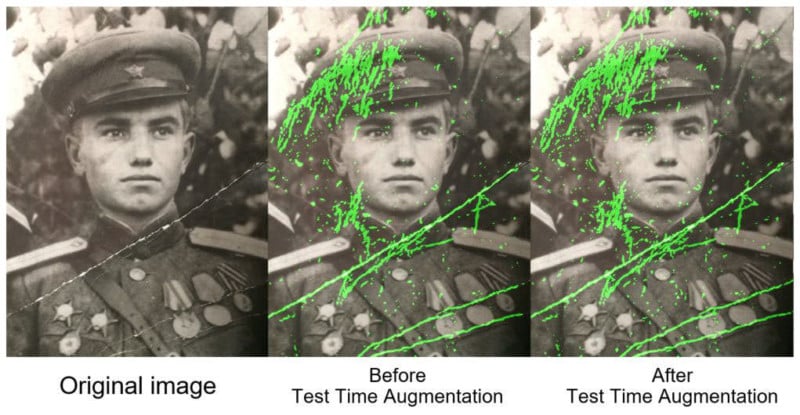

Finally, upon increasing BCE weight, changing architecture, and using In-place BatchNorm, we made the segmentation better. However, it wouldn’t cost too much to do something even better by adding Test Time Augmentation. We can run the net once on an input picture, then mirror it and rerun the net to find all the small defects.
The net converges in 18 hours on four GeForce 1080Ti. Inference takes 290 ms. It’s quite long, but that’s the price of our better-than-default performance. Validation DICE equals 0,35, and ROCAUC — 0,93.

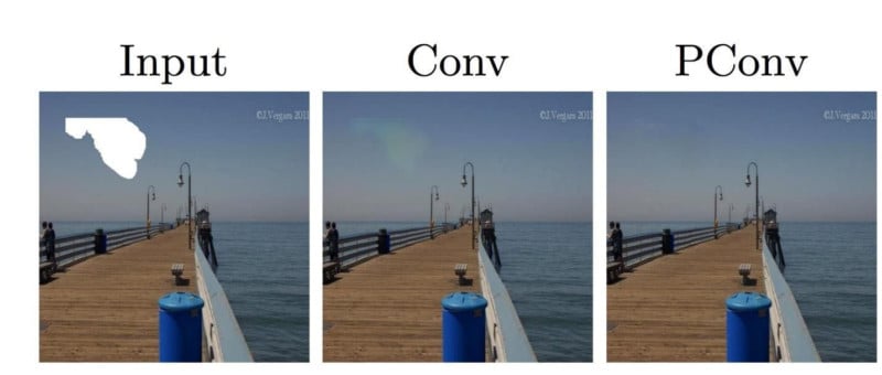

We can use partial convolution instead of an original one. The idea is that when we convolve an area with some kernel, we don’t take the defect pixels values into account. This makes the inpainting more precise. We show you an example from the recent NVIDIA paper. They used Unet with a default 2-dimensional convolution in the middle picture and a partial convolution – in the picture on the right.

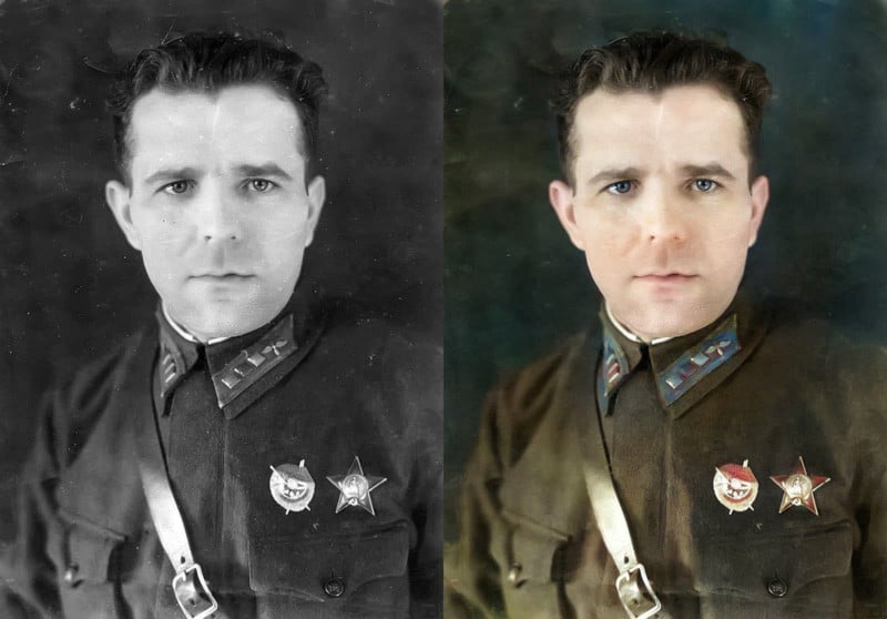

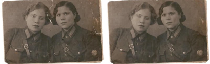

Here is the example of how our algorithm works:

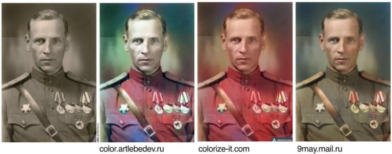

GitHub has a popular repository for photo colorization. It does a good job but still has some issues. For example, it tends to paint clothes blue. That’s why we rejected it as well.

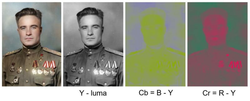

So, we decided to create an algorithm for image colorization. The most obvious idea: take a black-and-white image and predict three channels: red, green, and blue. However, we can make our job easier: work not with RGB color representation, but with YCbCr color representation. Y component is brightness (luma). An uploaded black-and-white image is Y channel, and we are going to reuse it. Now we need to predict Cb and Cr: Cb is the difference of blue color and brightness and Cr – the difference of red color and brightness.
Why did we choose YCbCr representation? A human eye is more sensitive changes in brightness than to color changes. That’s why we reuse Y component (brightness) which a human eye is most sensitive to and predict Cb and Cr that we might make a mistake with since we can’t notice color falsity very well. This specific characteristic was widely used at the dawn of color television when channel capacity wasn’t enough to transmit all the colors. The picture was transmitted in YCbCr, unchanged to the Y component, and Cb and Cr were reduced by half.

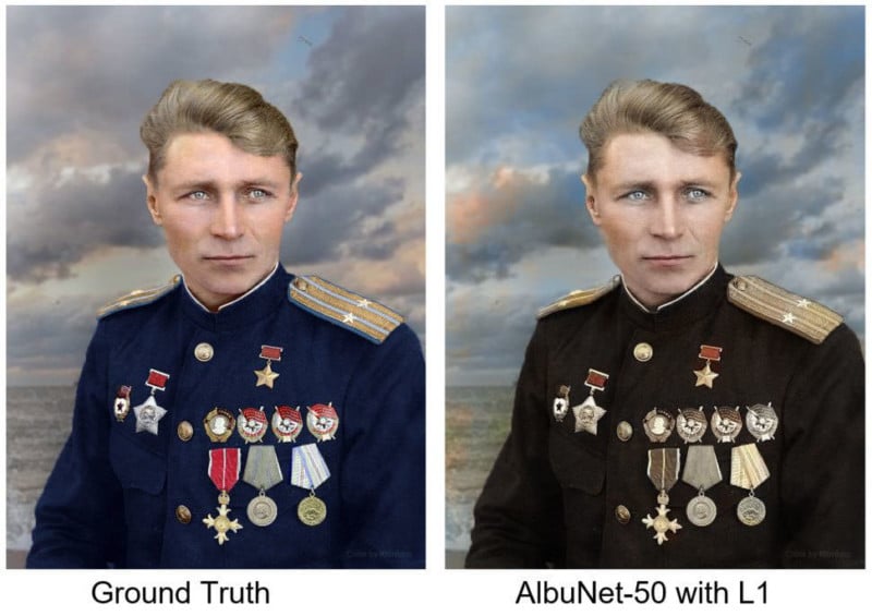

We trained AlbuNet-50 – it’s a Unet that uses pretrained ResNet-50 as an encoder. The net started to give adequate results: the skin was pink, the eyes – gray-blue, the shoulder boards – yellowish. However, the problem was that it leaves some areas on photo untouched. This was caused by the fact that according to error L1 find such optimum where it’s better to do nothing than trying to predict some color.
We are comparing our result with a Ground Truth photo — a manual colorization done by Klimbim

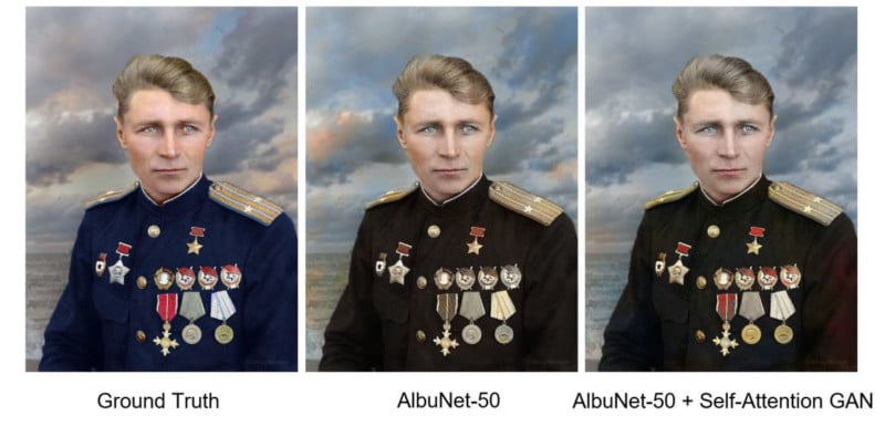

How can we solve this problem? We need a discriminator: a neural network that would receive an image and tell us whether it looks realistic or not. One of the pictures below is colored manually and the other – by our generator, AlbuNet-50. How does human distinguish manually and automatically colored photos? By looking at details. Can you tell where the automatically colorized photo by our baseline solution is?
Answer: the picture on the left is colored manually, on the right – automatically.
We use the discriminator from the Self-Attention GAN paper. It’s a small convolution net with so-called Self-Attention built in the top layers. It allows us to “pay more attention” to the image details. We also use spectral normalization. You can find more information in the abovementioned paper. We’ve trained the net with a combination of L1 loss and a loss from the discriminator. Now the net colorizes the image details better, and the background looks more consistent. One more example: on the left is the work by net trained with L1 loss only; on the right – with a combination of L1 discriminator losses.
Training process took two days on four GeForce 1080Ti. It takes the net 30 ms to process a 512 x 512 picture. Validation MSE – 34.4. Just like with inpainting, metrics you don’t want to rely on metrics. That’s why we picked six models with the best validation metrics and blindly voted for the best model.

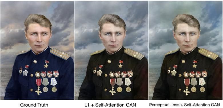

When we’ve already created a production system and launched a website we continued experimenting and concluded that we better minimize not per-pixel L1 loss, but perceptual loss. To calculate it, we feed the net predictions and a ground-truthl photo to VGG-16 net, take the feature maps on the bottom layers and compare them with MSE. This approach paints more areas and gives more colorful results.

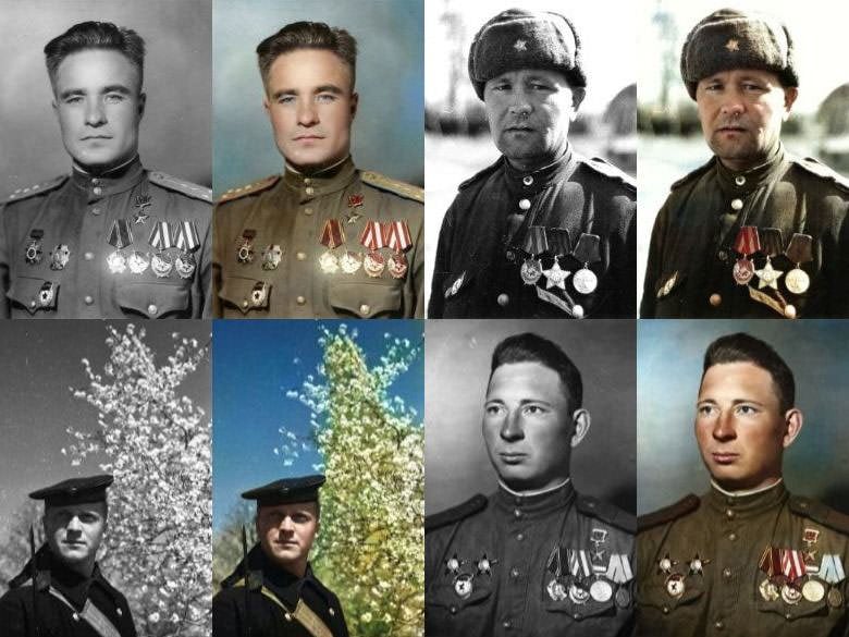

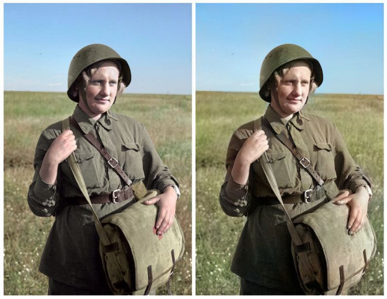

We took some pictures from the War Album project and processed them over these neuronets. Here are the results we got:
Moreover, here you can take a closer look at the original images and all the processing stages.
