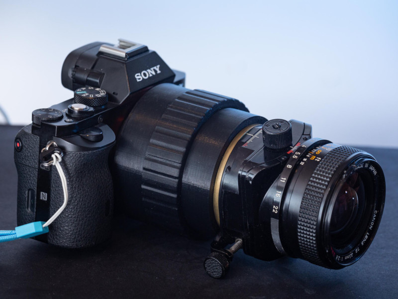

The tube, which extends from 0 to 35mm, allows Sherlock to use his 14mm and 35mm wide-angle Canon EF/EF-S DSLR lenses on his Sony mirrorless camera and focus those lenses from infinity all the way to 1x magnification.
The tube at minimum 0mm extension.

The 3D-printed tube weighs in at just 95 grams (~3.35oz), making it easy to use for long stretches of time.
“I’ve focused on creating a lightweight rig so I don’t have to be a strongman to shoot for longer than 5 minutes,” Sherlock says. “The printed tube is 95 grams, and my Sony a7R mirrorless camera is much lighter than my previous Canon 5D Mark III.”
The design takes advantage of the 26mm difference between Canon DSLR deeper lenses and Sony’s mirrorless camera mount.
“This means that as long as my tube collapses down to 26mm or shorter, it has an effective minimum extension of 0mm, so the lenses can still focus to infinity,” Sherlock writes. “At max extension, a 35mm lens will reach 1x magnification.”
