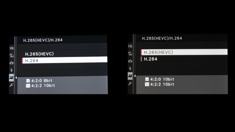

An easy way to identify what codec you are using by looking at the LCD

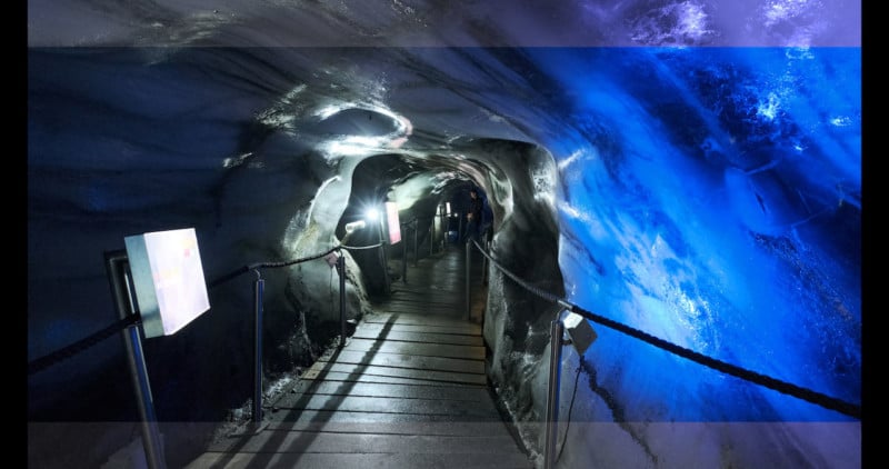

Fujifilm X-T3 at ISO 8000. On top and bottom of the picture, an ungraded parts

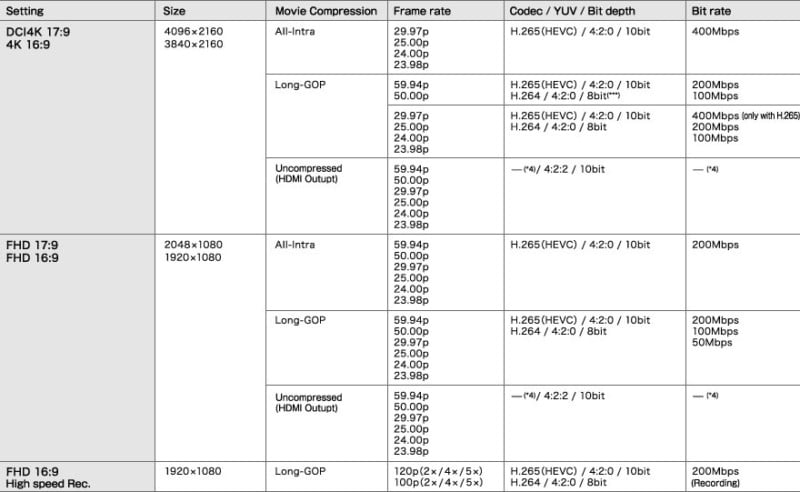

- (Besides the H264 codec), the camera is now equipped with a new H265 codec (When a manufacturer decides on implementing 10-Bit internal recording and yet at the same time stick to a modestly priced recording media, H265 is the obvious choice)
- A choice between two different types of compressions. Long GOP/ALL Inter
- 4K, 10-Bit, ALL Intra, 4:2:0, 400Mbps internal recording (Up to 30p)
- 4K/60p (in H264 mode), up to 200Mbps
- External 4:2:2 10-Bit recording via HDMI
- Excellent autofocus system (Working well in lowlight conditions and slow-motion too). In addition, “Eye detection/Face detection” focusing method is functioning in video mode too
- Zebra pattern
- Simultaneous support for 4K/60P 4:2:2 10-Bit HDMI output and 4K/60P 4:2:0 10-Bit internal SD card recording

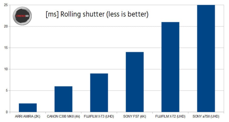

- Good Rolling Shutter performance. We have measured 9ms in 4K/25p recording mode, placing the camera above Fujifilm’s own X-T2

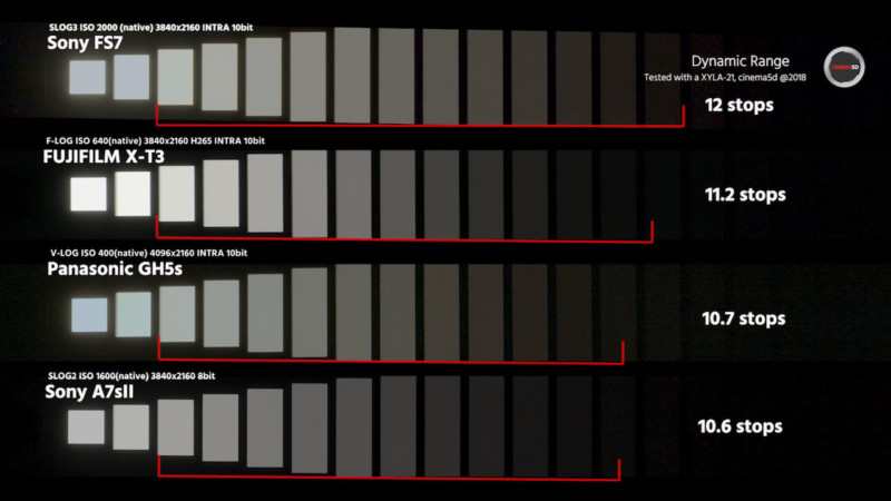

- Good Dynamic Range. With 11.2 stops of DR, this little camera is doing rather well against its competitors.

- Full HD now supports double the data rate of the X-T2 and X-H1 (200Mbps vs 100Mbps)
- No sensor crop factor when shooting in 4K mode up to 30p. When Shooting 4K/50/60p the crop factor is 1.18X

Dynamic range comparison
Rolling shutter chart. The X-T3 is doing well!
