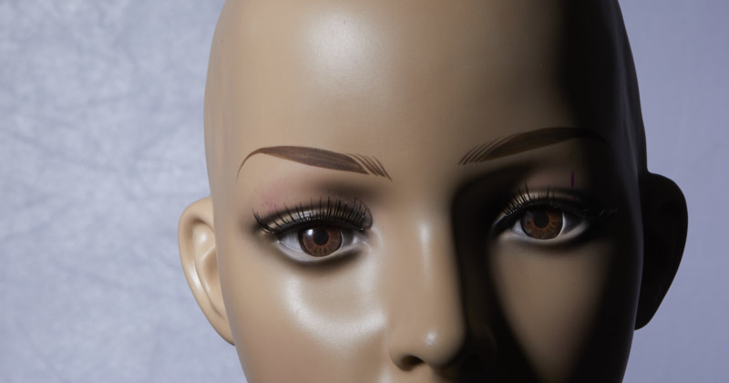

Broad Light
A portrait lighting pattern where the whole face is lit evenly. The light direction is hitting the cheekbone.

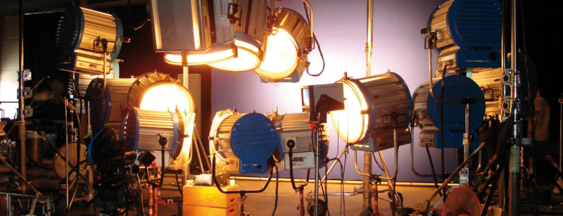

Continuous Lighting
Light source that has constant output over time e.g. a tungsten 3200W light. Commonly used in video. Strobes feature a high but not constant output of light.

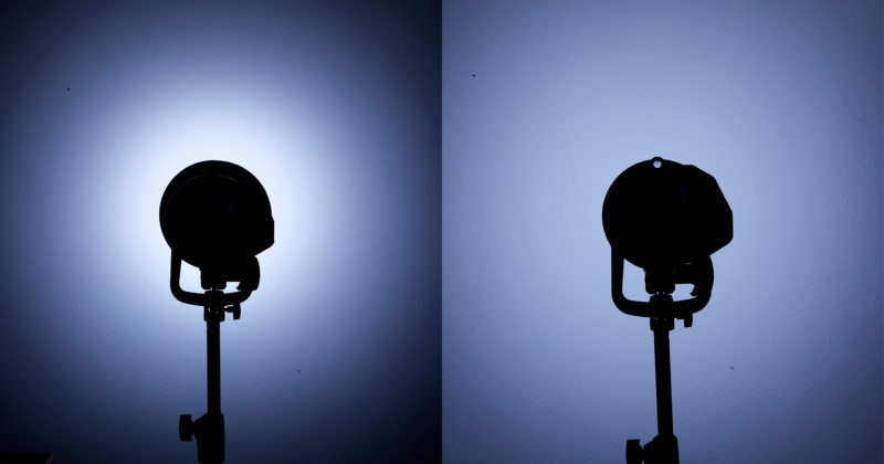

Hotspot
Part of the surface that is significantly brighter than the rest. Commonly used with softboxes that have a hotspot in the center.

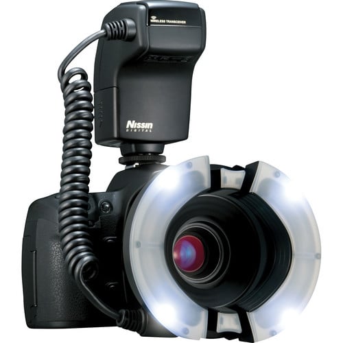

Ring flash
A special flash that mounts around the lens and creates even light that doesn’t cast visible shadows.

Short light
A portrait lighting technique where the front of the face is bright while the cheeks remain dark. The light direction is hitting the face.

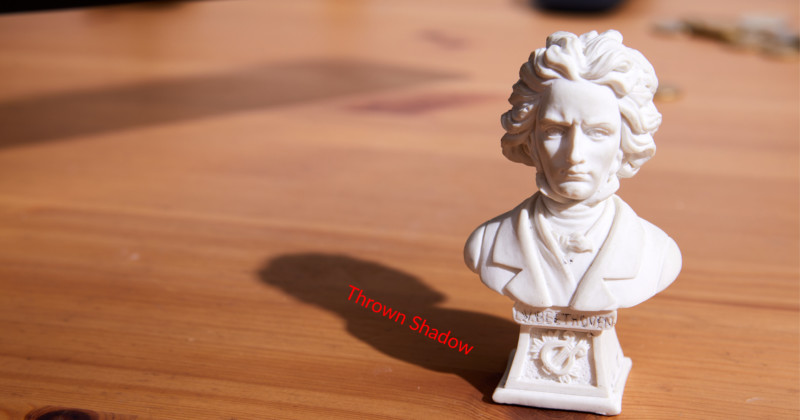

Thrown Shadow
A shadow that is cast by an object to a different surface, e.g a shadow on the table from a cup.
