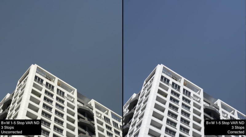

Now we’re going to pull up our first filter here. It is the B&W 1-5 stop variable ND. The image on the left is uncorrected with the filter and then the image on the right we’ve eye dropped that same spot again to adjust it. This is 1.3 stops, which is the minimum on the B&W filter. So it’s pretty accurate. It corrected back really nicely. It’s a beautiful clean image. The blue is wonderful. It didn’t lose the contrast too much. So it actually looks great. But how does it look now if we go to three stops?
At three stops in the uncorrected image, you see the color start to wash out a little and there’s some weird shading going on. You’re starting to see that cross-hatching develop. But once you correct it, it actually doesn’t look bad. It’s a little shadowy and a little bit desaturated. It’s not amazing. It’s okay.
Then at five stops it actually looks better in my opinion at five stops then at three stops. Even though we did have to correct it a bit more. We see a little darkness in the lower right corner and lightness light in the sky. It shifted 450 degrees K and plus 10 magenta. It really looks better at 1.3 stops or up to five stops.

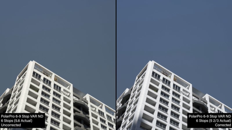

So let’s go to the Polar Pro. This is the one I’m already really invested in. So I was hoping that it would do great. We will let you be the judge. The minimum is 1.3 stops. It looks great corrected. It actually looks almost identical to the original. It shifted 300 degrees Kelvin and plus 10 magenta. But it easily corrected and looks good.
But then after that it turns kind of ugly. It gets muddy looking in the middle, and this is at three stops here.
At five stops it seems like the colors just got desaturated. So even though we correct it with the white balance, but the color is gone. It was that really. So the Polar Pro at 5 stops shifted minus 300 K plus 9 magenta. But that’s not the issue. The issue is that it just became very desaturated and muddy looking.
The 6 stop mark on this filter is actually delivering 5.6 stops of filtration and then the nine stop mark is delivering 7.3 stops with filtration. So it doesn’t actually filter out as much light as it advertises, which is kind of a disappointment. The color shifting at the minimum setting is still kind of bad. The 6 stop mark is not as bad as the last one was. It’s minus 400 degrees K, 6 magenta. It’s a little desaturated. It’s not quite as bad but feels kind of muddy again to me.
But then at the 9-stop mark or 7.3 stops it clears up. And actually, it looks pretty good. So if you’re using this combo of lenses, it works really well at the minimum, like the one-stop and the seven-stop end.
But in between really messes around with the color. The disappointment here for me is it’s not filtering nine stops of light.

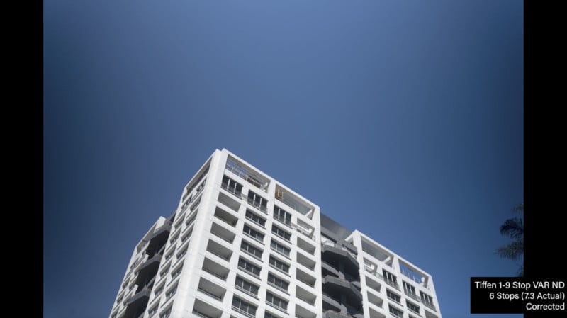

All right, here’s the Tiffin 1-9. It actually is not bad for being the cheapest option. I think at the 1 stop it’s really about 1.6 stops. At that end, it looks super clean with hardly any effect to the image.
Then we go to 3 stops and it is pretty good, still really clean.
We shot this to 7.3. I think this is probably as far as I felt comfortable pushing it. I felt like this is the max. It doesn’t go to nine because nine doesn’t work.
I would back off of this. I would probably just keep it at 6 stops.
It has the cleanest color this shift. It shifted minus 350 or 250 K. So it didn’t shift that much. But you just start getting that vignetting so early.
