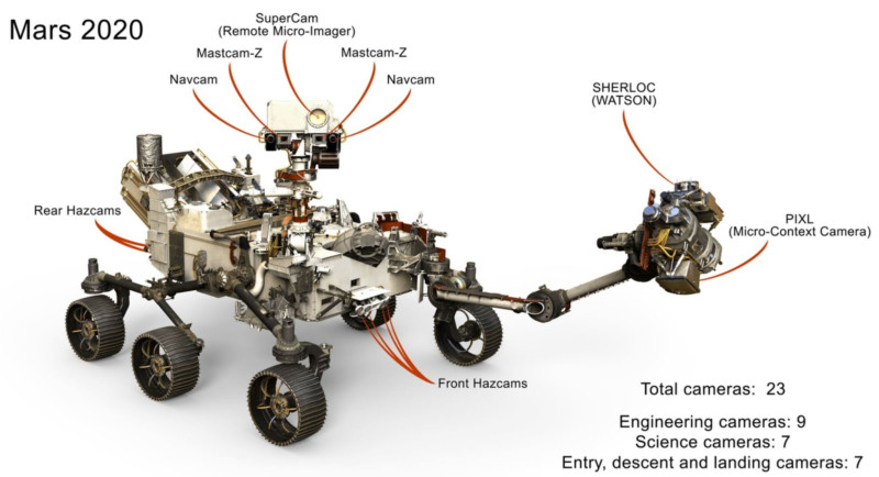

The diagram below shows an approximation of where the many different cameras are on the rover. There are nine engineering cameras, seven science cameras, and seven entry, descent, and landing cameras. Included in this batch is the Mastcam-Z, possibly the rover’s most impressive camera.

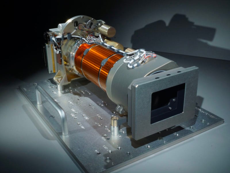

The two identical cameras (except for small differences in the color filters) that make up the Mastcam-Z camera system are mounted about 2 meters (6.5 feet) above the surface, on the rover’s Remote Sensing Mast separated by 9.5 inches to provide stereo vision.
Image credit: NASA/JPL-CALTECH

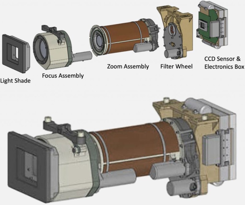

“Each camera consists of four major subsystems: A digital CCD sensor and electronics box, an 8-position filter wheel, a multi-lens zoom assembly, and a single-lens focusing assembly,” the Mastcam-Z’s description reads. “A short light shade helps reduce scattered light in the optics. A separate Digital Electronics Assembly is mounted inside the rover, and two calibration targets are mounted on the rover deck.”

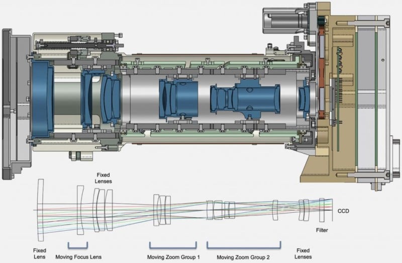

Below is a cross-sectional CAD view and ray-trace diagram of the Mastcam-Z optics. You can see two small motors that drive the zoom and focus mechanisms.
Below is a CAD animation and cross-sectional view of the focus mechanism in action:
Mastcam-Z can zoom from wide-angle to telephoto and take photos in up to 11 unique colors. It shoots in a 1600×1200 pixel range and can zoom from 26-110mm as well as rotate a full 360-degrees. The camera has a maximum aperture of f/7 at the wide end and f/10 at the telephoto end.

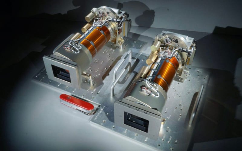

For a sense of scale, NASA uploaded an image of the two sides of the Mastcam-Z camera next to a pocket knife:
Image credit: MSSS/ASU
