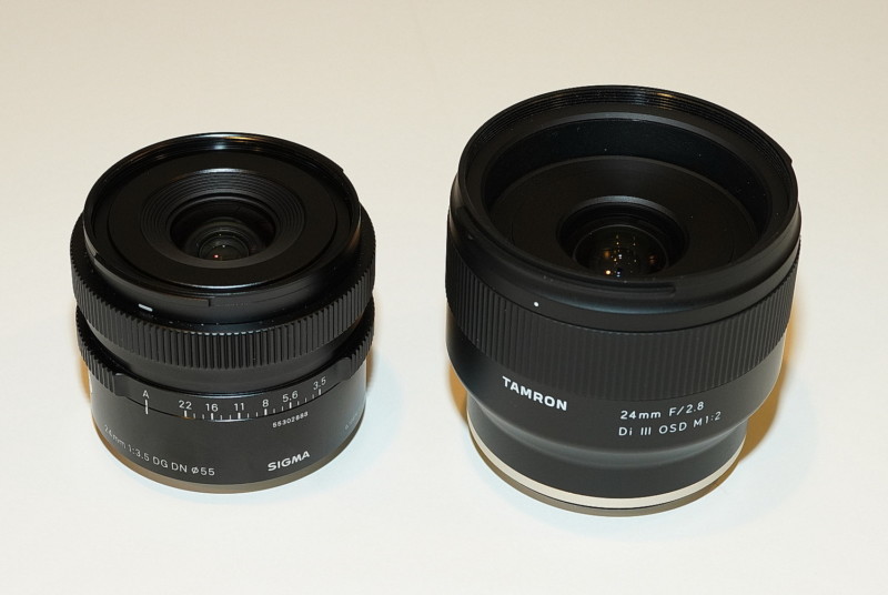

My favorite “walking around” and landscape focal length is 35mm equivalent. I have some 24mm lenses which approximate that field of view on my APS-C camera. One is the Tamron 24mm f/2.8. But despite its great resolution, it is slow to focus and pretty large. So after being very pleased with my Sigma 45mm Contemporary, I decided to give their new 24mm version a try. I’m glad I did.
Although I plan to use it mostly on my APS-C camera, all test shots were made on my full-frame Sony a7R IV in order to explore the edges of the full-frame field.

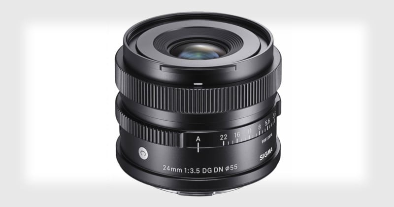

Many photographers favor a real aperture ring like this Sigma. But note that I’ve set mine at “A”. That gives control of aperture to the camera. I prefer that because I often shoot the same scene at several apertures and this allows me to select apertures without moving my eye from the viewfinder.

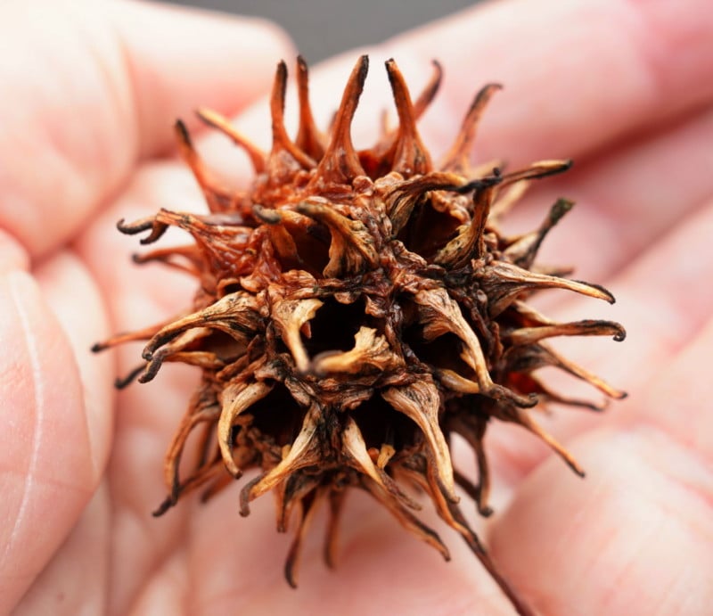

Bird of Paradise
Liquid Amber Burr

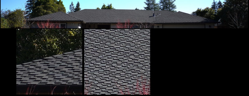

Sharpness
I explained my sharpness testing method in this article. I shoot a sloped roof, then find the largest aperture that gives sharp sides, as shot or with a touch of sharpening. This lens achieved that wide open, which is rare.
Shot at f/4. The left inset is cropped from the left side and the center inset from the center. Click to enlarge.
I’m content with any lens which will do that at least at f/11 because I usually shoot at f/11 or f/16 for depth of field. And on the occasions when I use large apertures, I want soft sides.

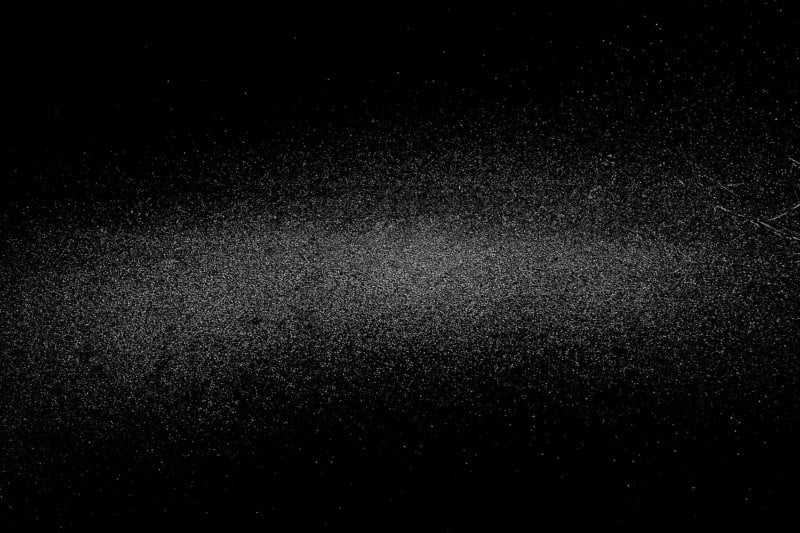

Flat Field
This wide-open test shot demonstrates the flat field. The shot is made by photographing pavement at an oblique angle, then processing the image with an editor function that replaces sharply focused edges with white marks. The pattern of white marks is essentially straight from left to right, indicating a flat field.
Flat field
Field curvature doesn’t bother me because I usually want depth of focus and use small apertures where field curvature disappears. And if I’m using larger apertures, that is to isolate the center of the shot and I want blur off-center.

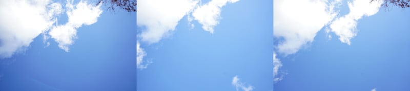

Vignetting
Vignetting at large apertures is a fact of life with wide-angle lenses. When I made these test shots I was puzzled at how little vignetting I could see. How did Sigma do that? They seem to defy the laws of physics.
Photos shot at f/4 (left), f/5.6 (center), and f/8 (right). Click to enlarge.
