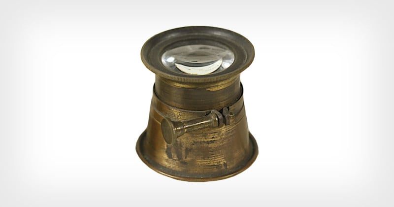

From 1872 book ‘Ferrotypes And How To Make Them’

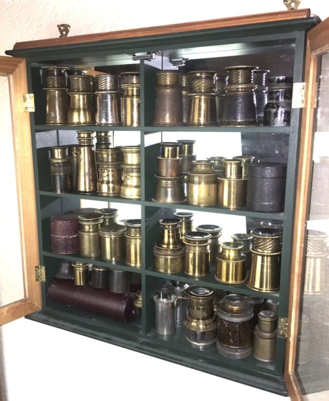

During my first very brief visit to Will’s, I noticed a display cabinet on his wall, which was filled with beautiful little brass gems. At that point, I only had one loupe, acquired in early 2013 from the estate of late Ernst Purdum, who was famous in photo circles for his extensive knowledge of photographic shutters and their history and mechanical development. After his passing, Mr. Purdum’s massive estate ended up in a second-hand retail shop. It was from there that I picked up my first loupe by Taylor Taylor & Hobson loupe.
My main interest has always been in producing images, and knowledge of equipment needed to fulfill particular results is therefore essential but not central; other than admiring its minty finish, didn’t think much of my first little loupe, until my eyes caught sight of that cabinet at Will’s place. When I got home, I searched the web to see what was available on this topic, but my inquest came up woefully short. This lack of information acted to further strengthen my resolve to learn as much as possible, and to share my findings with the world.
Through the years, I visited Will’s place a number of times and purchased or traded for more than a few choice pieces from that cabinet. Sadly, Will passed away on April 8th of this year. I was thinking of waiting to make this post until I reach 10 years of collecting, but decided to rather do so now in memory of Will Dunniway, may he rest in peace.
Will Dunniway collection as seen years ago

Just what is a ground glass focusing loupe, and how is it different from other similar objects? By definition, ground glass focusing loupes are made specifically to aid photographers with bringing the image upon their large format camera ground glass to the critical focus point. To ease this crucial task, photographers at times use a countless number of DIY magnifiers and gadgets, but nothing beats a well-made loupe designed for that exact job.
These loupes should be able to focus sharply at a distance of about 2mm from the bottom edge. A ground glass focusing loupe also has a completely opaque body, which blocks stray light and brightens the image. Their magnifying power varies from around 4x to 8x and even 10x, though most seem to be at about 6x.
Since the ground side of the glass is perfectly flat, most makers went through the trouble of making sure their loupes have a relatively flat field of focus, something that isn’t as crucial in botanical magnifiers for example.
