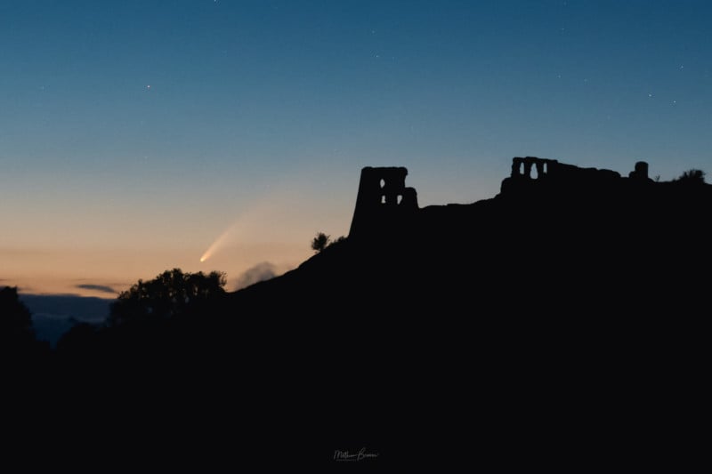

200mm
Dryslwyn Castle, Wales. Nikon D850, Tamron 70-200mm f/2.8, 200mm – f/2.8 – 2 sec – ISO 1600. Single shot; cropped.
On a full-frame camera, you will only be able to shoot for 2 seconds before star trailing happens. This means you’d need a wide aperture and a high ISO for a well-exposed shot

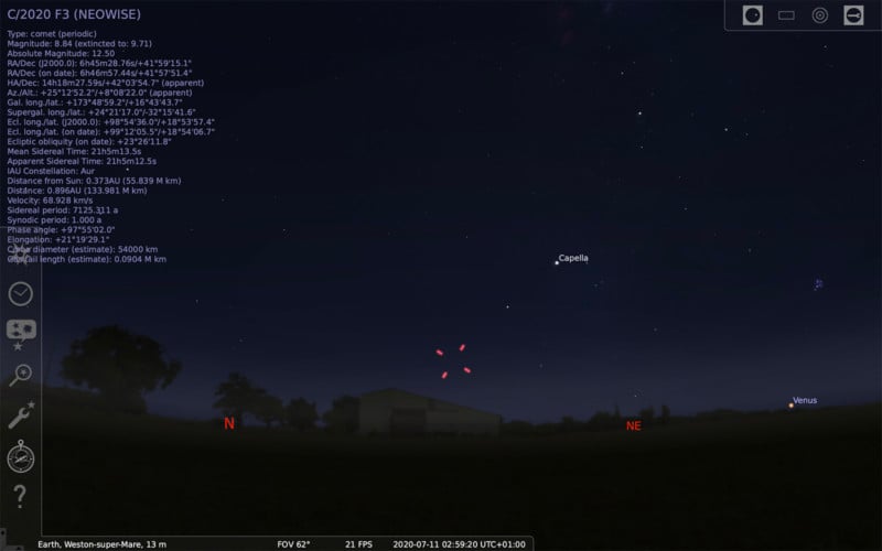

Stellarium
Stellarium is a free, open-source planetarium for your computer, there’s also a web version. You can input your location and Stellarium can show you how the sky will look at any time. Click on NEOWISE and Stellarium will show you the azimuth (direction) and altitude for any given time.

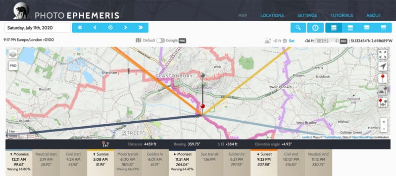

The Photographer’s Ephemeris
The Photographer’s Ephemeris is an extraordinary planning tool available as a paid iOS and Android app, and free to use on the web – registration is required. Using this tool you can plot your viewing location, an object you want to shoot, and TPE will tell you the direction and altitude. Combine this with Stellarium to work out where NEOWISE is in the sky, and how this will work with the object you want to shoot.

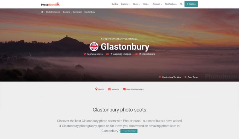

PhotoHound
Finally, PhotoHound is a handy tool for finding notable photo locations around the world – and I’m not just saying this because I happen to be one of its co-founders! The web version is free to use – registration is required. Look for places of interest and see if these can be combined with NEOWISE to create a compelling image. (And when you do, you’re welcome to add it to the PhotoHound map.)

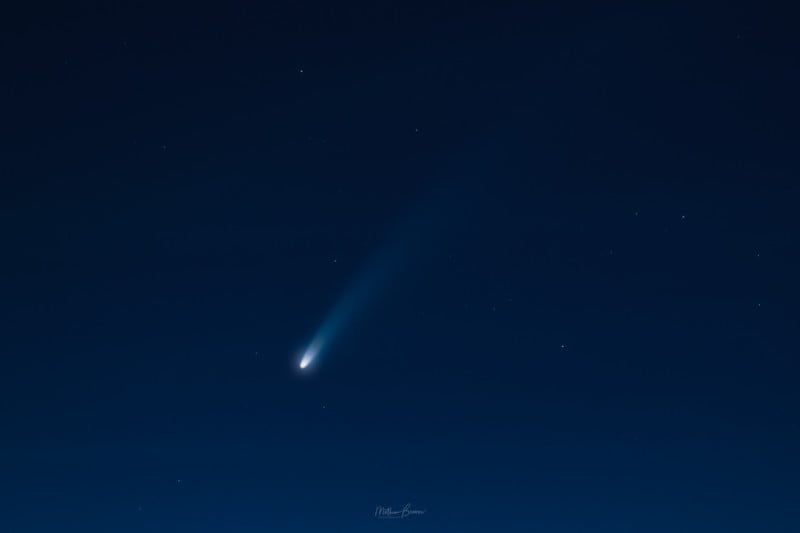

Isolate the comet
Nikon D850, Sigma 150-600mm, 300mm – f/5 – 1 sec – ISO 2000. 9 x frames stacked using Starry Landscape Stacker; cropped.
This is the trickiest to achieve as you’ll need a good zoom, and the longer your focal length, the shorter your exposure must be to avoid star trailing.
If you want to create longer exposures than this, you’ll need to use a star tracker. This is quite an advanced technique, well beyond the realm of this beginner’s guide! An easier alternative is to capture multiple short exposures at a high ISO, and stack these frames using software like Sequator or Starry Landscape Stacker to reduce noise.

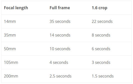

The 500 Rule
If you’re not sure how long to expose for, you need to check something called the 500 Rule which is used to calculate the longest exposure time you can achieve before the stars become blurry.
The formula is as follows:
500 ÷ (Crop factor x Focal length) = Shutter speed
That can be a bit difficult to get your head around when you’re shooting the stars at 2 in the morning, so here’s a table featuring common focal lengths.
