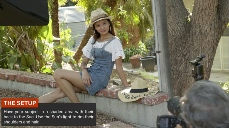

So the way I generally do this is:
First off, I set her up so that she has the sun coming from behind. I always like the sun from behind because it gives her a nice rim light on her hat and on her shoulders. But I’m going to keep her in the shade pretty much.
It’s just that little bit of rim light coming through is giving us a few highlights on her hair, on her back, and on her hat. If I’m out in direct sun, I’ll throw up a translucent to make it look like she’s in the shade or just a plain reflector to get her out of the sun.
