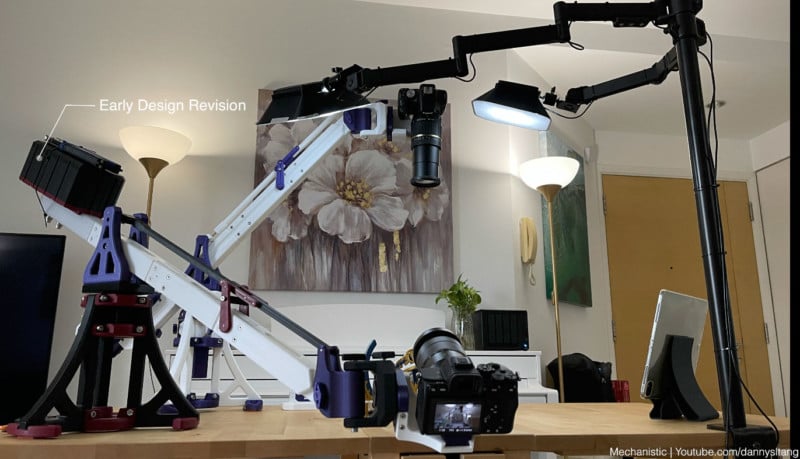

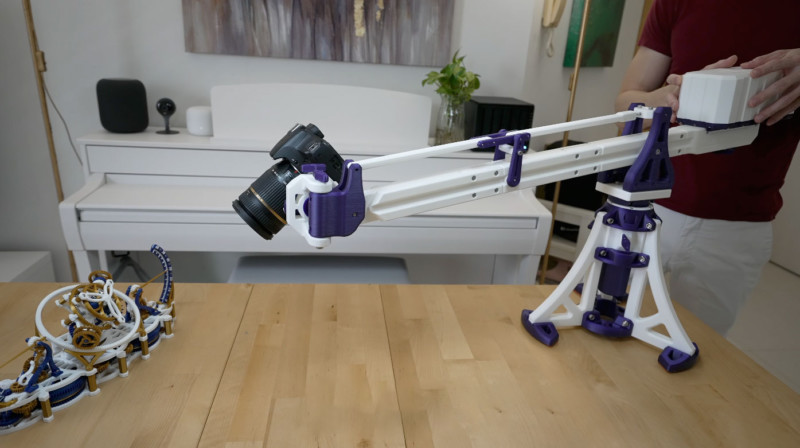

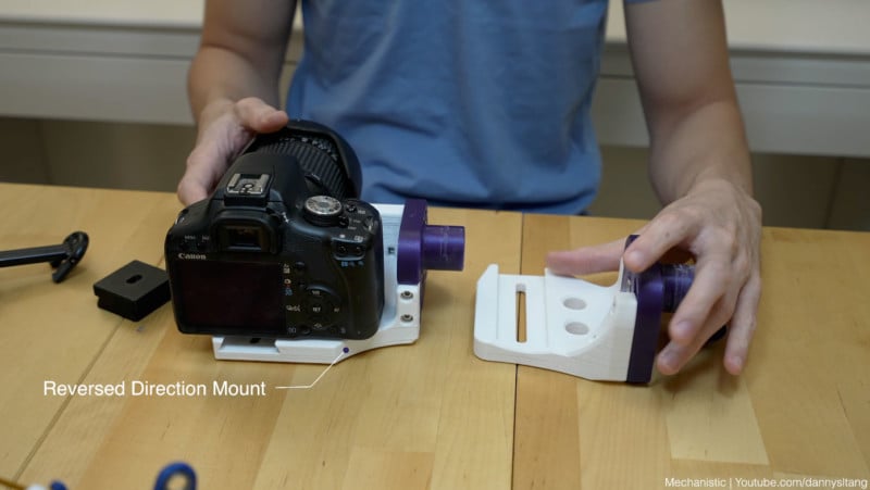

The crane’s main arm can pivot along two axes around the base and uses a parallel bar design to keep the camera orientation constant through its vertical range of motion. It has an adjustable counterweight on the opposite end to offset the weight of whatever camera system you attach as well. The mount for the camera provides an additional three degrees of movement and can even be used to adapt a smartphone holder for casual or on-the-fly needs. According to Tang, every axis of rotation can be locked using thumbscrews to ensure each component is secure.
Tang says the system can hold a maximum weight of about two kilograms (about 4.4 pounds) based on his stress testing over a period of three months, meaning it is highly suitable for most new mirrorless systems and DSLR systems with appropriate lenses for the situation. The entire video above, for example, was recorded with the Micro Jib using a Sony Alpha 7S III with a 16-35mm f/4 lens, which proves the system is incredibly functional and still has a variety of unexplored use cases.
