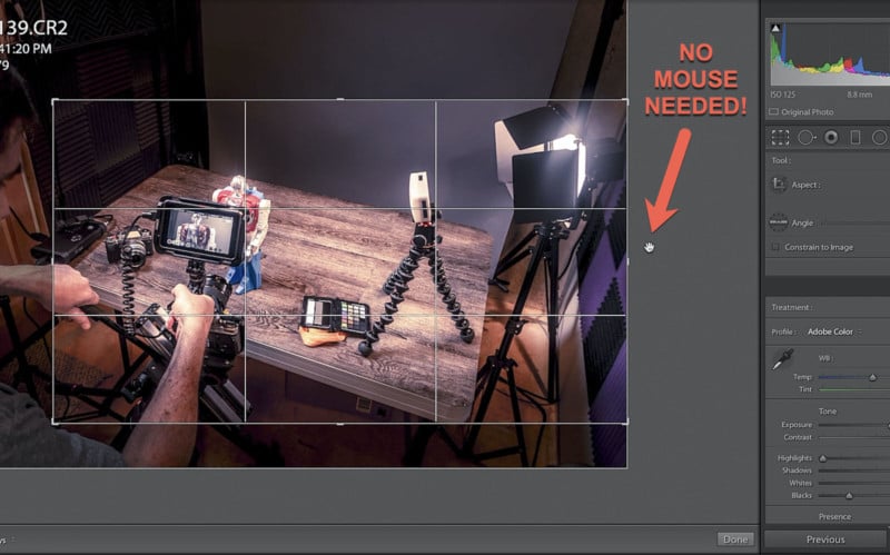

1. R: Open Crop
The R key will jump you right into the crop tool. This is a lot faster than having to take the mouse and move it up and click on the little lined area to select the crop tool. If you are not doing so already, start getting into the habit of using R for the crop tool.

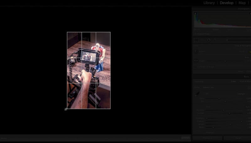

2. X: Rotate Crop Aspect
This one is my favorite. It will allow you to quickly switch from portrait to landscape in the crop mode. I find myself switching back and forth all the time: will the photo look better in portrait or will it look better in landscape? The eternal question. So, a simple toggle of the ‘X’ key switches the crop tool back and forth from landscape to portrait based on the dimensions of the photo.
Keep in mind that for this key to work you already need to see the crop tool in the Develop module. If you press X and you’re not in the crop tool, it will then act as a toggle to set your photo as rejected. So, make sure you only use ‘X’ after you start your cropping process.
3. L: Show Only Cropped Area
I know a number of you use the ‘L’ key to turn off the lights in Lightroom so that you can view your photo without any distraction. But did you know that the ‘L’ key, when used in the crop mode, will hide everything but the area you are trying to crop? This will allow you to much more easily visualize what your finished crop will look like! Not only that, but you can move the cropping window around and actually see how it looks based on the various parts of your image that you are cropping. How awesome is that?
